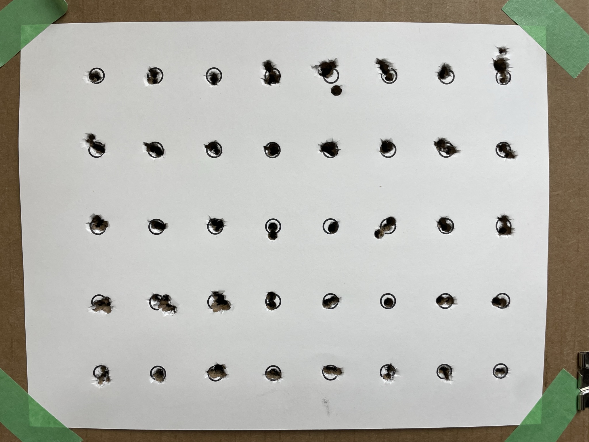

Yes, was a bit anxious waiting on delivery and the mental wheels were spinning waaaaay to much. After I cleaned all the brown gunk out of the barrel, I aired it up and started hurling lead. It was shooting 18s too hot at 960 so I backed the HS off to around 895 with 16s. It’s a tack driver for sure. Can’t wait to stretch its legs when it warms up a bit. It’s snowing, windy and cold today. Shot outside for a few minutes before I lost feeling in my fingers. Below was my sight in @30Y using 18s, 16s, Hades, CPHP, RWS super points (yuk) and RWS wad cutters, yuk too.
Next, I’ve got to work on the trigger. It’s pretty gritty feeling.
This is unusual in Veteran. I would clean and check the adjustment before doing any work on it. And yes, it sounds like your tune is a little hot. You might notice it being even quieter when the reg is backed off a little and you have a better balance. They are really great rifles.
