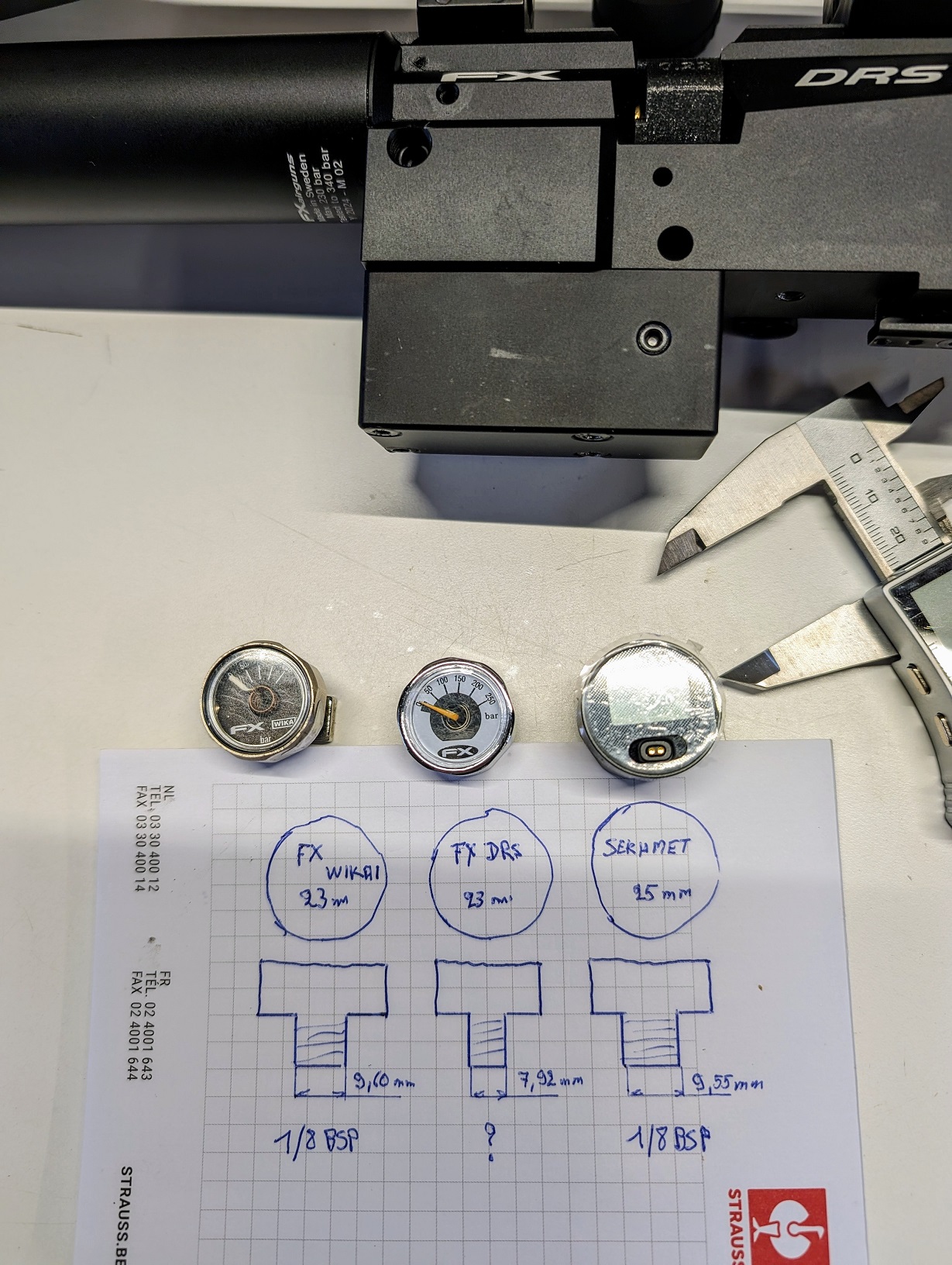

Today I recieved my Sekhmet 25mm gauge (1/8 BSP)

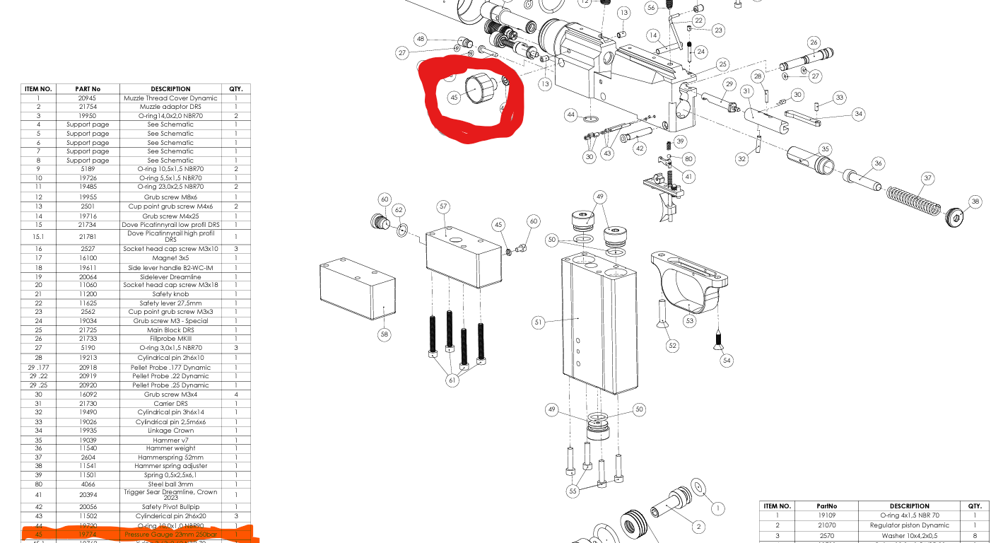

This will not fit, the original FX gauge has a smaller diameter opening for the meter. Just looked at the exploded view of the DRS... nothing to find 'which' thread that original FX gauge has! Typical M.F. FX, grrrr

Try a 23mm Huma gauge.

It's the thread, I suppose the gauge wil fit in the opening stock.
I can understand that you asumed that it would be 1/8BSP
Strange that it is not. Are you sure that the Sekmet is 1/8BSP. Because they are available in multiple treads.
Or is the tread M8X1 in the FX?
Double check it with something else that is surely 1/8BSP
According to HuMa, all those meters are 1/8 at FX. It now turns out that they have made a change in thread. Even FX on You Tube asks if I have the right wire in the sekhmet because according to them they haven't changed anything. He himself (FX) does not say 'which' thread. All very strange!
See the photo, it doesn't lie!
I suppose it is M8x1???
And sorry for the real FX freaks, I must never say M.F. but I was a little dissapointed because after having 8 FX airguns I know that the thread is always 1/8. Even on the FX YT channel they say they have nothing changed. Maybe they don't know by themself???
Reactions: Nutcracker
Then it will proberbly be M8X1, just like the Snowpeak airguns have on there pcp gauges.
It also is not a Wika gauge, it looks like a cheap China part actually.
It can be it is a Chinese knock-off the left one on the picture. It came with a airgun I bought second hand a few years ago. µ
But I was wondering why FX does not quite stick to their own design, even they tell on YT they did not change anything regarding the gauge?

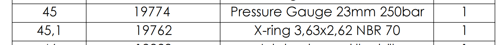

So glad to see everyone engaging in a lively discussion about the pressure gauge on air rifles. In the past, this was not a topic that received much attention. I want to share some experience with the thread: according to the exploded diagram file, 45.1 is an X-ring, with a diameter suitable for a 1/8bspp thread seal. This is consistent with the conventional seal used by FX in the past, as well as the free seal component provided by Sekhmet.
However, thanks to thommy's sharing, the DRS is using an O-ring which does not match the exploded diagram. Additionally, the actual thread size measured by thommy is indeed M8.
Although it is unclear why FX suddenly switched from 1/8BSPP threads to M8 threads across their entire range, perhaps it was due to space constraints. Nonetheless, Sekhmet launched a new 25mm gauge with an M8 thread last month. Judging by the dimensions of the stock, there is sufficient space to accommodate a 25mm gauge. So if anyone wanna give it a try, feel free to contact me for a discount code. And for thommy, we're happy to arrange an exchange for you, pls PM me about your order information.

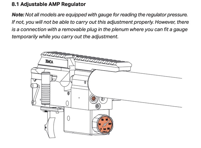

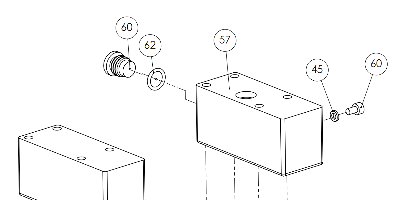

Just curious, is the plug in the plenum also M8X1 or is it 1/8BSPP? The FX manual says you need to attach a gauge to that port to be able to tune the regulator, yet they failed to provide any specification as to what threads are needed on the gauge.
That one is 1/8 bspp, check the above file #60
Pretend I'm an FX staff 😬 LOL
1:8 bspp.png
