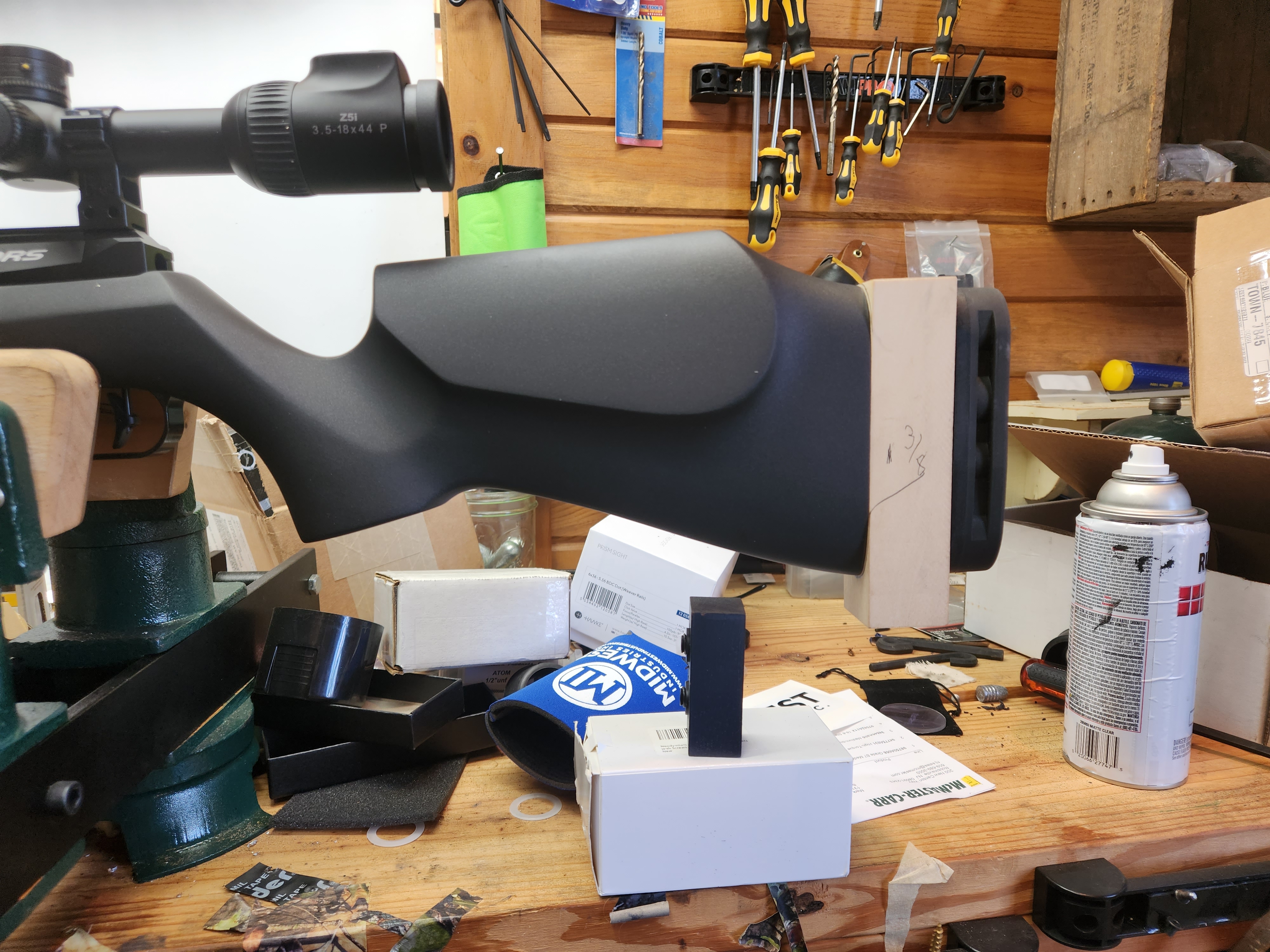

I got mine yesterday from Ohio Airguns LLC. It was so windy that it knocked over my tripod with the chronograph & same today. Since it was too windy to shoot, I decided to fit the stock to my big head and long arms. I first made a 1-inch spacer, which was still too short—now working on this 1 3/8 inch. Putting my lop around 14 3/4 Perfect. I am getting perfect cheek weld back at the end of the curve , it seems weird, but man, it is comfortable & comes up perfectly when I open my eyes it is there. Using .9 high rings, which are .8 above the top of the 11 mm dovetail. Perfect height for me in this setup.

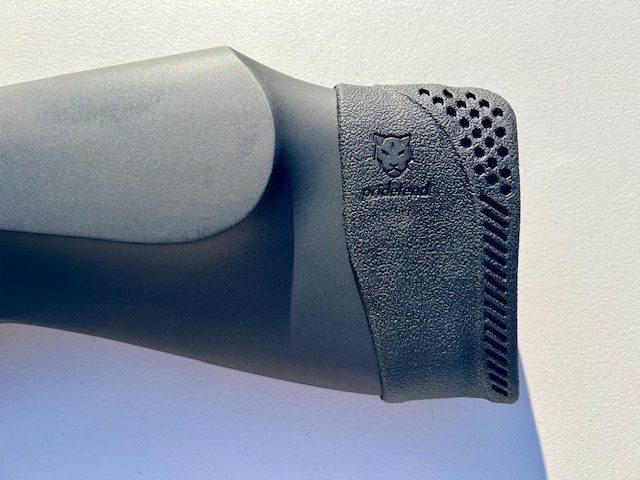

I added one of these rubber butt pads to mine. It added an inch to the LOP which was good for me!
View attachment 455184View attachment 455185
Its a "Kiddy" stock

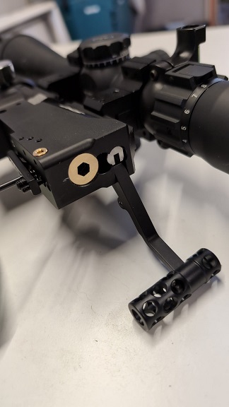

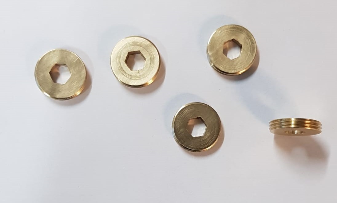

The fact that the hammer spring screw is so loose has made a friend and fellow shooter me a wonderful solution. He turned a screw himself on the lathe that now serves as a counter to the original screw. It is now very easy to adjust the hammer spring without it turning itself afterwards. FX should supply a second screw itself!
Much easier than working with loctite!
