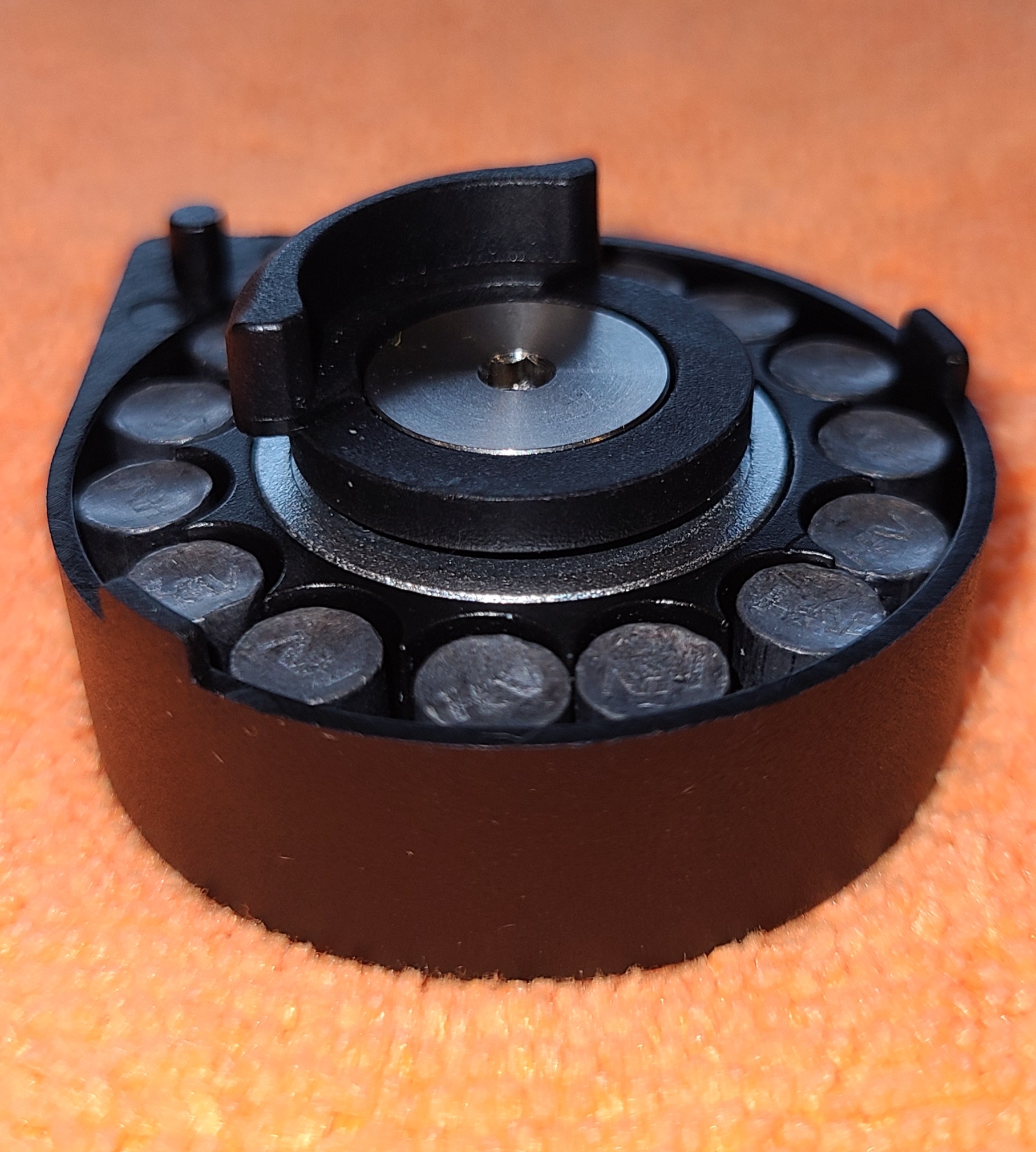

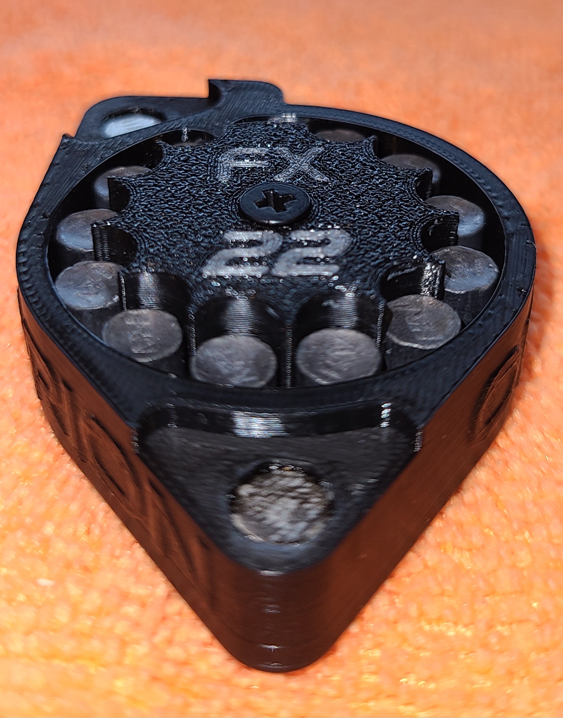

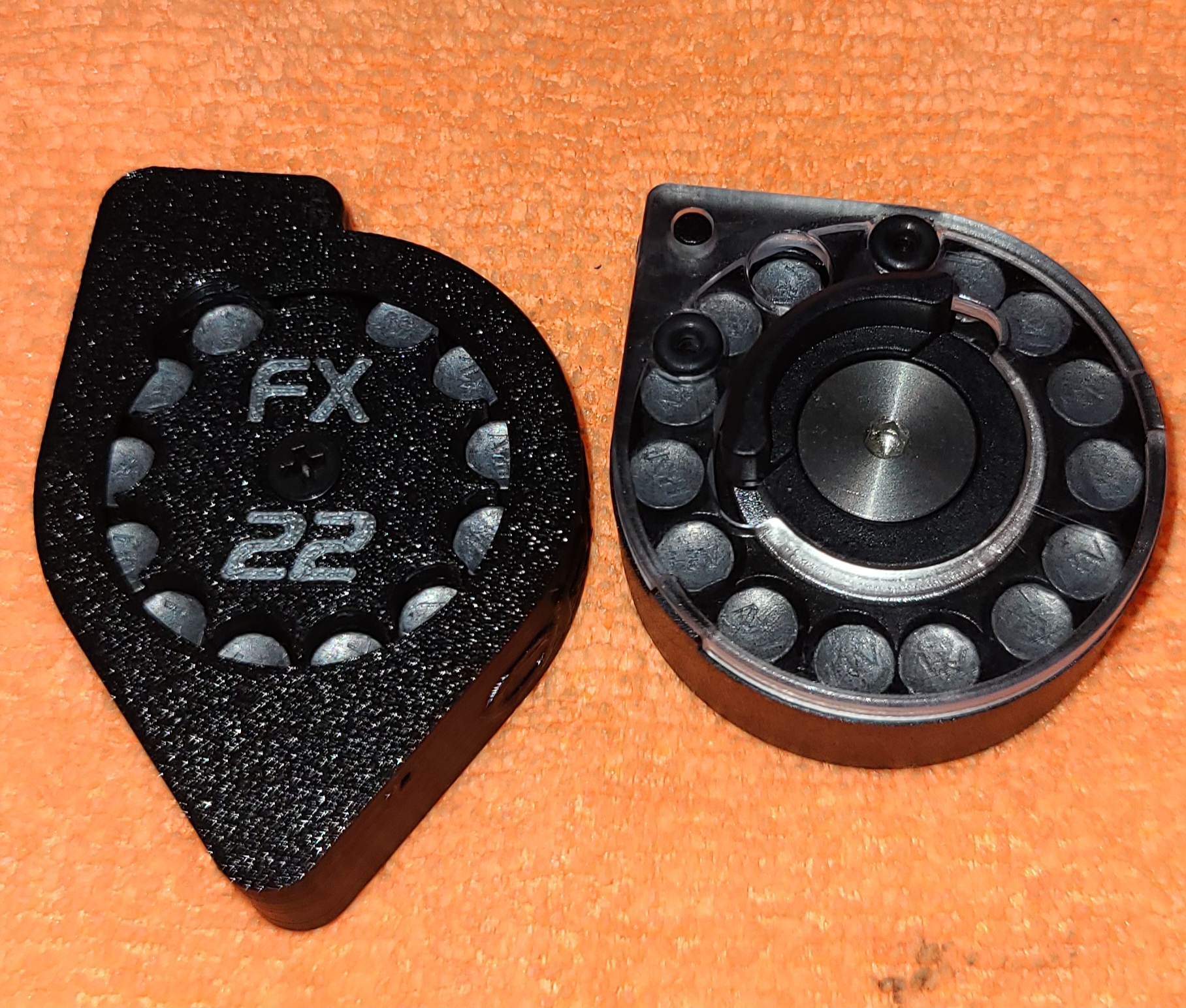

My first thought was someone needs to 3D print a mag winder for these LOL
I wound up drilling a small hole where the nub would have been and cut a piece of wire that I super glued in place. Much better now. I use speed loaders on my magazines so I could use one for this new mag as well. But for hunting just having an extra mag in your pocket would be enough.

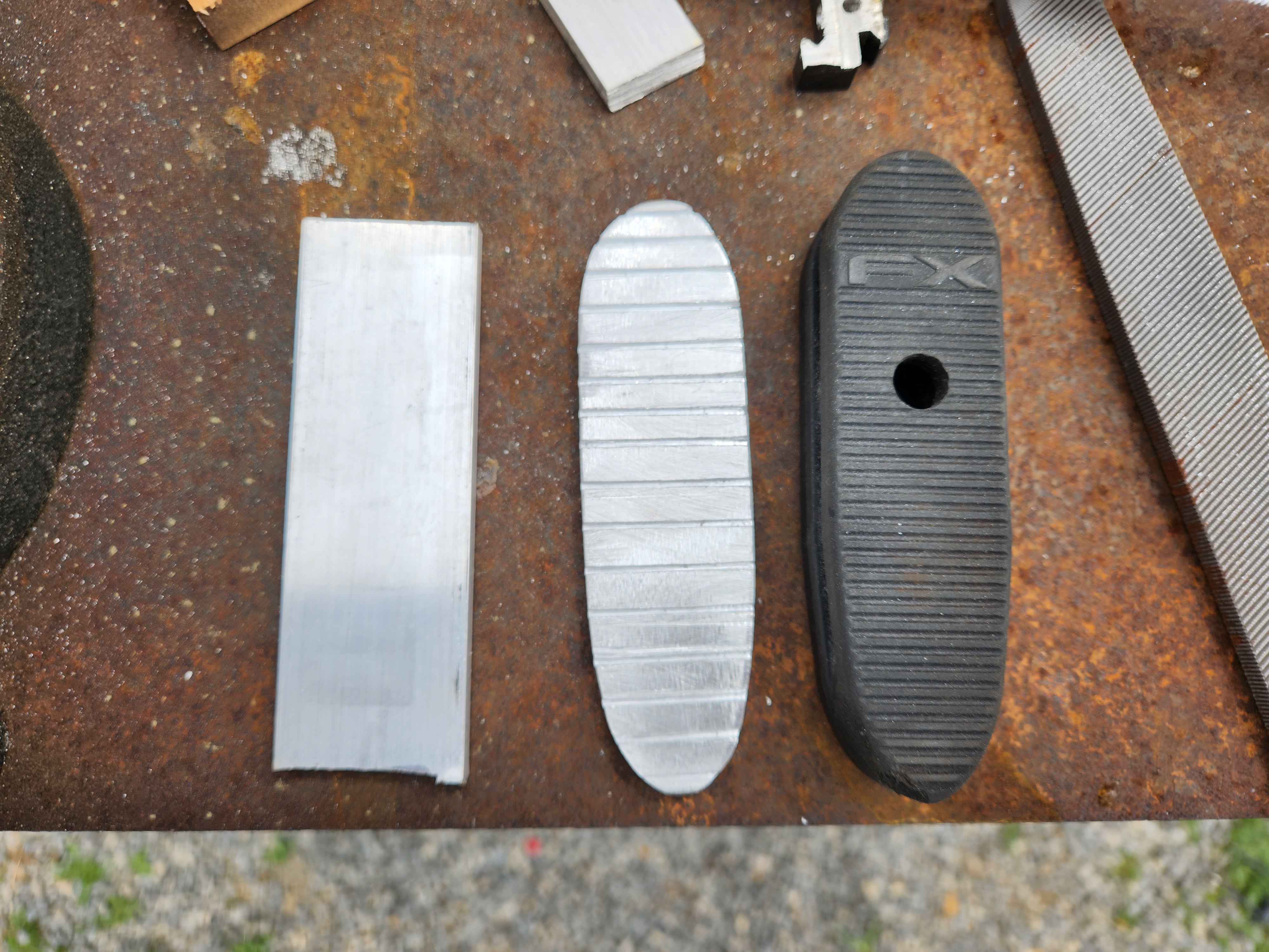

My stock is at the dipper, so I worked on these two things today. I hope the gauge fits in the stock without modification. I should have waited to get the gauge before taking the stock to the dipper. I hope the gauge doesn't leak; it indexed correctly before it was very snug, I knew I could not go another full turn. I will see. They have a few different seals in the box. I just utilized the original. Thought I would make a metal butt plate in place of the rubber one. If it looks right on the rifle. :)

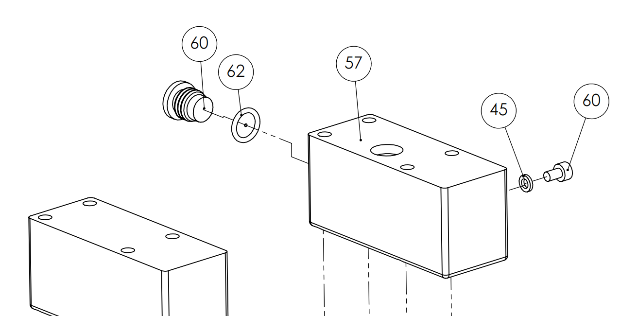

Hi, the front plug is indeed a 1/8 bspp in order to mount the manometer gauge and monitor the regulator pressure for tuning. The second #60 on the side of the plenum is the bleed screw to degass the DRS.
Thanks FX Airguns, can you tell us when the accessories for the DRS will be in the USA ? Slug power kit and the picatinny scope rail are what I am interested in?

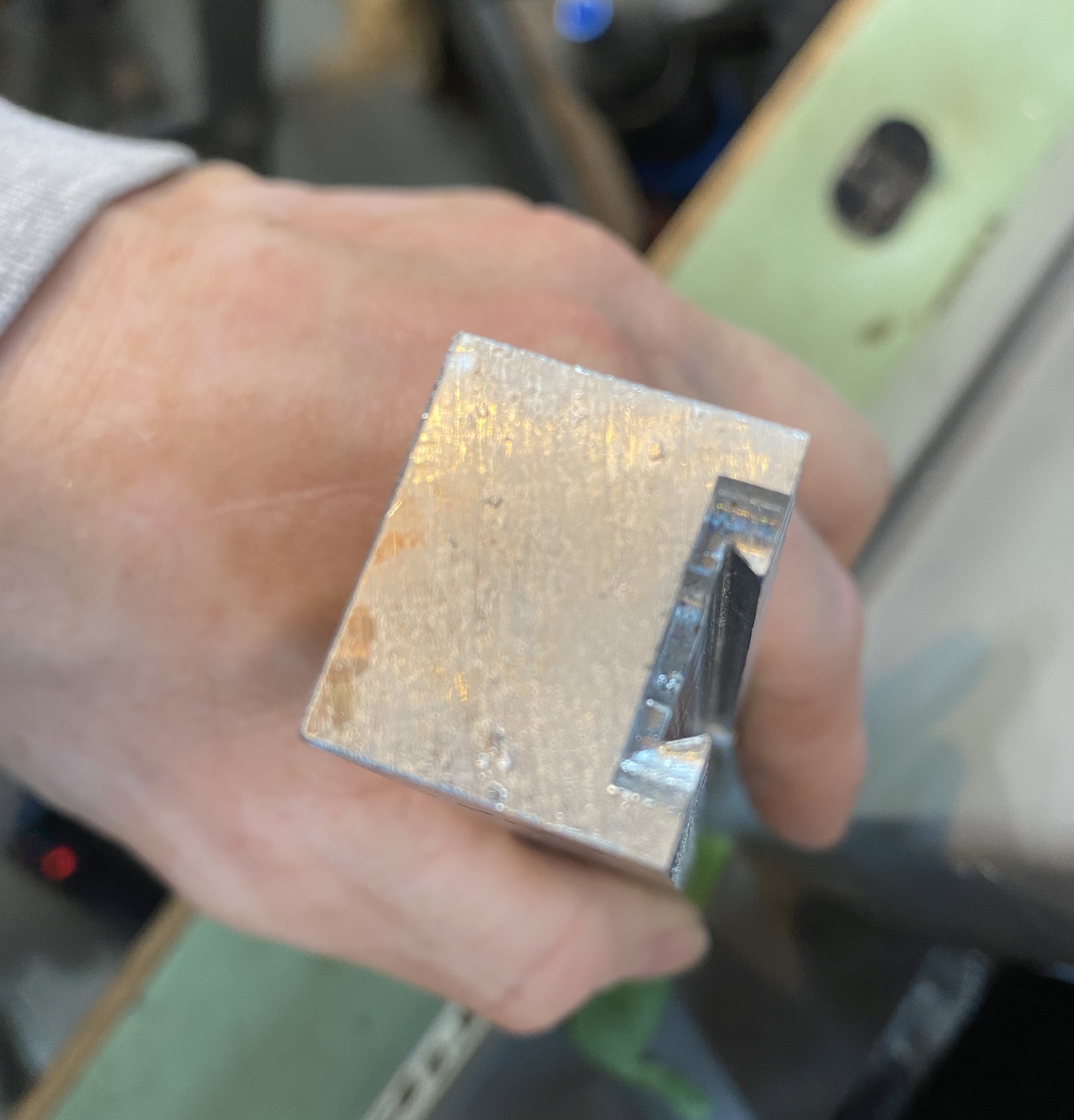

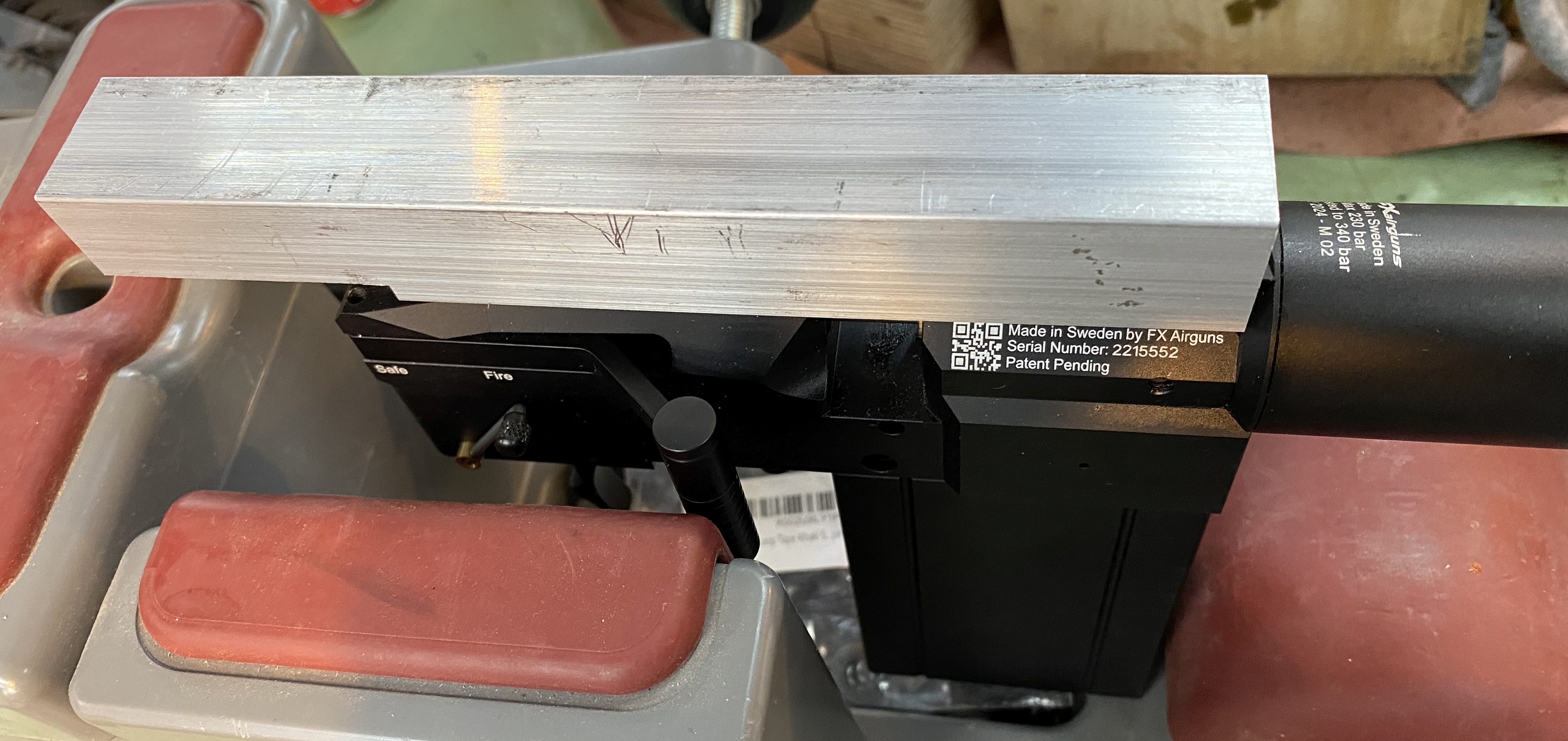

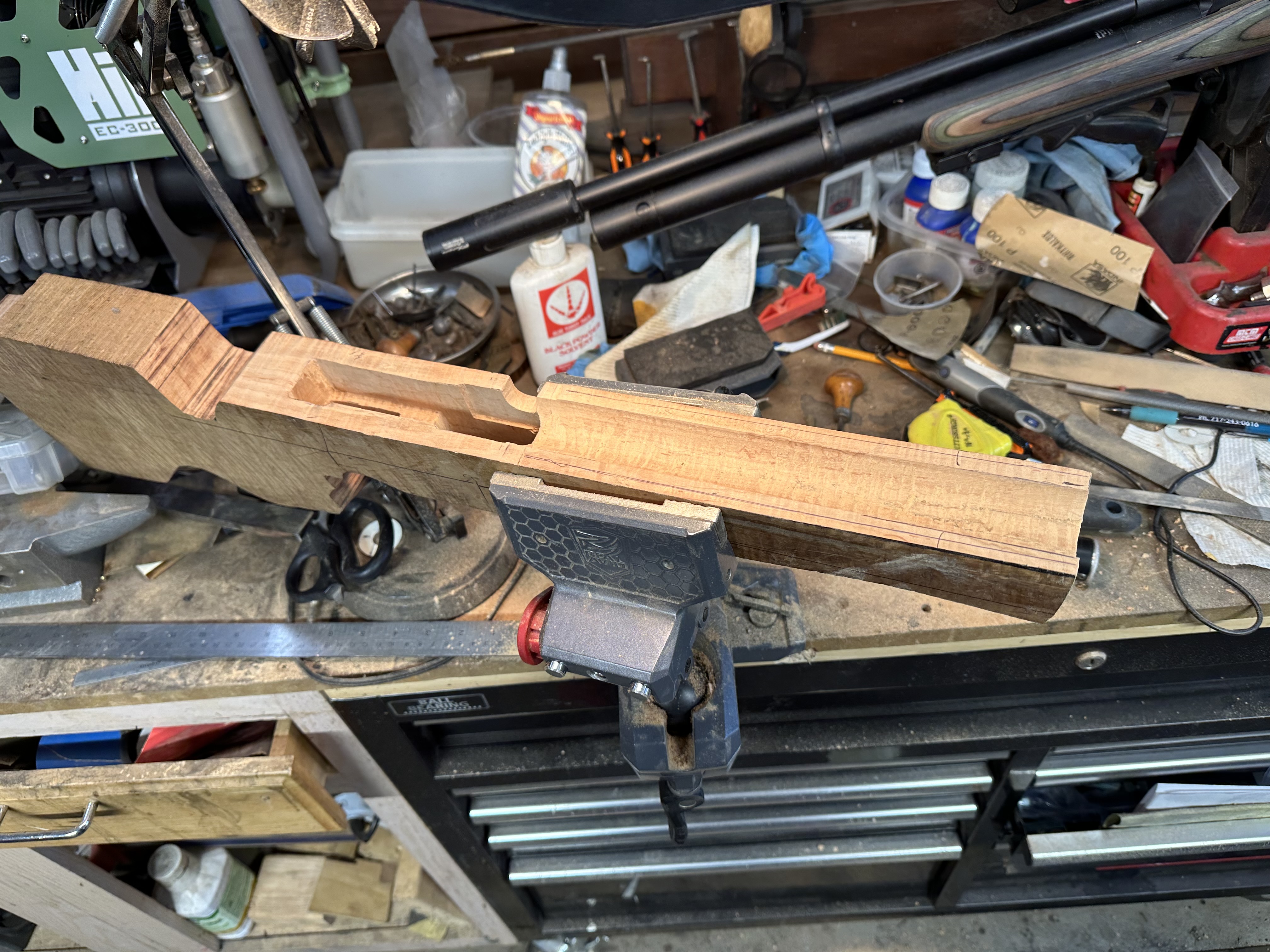

Started cutting the aluminum Picatinny rail. Started out with cutting a short length of the dovetail to dial in the fit before cutting the full length rail material.
Op1 Full length stock with the dovetail and the barrel relieve cut.
Test fitting to the action. Slipped on like a silk glove.

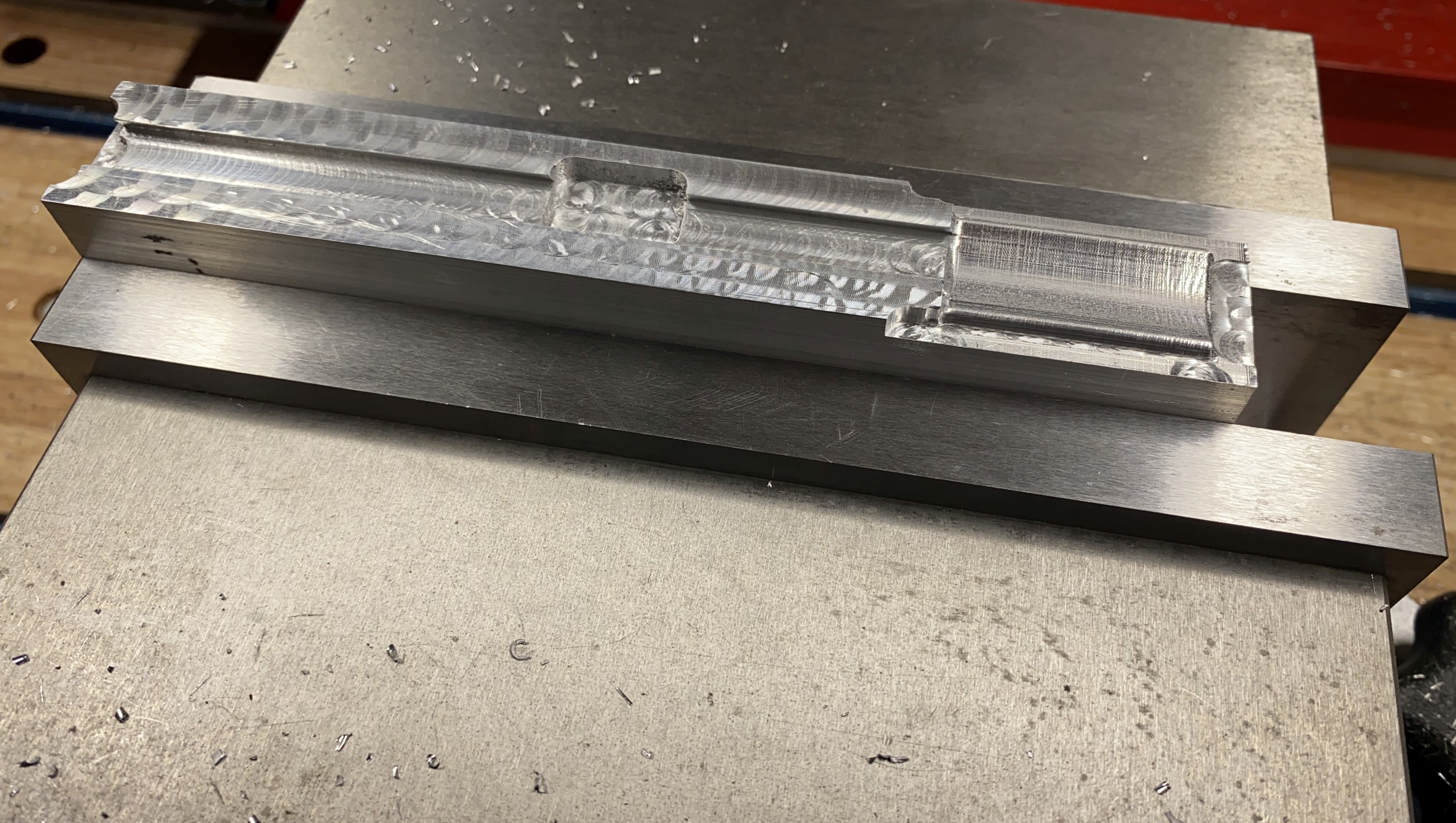

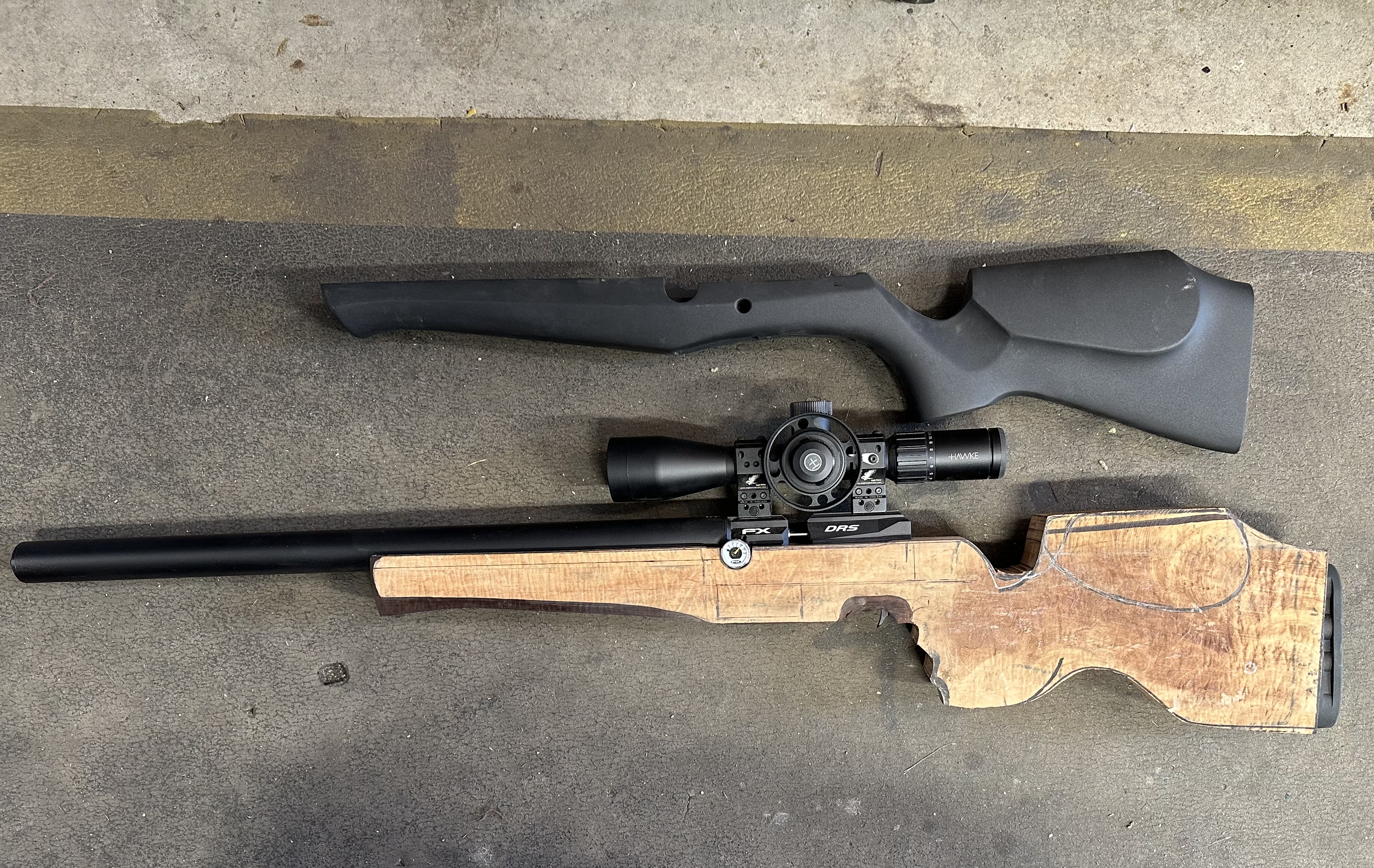

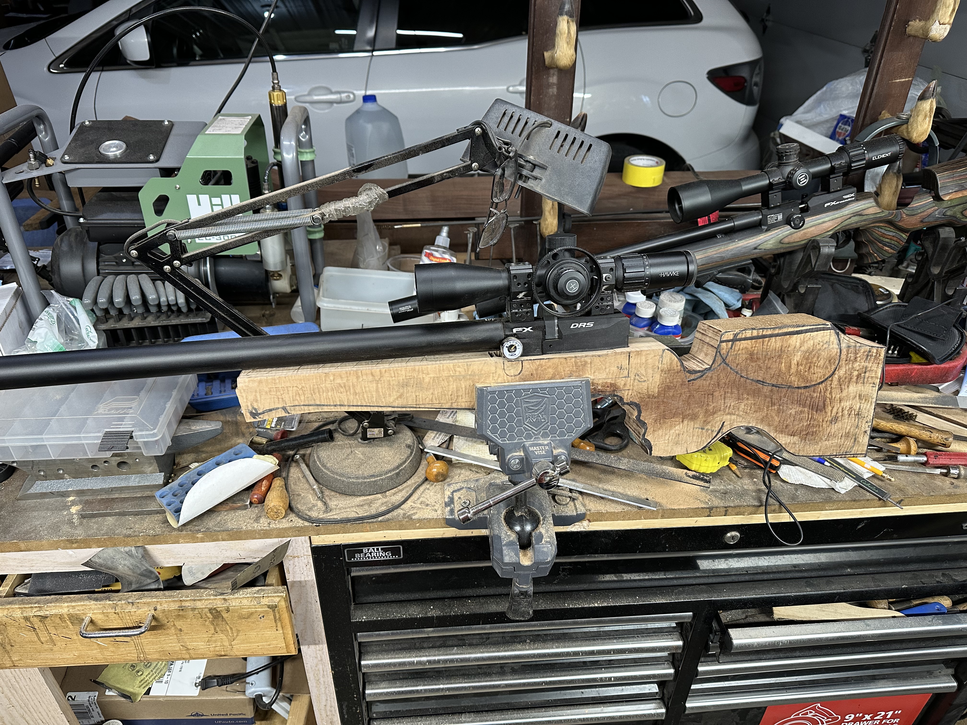

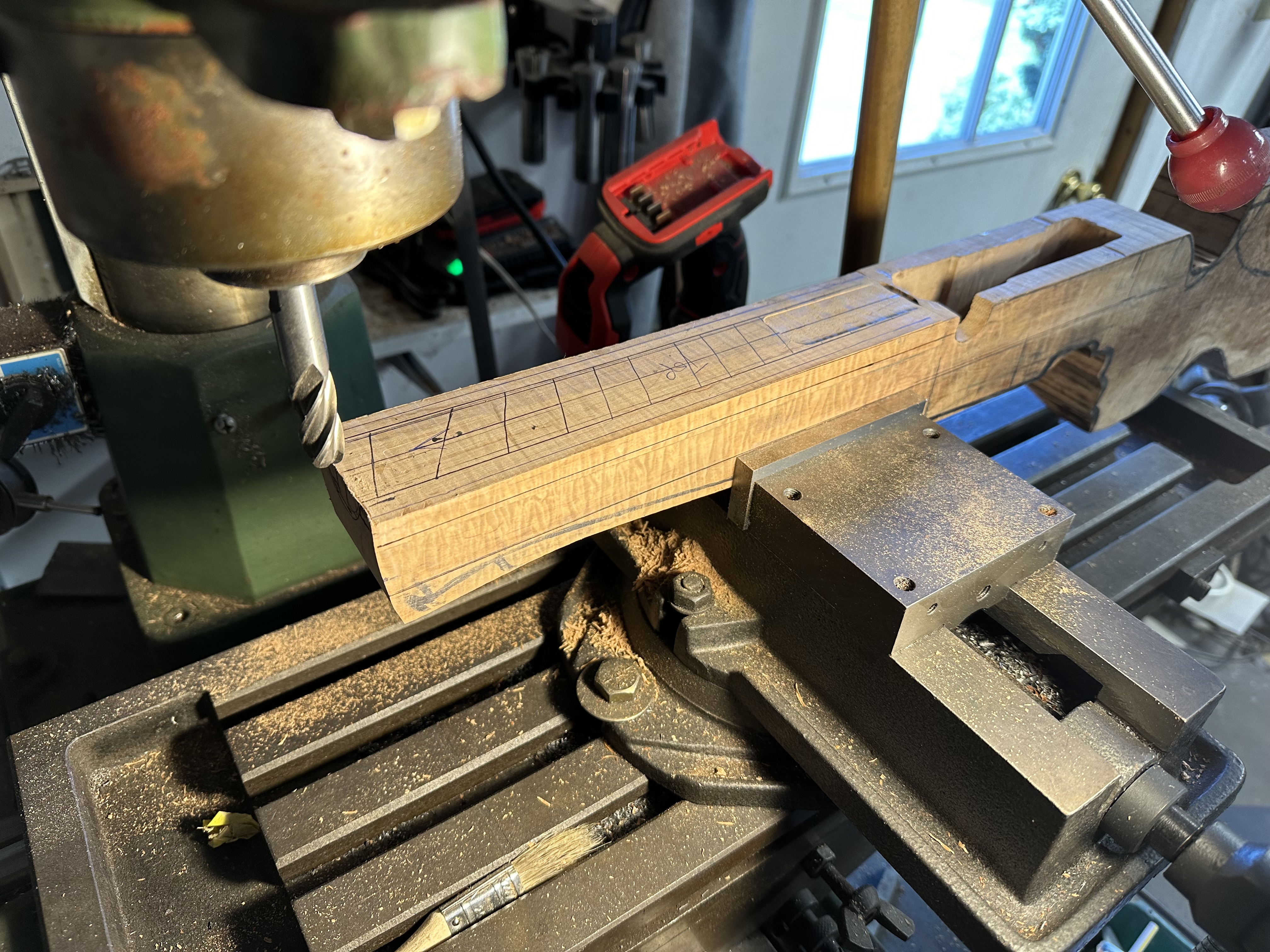

Another day on the stock in letting. Have the barrel and action fully inletted. this is the easiest rifle I have ever inletted. All the lines are straight. Did the whole thing on my vertical mill. . Now to get out the grinder and remove what I don’t want. At least I have the GRS stock in hand for a go by. This piece of maple is soft so not as heavy as hard maple. It weighs 4 pounds 14 ounces versus 1 pound 10 ounces on the FX synthetic stock. I’m estimating taking another pound off the maple stock by the time I’m done. I’m going to experiment with adding weight (lead) in the forearm under the barrel to give it a little more forward weight distribution for off hand shooting. I’m leaving extra wood about 1/4” below the bottom of the plentum in case FX or after market makes a middle size plentum . This way it will look less out of balance. I could have left the bottom solid wood if I were to just use the existing plentum. I’m really liking the look of this DRS with a wood stock. I’m already considering a .177 500mm and stock it with some figured Walnut. I’ll show the finished shaped stock next week. Going to NC tomorrow through the weekend for a Sporting Clays shoot.

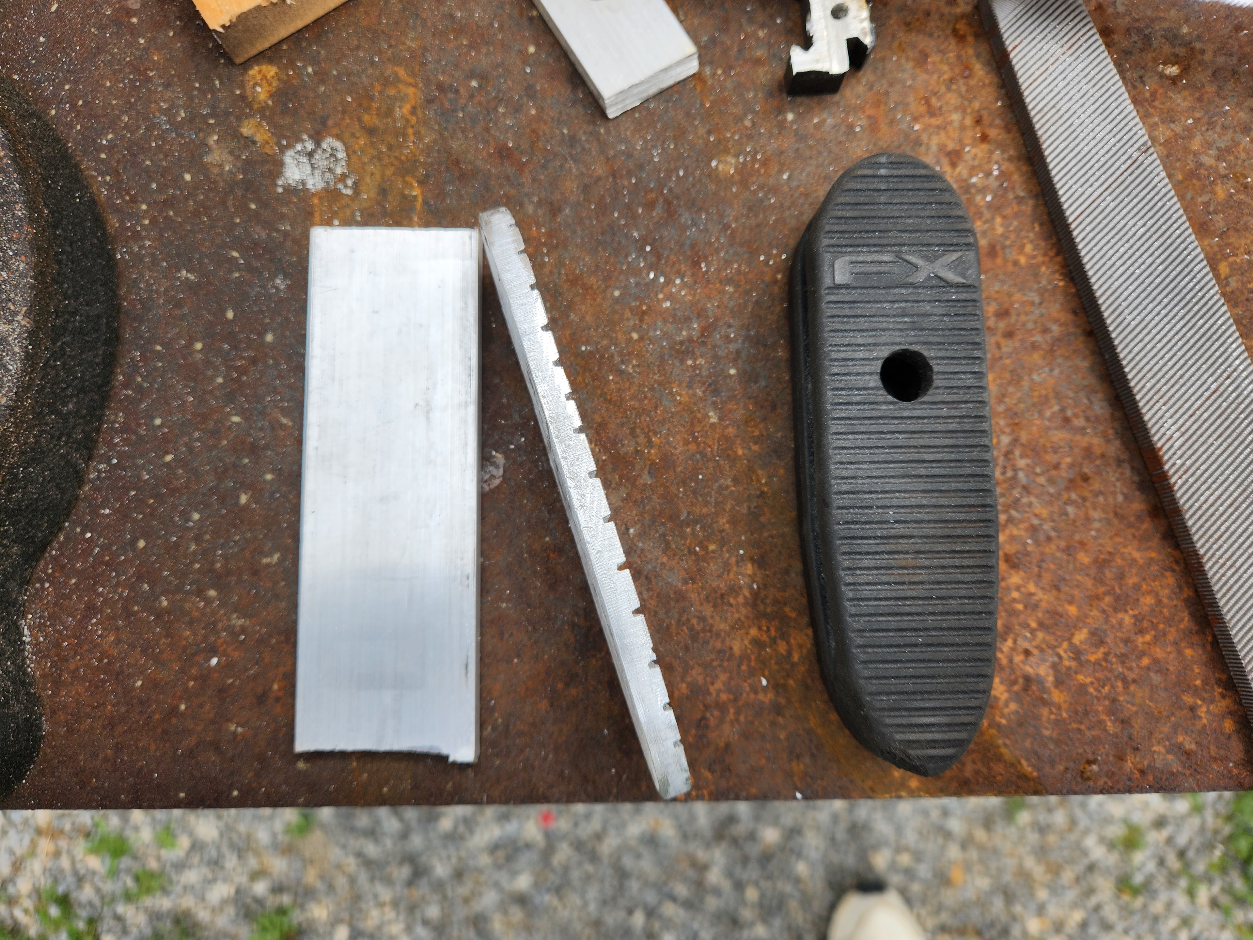

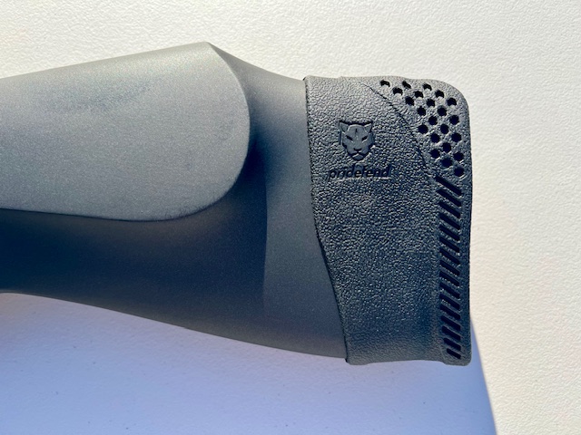

I added one of these rubber butt pads to mine. It added an inch to the LOP which was good for me!
Wow! That looks like it's going to turn out to be amazing! I'm definately interested in following your project and progress! I wish I had the tools, talent and patience to take on a project like this...
