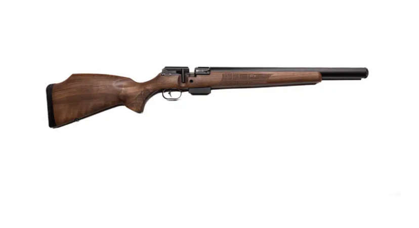

NO FILL PORT!
I noticed that at 4:10 into this video, he shows a still photo of the fancy walnut stock version, with no fill port on the side of the DRS.
I wonder if the photo has been photoshoped, or ???
Fill port appears to be on the other side just in front of the side lever in pics of the walnut version.

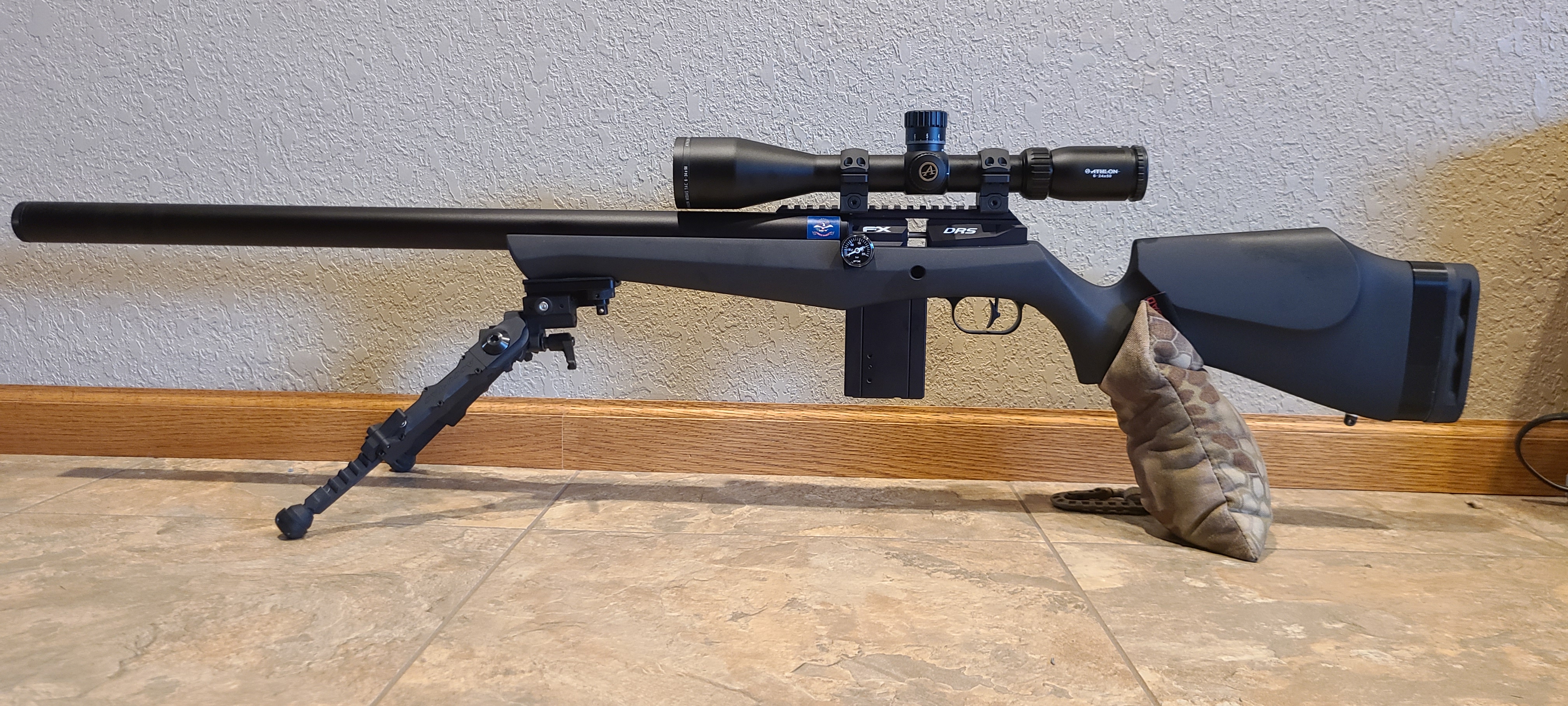

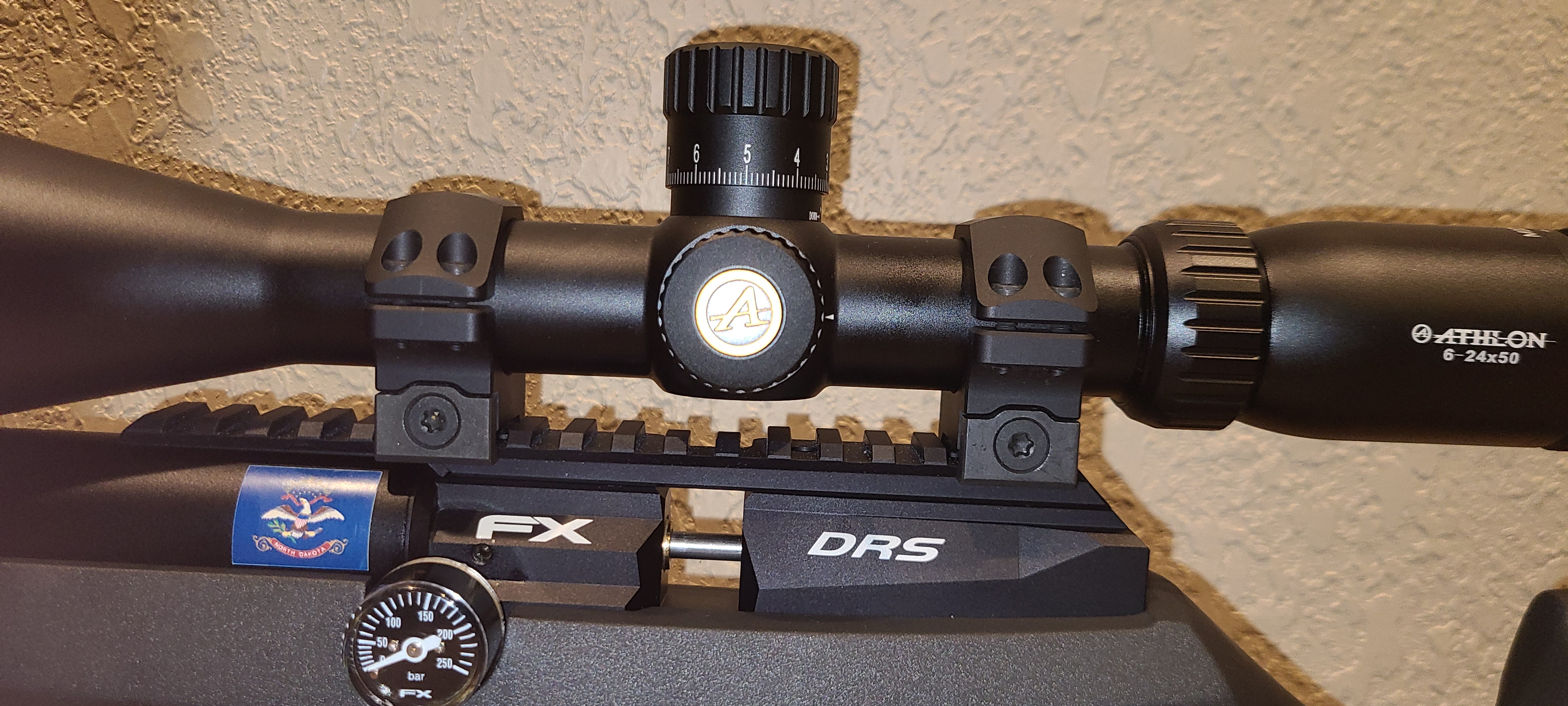

I received my picatinny rail for my DRS 22 700 and got it installed yesterday.

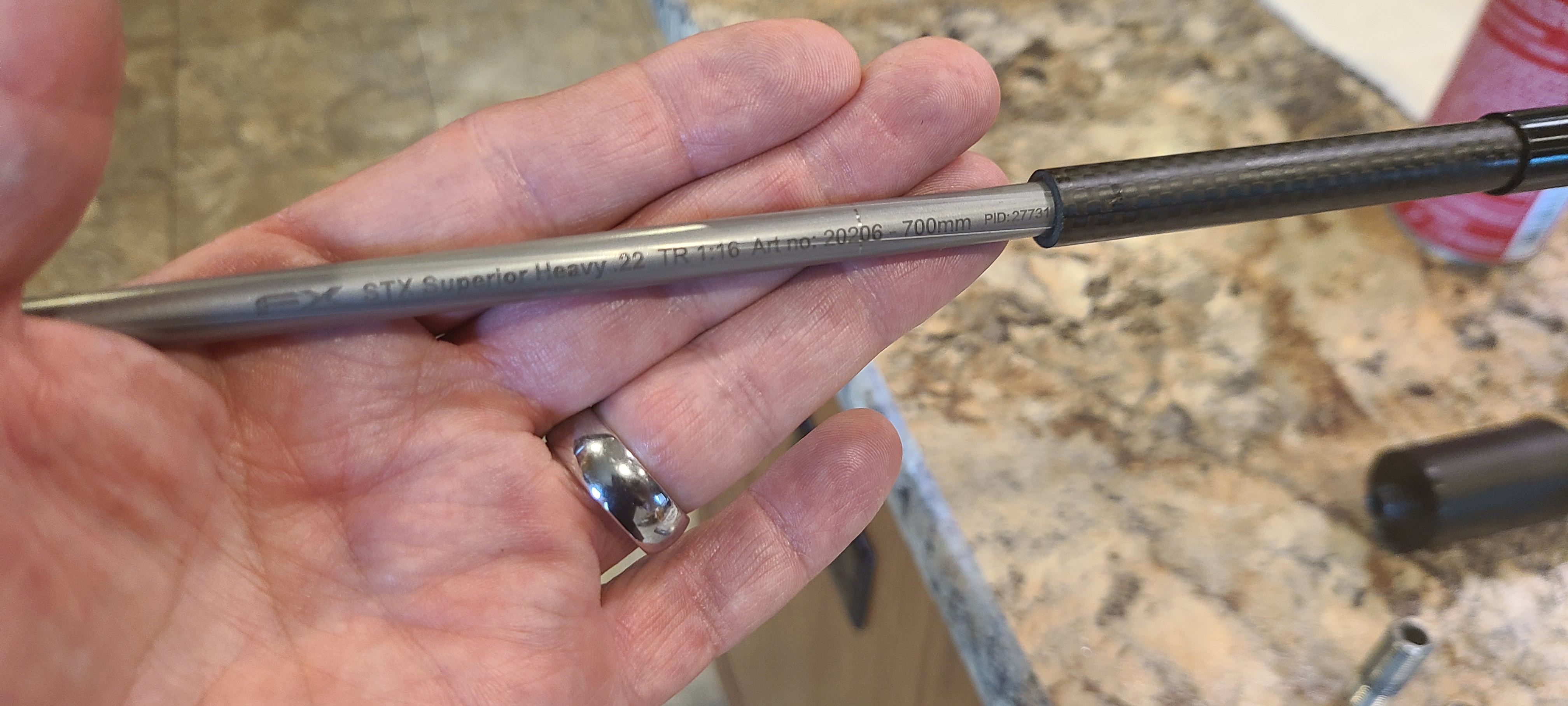

I also installed a carbon fiber sleeve.

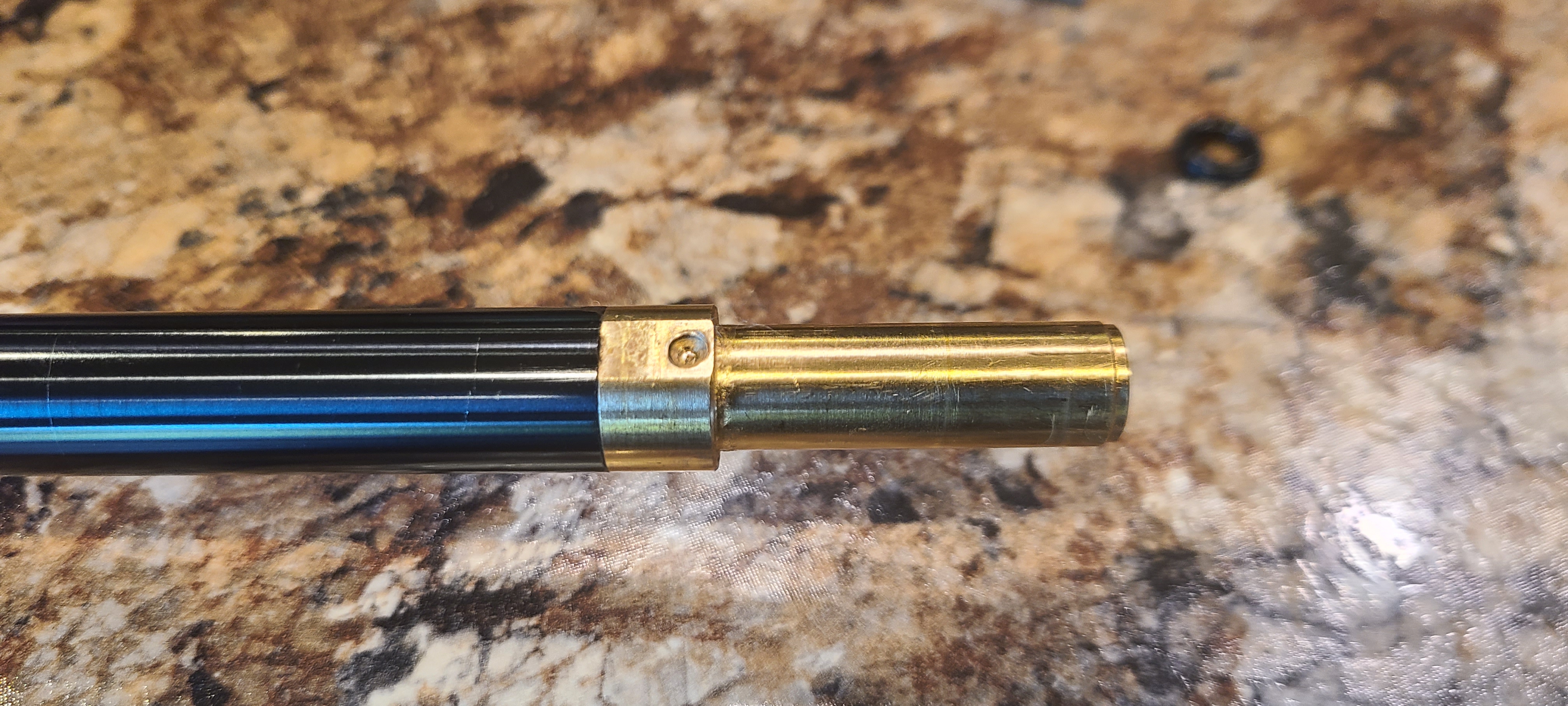

I was curious to see how the barrel was held into the receiver and what the transfer port looked like.

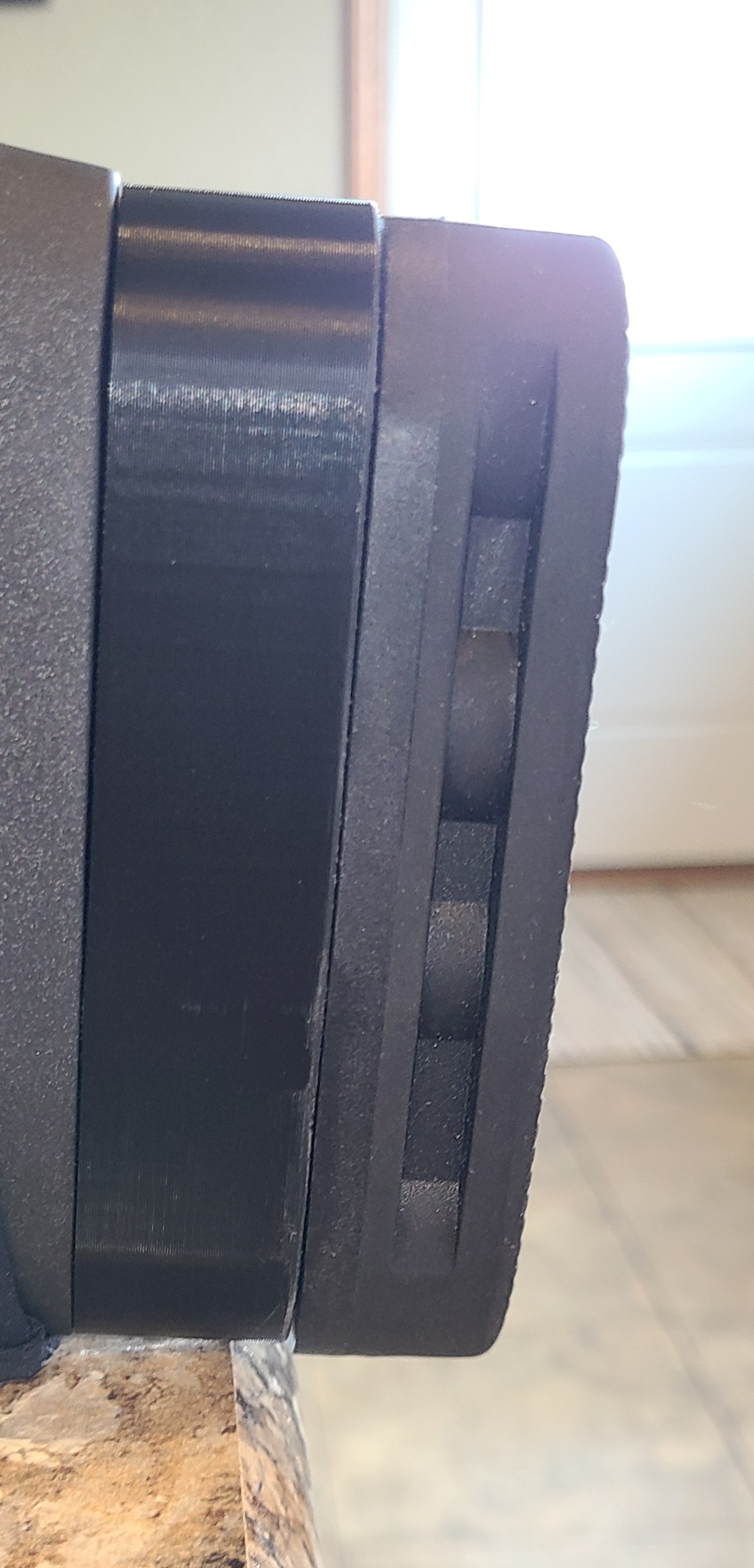

I had a friend of mine 3-D print a buttpad spacer.
I'm shooting H&N Heavy 34gr @960fps.
With the reg set at 155bar I get 24 shots on a 230 bar fill.

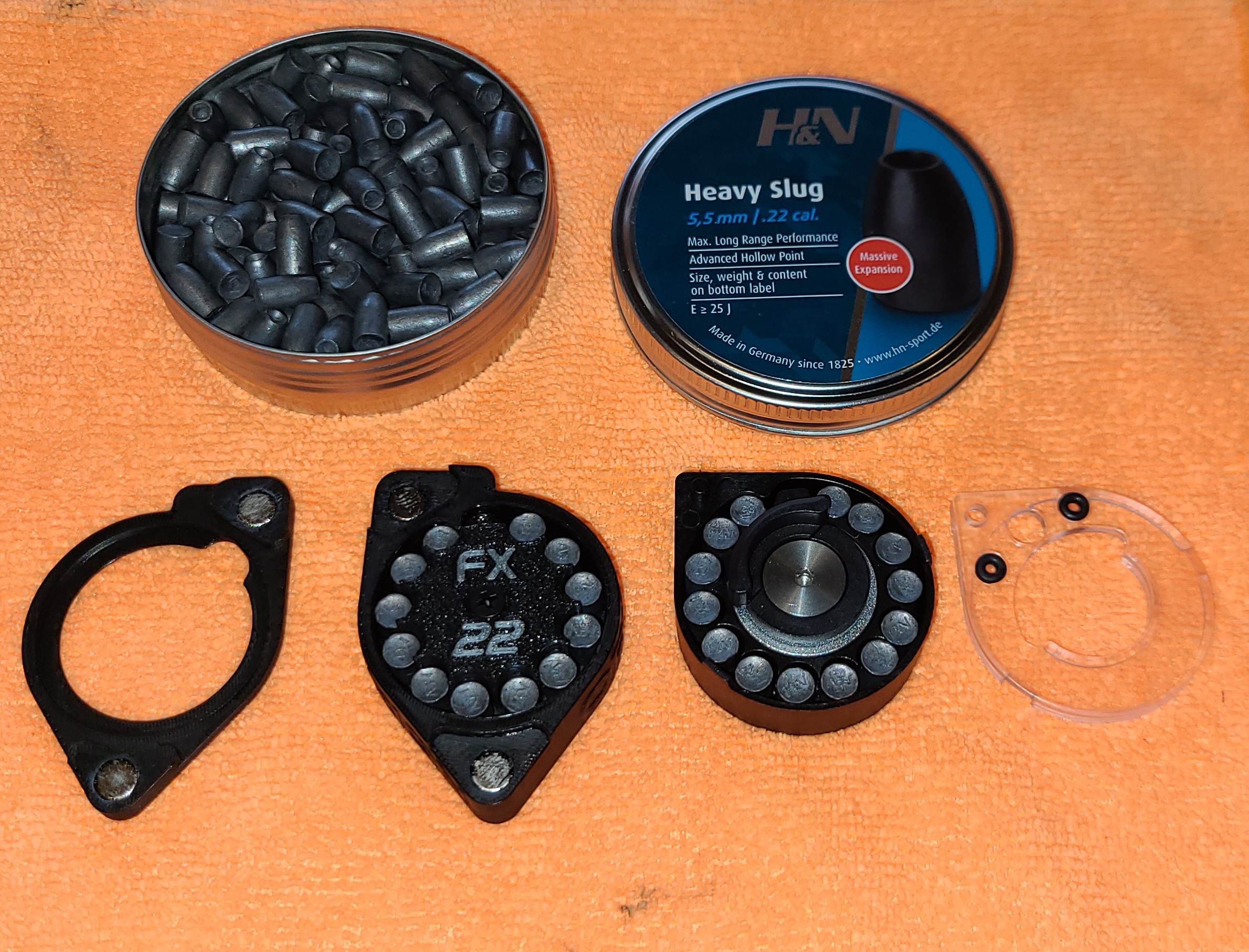

I also use Orion Magazines, they are way easier to load than the FX magazine.
I believe that the Orion Magazine makes the rifle more accurate as it holds the slugs in perfect alignment with the barrel.

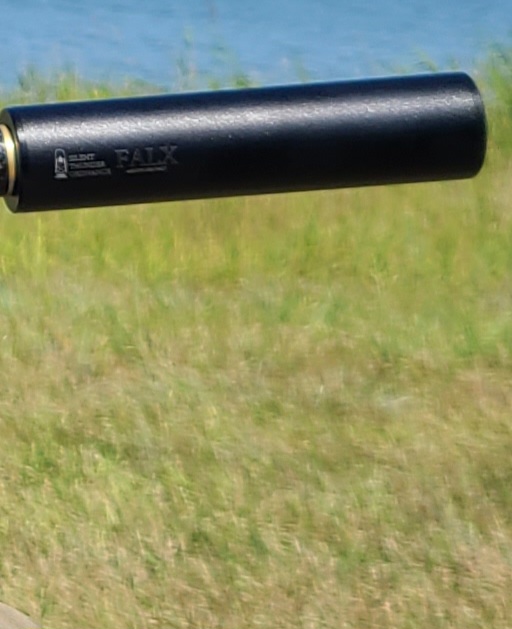

I've been using the Silent Thunder Ordnance Falx.
And Pugio
The Falx makes the DRS Very Very quiet! The Pugio is not as quiet, but light and compact on the 700mm barrel.
Overall I am very happy with my DRS it is lightweight and accurate.
I still want to add the slug probe to possibly pick up a few FPS.

It was a nice calm evening so I took advantage of it and got my DRS sighted in after installing the picatinny scope rail and carbon fiber barrel sleeve.
The 1st thing I noticed was how quiet the carbon fiber barrel sleeve made the rifle. There was a bong noise from the air cylinder/barrel that is now gone.
It was so noticeably quiet that my wife even commented how quiet it was.
The rifle was very accurate without the sleeve but I thought I would give one a try anyway. I am sure glad I did !
With the addition of the butt stock spacer the rifle fits me so much better.
The scope rail not only looks great but it gets my scope down where I like it compared to the dovetail rings.
The more I shoot my DRS the more I like it.
I do believe my M3 is getting a little jealous !
Shoot Straight !
Brian

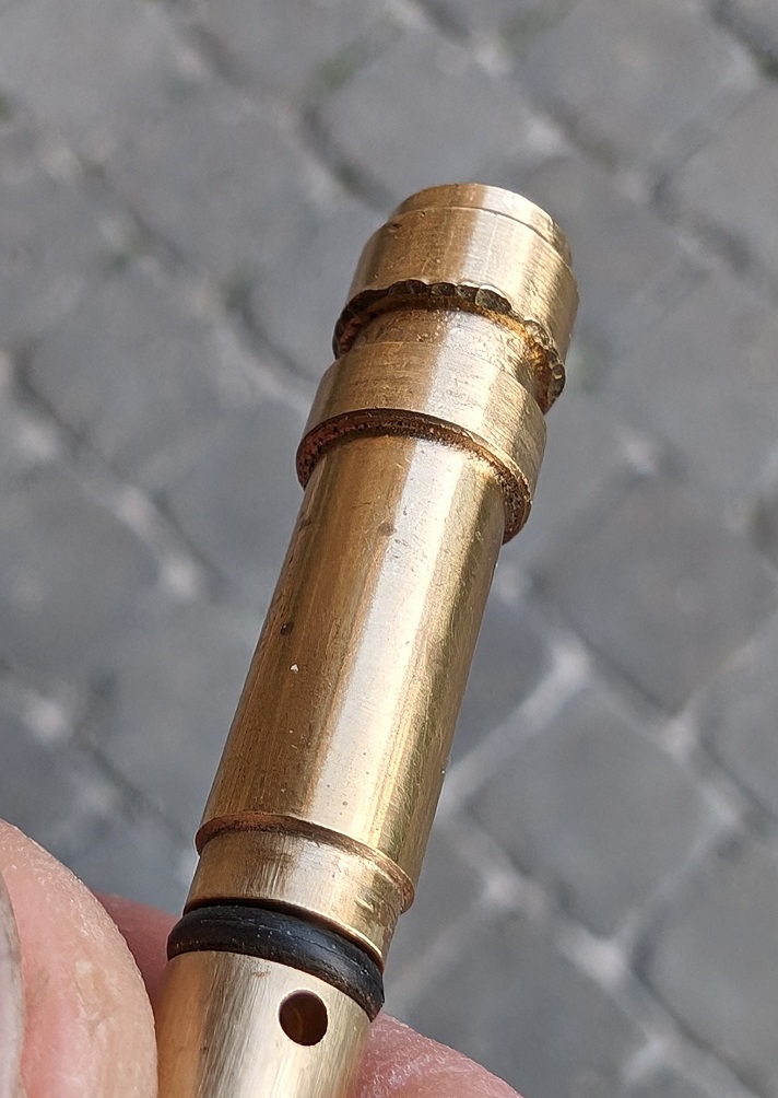

Just to mention...

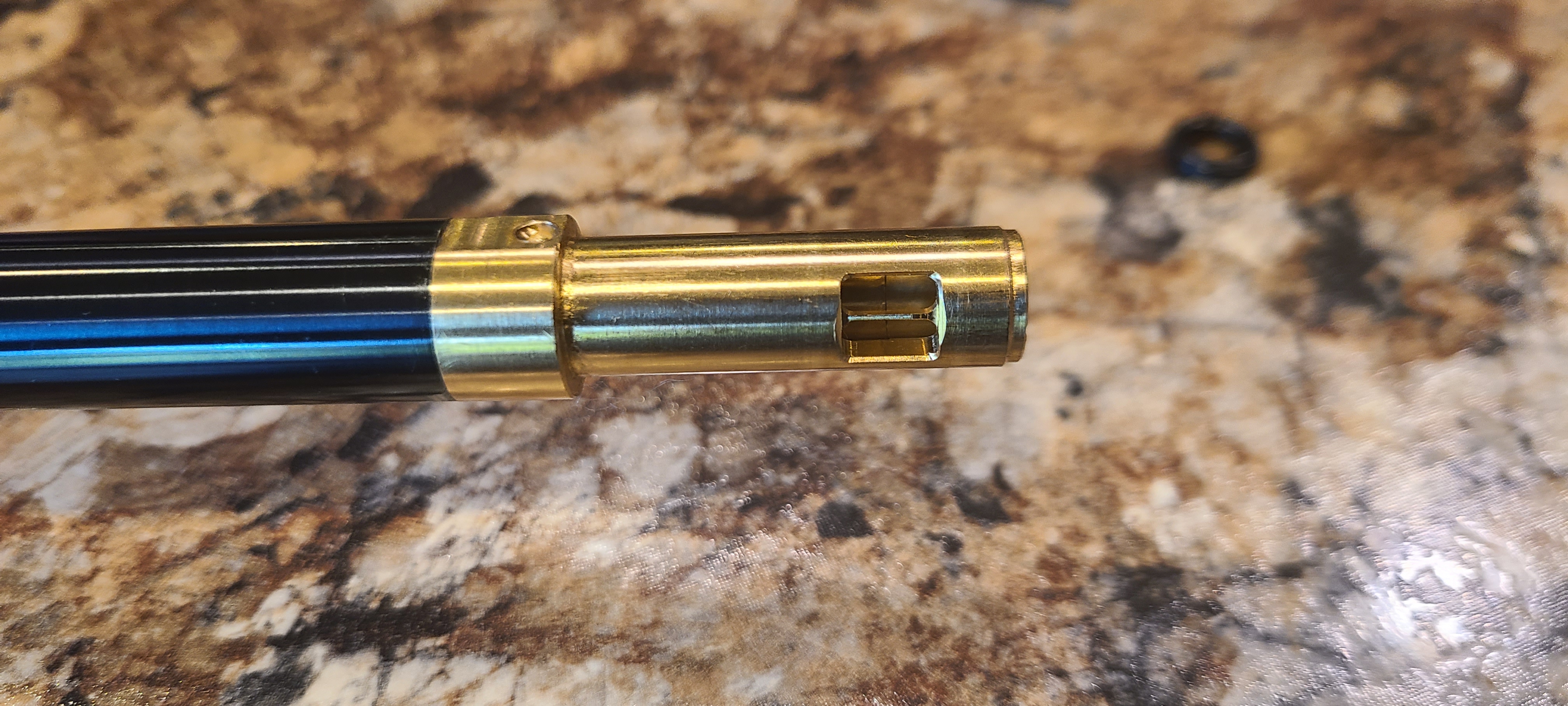

I recently received an email from Krale that the filler plug from the first batch of DRS may no longer be used and that they would send a new one on Monday...but no explanation why.
However, after checking, I quickly found out what the problem could be.
Because this is a brass probe and brass is not exactly the hardest material, I suspect it will probably be replaced by a stainless steel one.
For those who have recently purchased a DRS, do you also have a brass fill probe?
1 photo usually says more than 1000 words ;)
grts
Yves.

Just to mention...
grts
Yves.
My probe is brass.
Shoot Straight !
Brian
Brian, where did you source the carbon fiber barrel sleeve? Or did it come on your rifle?
