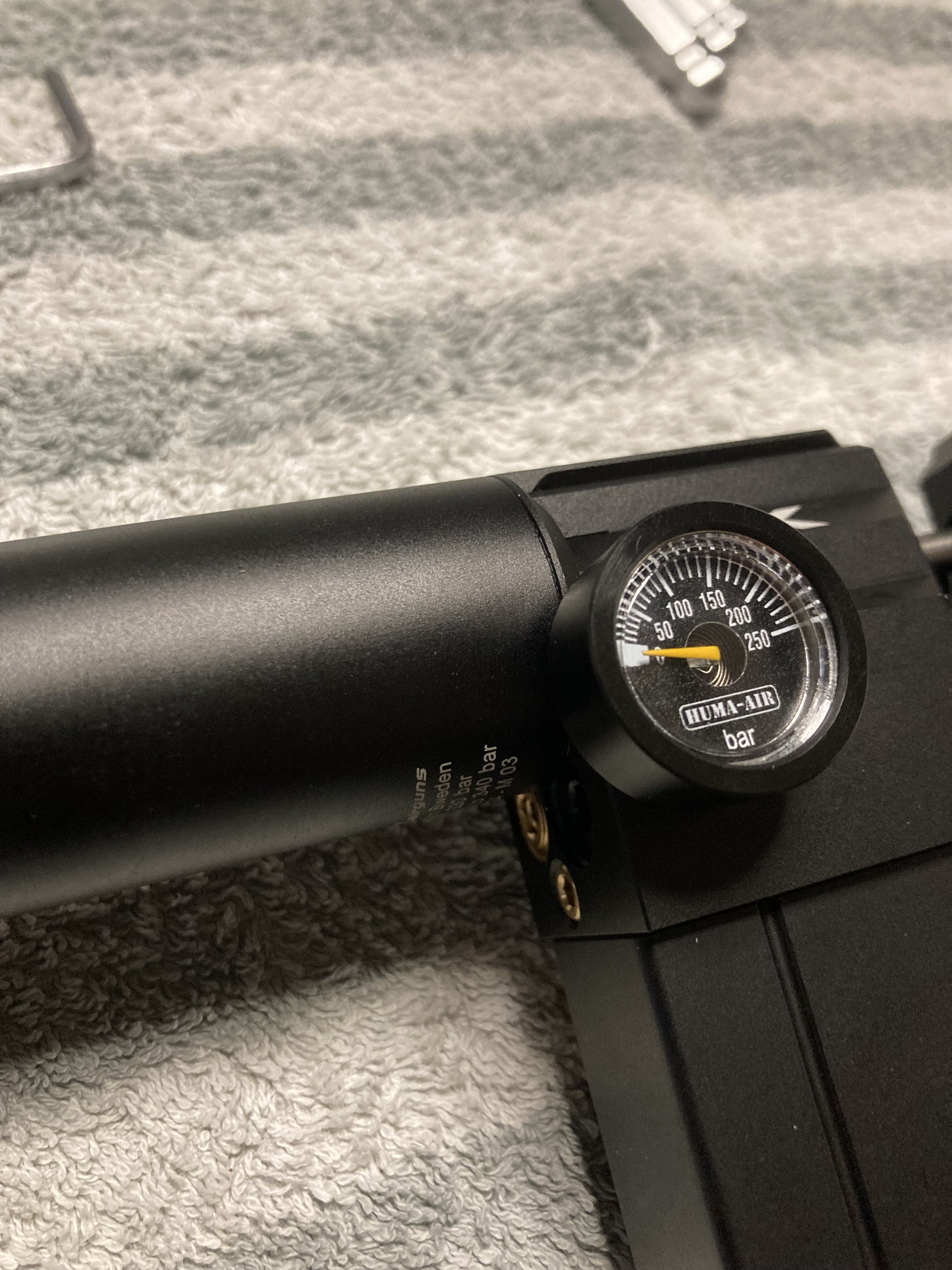

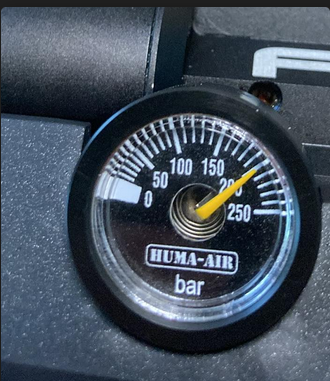

I got my DRS Classic in .22 from Huma. They swapped the gauge on mine for free for a black Huma one. My DRS has the correct thread(1/8)
Cant complain

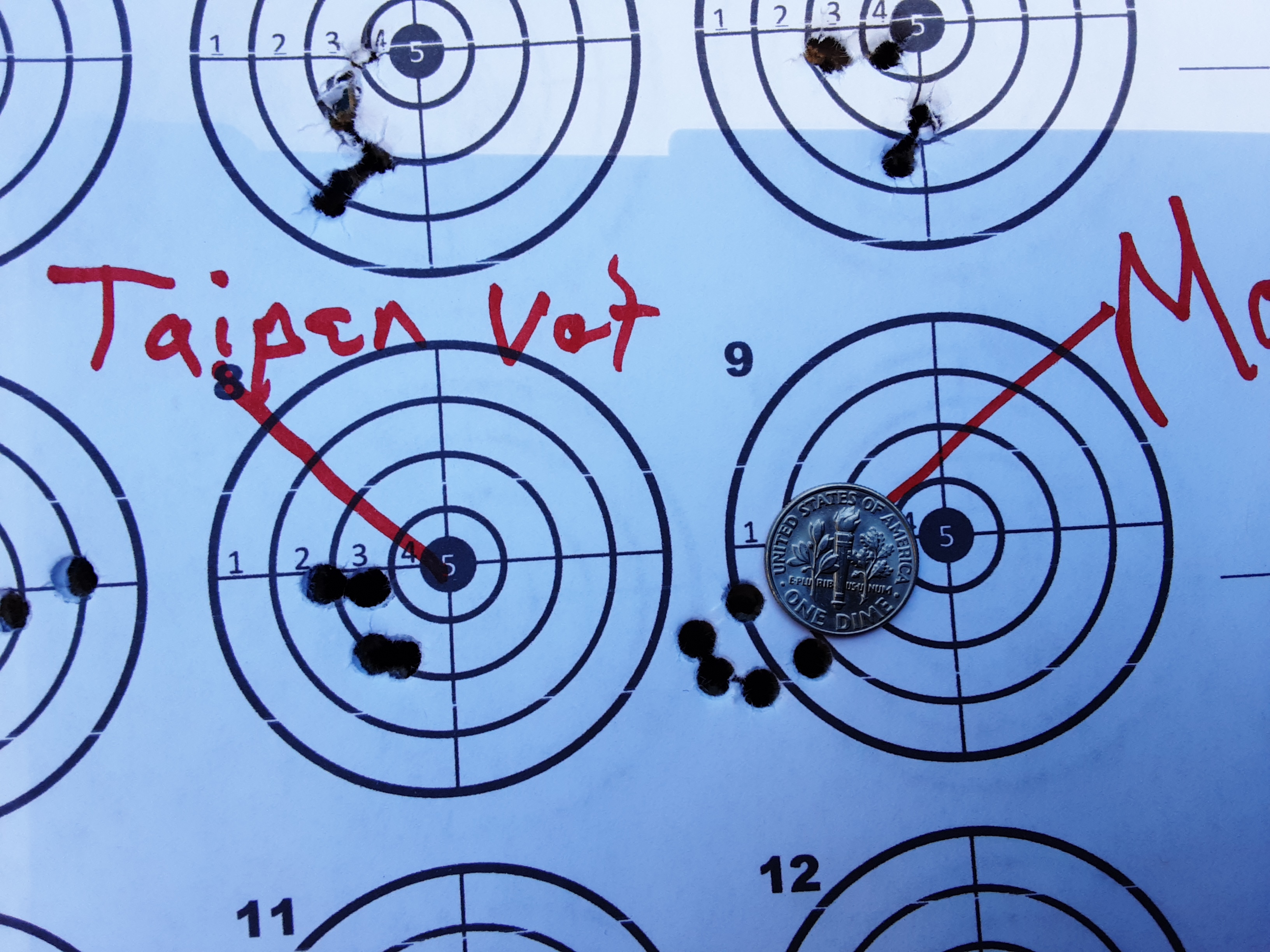

Just from memory I was thinking about getting decent groups with the Maverick using Polymags. I tried it today turning down HS to #6 . It's tuned for 25.3s . I tried the Vet standard also just for a friendly shoot-out . More pellets shot the better the accuracy on both . The FX took a few more shots to settle in . Both of the 5 shot groups were under a dime at around 48 yards. Didn't touch the scope on either .

Just from memory I was thinking about getting decent groups with the Maverick using Polymags. I tried it today turning down HS to #6 . It's tuned for 25.3s . I tried the Vet standard also just for a friendly shoot-out . More pellets shot the better the accuracy on both . The FX took a few more shots to settle in . Both of the 5 shot groups were under a dime at around 48 yards. Didn't touch the scope on either .View attachment 473711
What speed? My .25 M3 just wouldn’t shoot them until I think I went real slow. My Vet .22 will send them fantastic at 935fps. I will try them again out of my DRS tonight now that I have my hammer set where it needs to be. I will give it a mag to season for those softies.
Had to do an edit. If my DRS will shoot Polys under a nickel at 50 yards, I will be elated and it will definitely go squirrel hunting with me this fall.
I just shot 30 .22 Polymags. Ten 3 shot groups at 30 yards Going 925-928fps. Things got better after 21 shots but I’m still not even thinking of moving to 50 yards. I think 30 is enough to season the barrel so I think I’ll scratch them. I also single loaded them because the DRS has a pretty aggressive spring in the mag. Oh well.
Reactions: Headshots
I only shot 10 pellets with the Vet . And 12-15 pellets with the FX. . The 2nd groups were much better than the first 5 round groups with both . 30 rounds should be plenty for checking the accuracy . Imo . I've had the same tin for years . It's too expensive for the amount I shoot. But I bet they would do a number on a big gray ground squirrel. They sure cut a clean hole on paper .
Reactions: MichaelHunt
Super clean holes in paper for sure. And slug or better devastation on animals within their effective range with the bonus of being safer. You had my FX liner hopes up when I thought I wasn’t giving them enough shots to rule them out. But it was still worth the try.

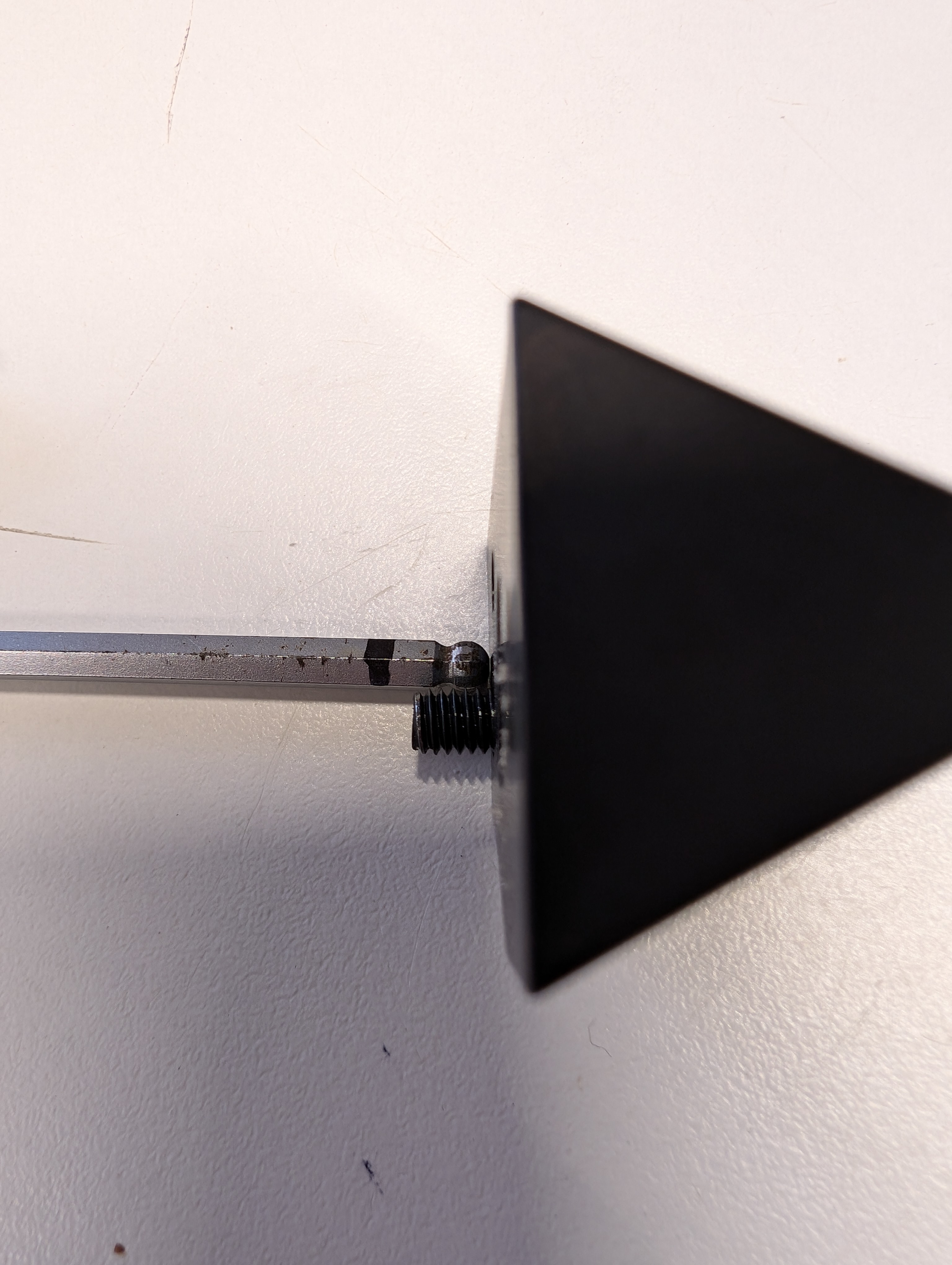

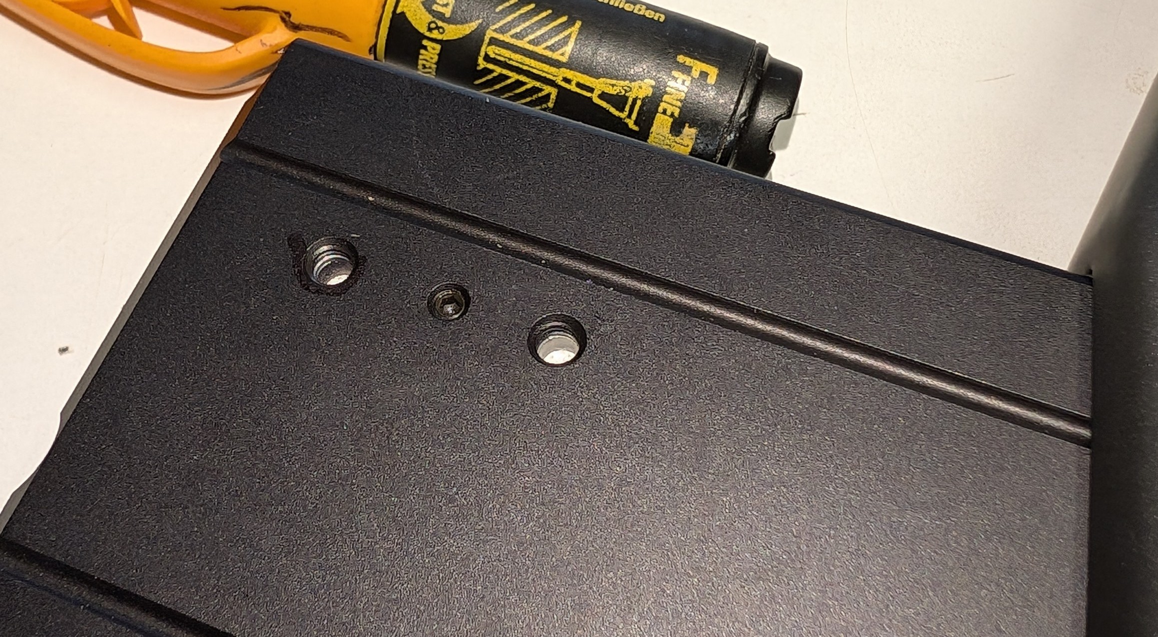

Does anyone else have problems mounting that angled manometer bracket on that large plenum? It seems that the screws (M4x16) are too long. But I think the internal threads in the plenum are not tapped deep enough. However, the hole at sight is deep enough.
What do you propose? use a blind thread tap to lengthen the thread or simply place shorter screws? M4x15 or M4x14??
A friend of mine was able to use the original M4x16 screws. It looks like there are some batches here again with threads that are too short!
FX, unbelievable!
FX, unbelievable!
I did see a YT video that is explaining the different lenghts of the screws:
It's in spanish nu english translation is available for the subtext.
look about 3:30 in the video
