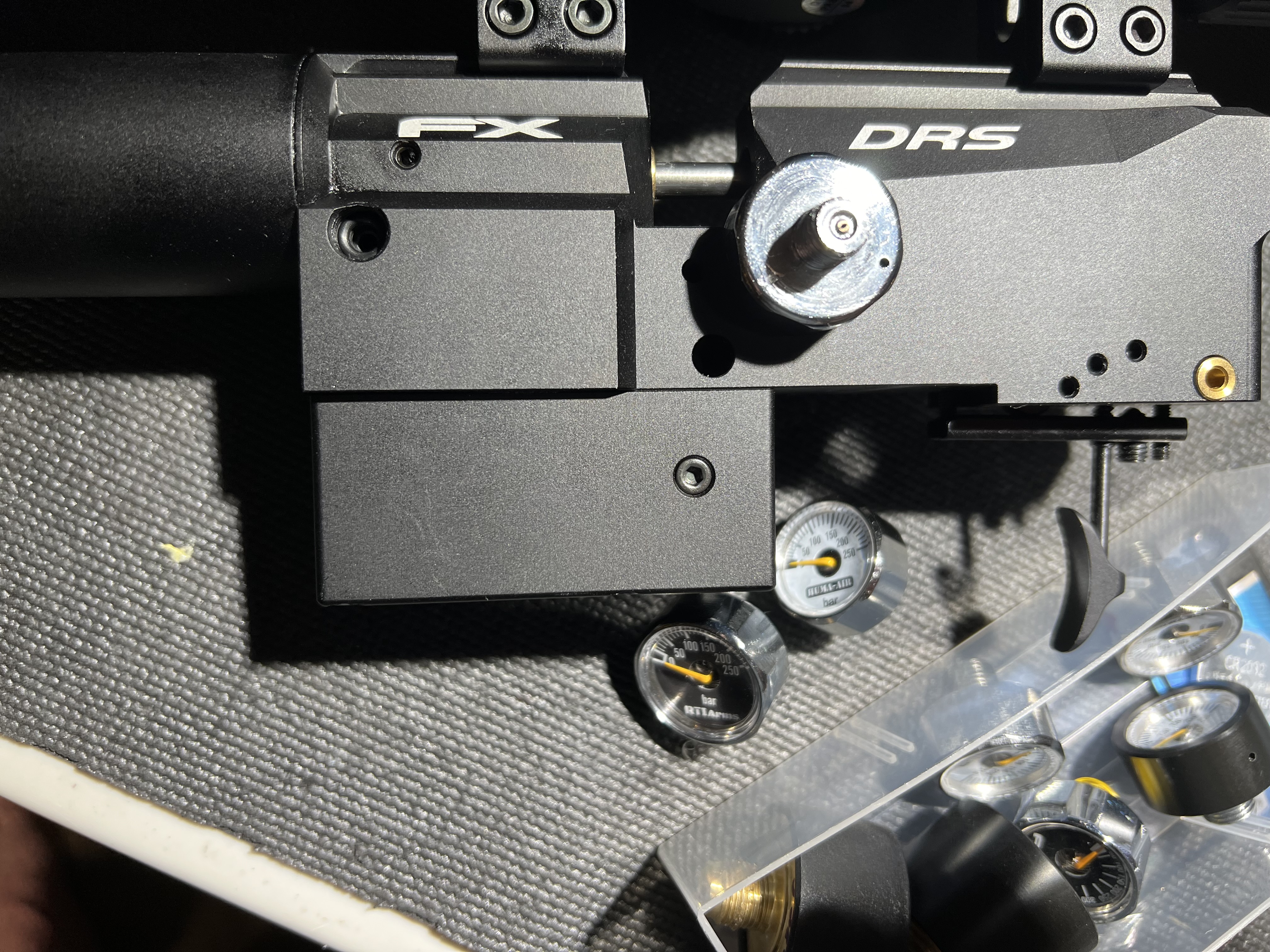

Pretty pissed off right now. I have a good many 1/8 gauges that I’ve tested and are accurate. Was going to put one of them on my DRS. Degassed by playing gauge roulette because my barrel air tank won’t let be loosen the degas screw enough for it to work. After all the air was out I took off the gauge and was like WTF? It’s a M8x1. My serial number is 22130XX so someone is not telling the truth at FX. Now I have to source a gauge I probably don’t want for the gun. I have seven good tested 1/8 gauges sitting right in front of me. Someone is getting a phone call on Monday.
If the SPA China gauge worked, I wouldn’t care. But now I have to shop for a chinagun gauge. I’m just trying to wrap my head around how some guys are getting 1/8 gauges and I got a M8 this late in the game. Something is not adding up.

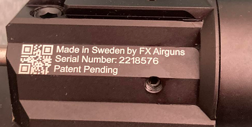

That has been my thought since page 10 of this topic. Or….. are half the guns being produced in FX’s factory and others coming out of a factory in Ping Pong China. I would like to see a guys gun with the true FX 1/8 gauge removed. Here’s mine. And there definitely is not a ton of material there. I want to see what’s different and why. @Ries, you claim to have a 1/8 gauge. Any pictures or your serial number compared to mine?
I posted earlier that it looked to me like the m8 gauges had the white face and 1/8 gauges had the black face on these guns.
For those of you that know what threads your gun has, does this seem accurate? If nothing else, it could help others determine what thread they need for their gun without removing it first.
If that is the case, mine also has the white gauge and serienummer 22157XX.

The major issue I have is the gauge selection in M8 is crap. They are all junk. I applaud Sekhmet for making a quality M8 gauge. Unfortunately I don’t want that thing hanging off the side of my gun. Digital gauges are nice until you can’t tuck them away under your gun. They are like a handle on an angle grinder when screwed into the side of a hunting gun.

I will talk to the guy I got the gun off of on Monday. See what his thoughts are. FX if you’re reading this, why are you sticking some of us in a very confined box with this stupid block? While others that purchased the same gun for the same money have a buffet of gauges to choose from. Make it right!

There are no good M8 gauges. So for me it’s a new block that is threaded the same as a quality gun. If I have to buy a block and wait a year for it to become available, I will. But this topic already has 15k views and I will burn them down until I’m satisfied. If we all got stuck with M8 blocks, different story. I can accept that and deal with it.

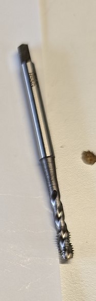

My friend has already had this issue and tapped them deeper and is using the factory screws. My plenum has the same issues I just haven't got round to looking at it yet.
Having watched the video and measured my screws, they are too long for both the plenum and gauge. I'll speak to my FX dealer.
That's how I did it now, went to the store to get an M4 machine thread tap blind hole ($16) and then carefully tapped it to the bottom.

My serial number is 221304x. It has a white gauge.
Sure, this is my serial:
