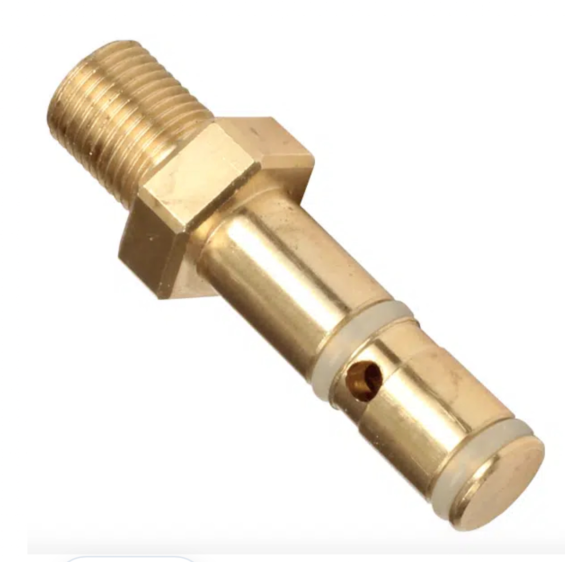

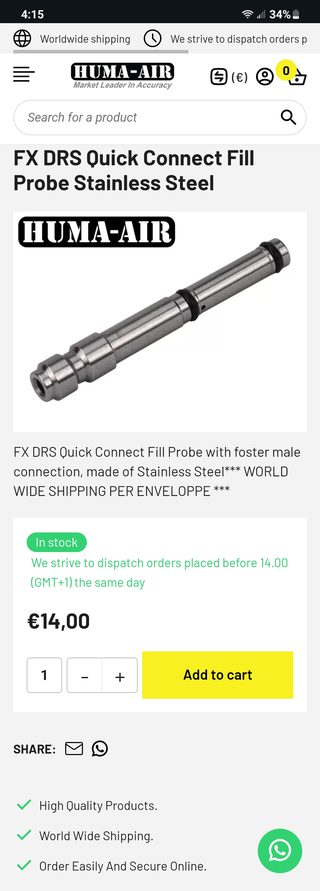

I have a bunch of brass fill probes from my China airguns. I’ve replaced them with with stainless probes when available. Dreamlines had brass probes but they were threaded. Guys complained but the reason for the threaded brass probe was so you can screw on a metal/durable male foster. The fill probe for the DRS, it says China to me. Will we all be contacted or just sent updated or proper parts? Absolutely not. The money is already in the bank and this will all be forgotten when the next cool gun is introduced. They all know this. Most people have very short attention spans today.

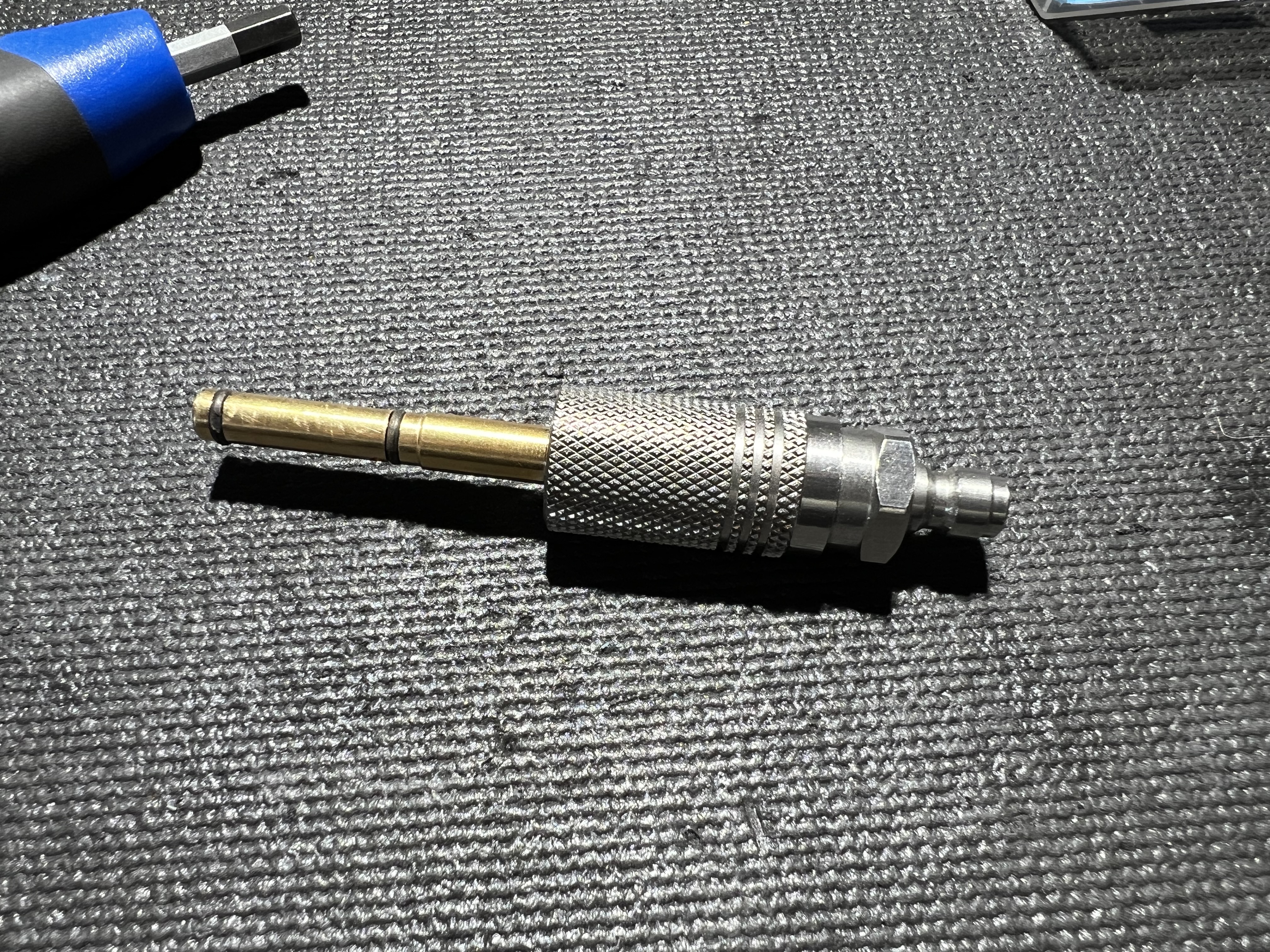

This is what I’m using to fill my gun until something safer is available. My probe was already chewed up when the gun arrived so I didn’t want to make matters worse constantly connecting and disconnecting from old softy.

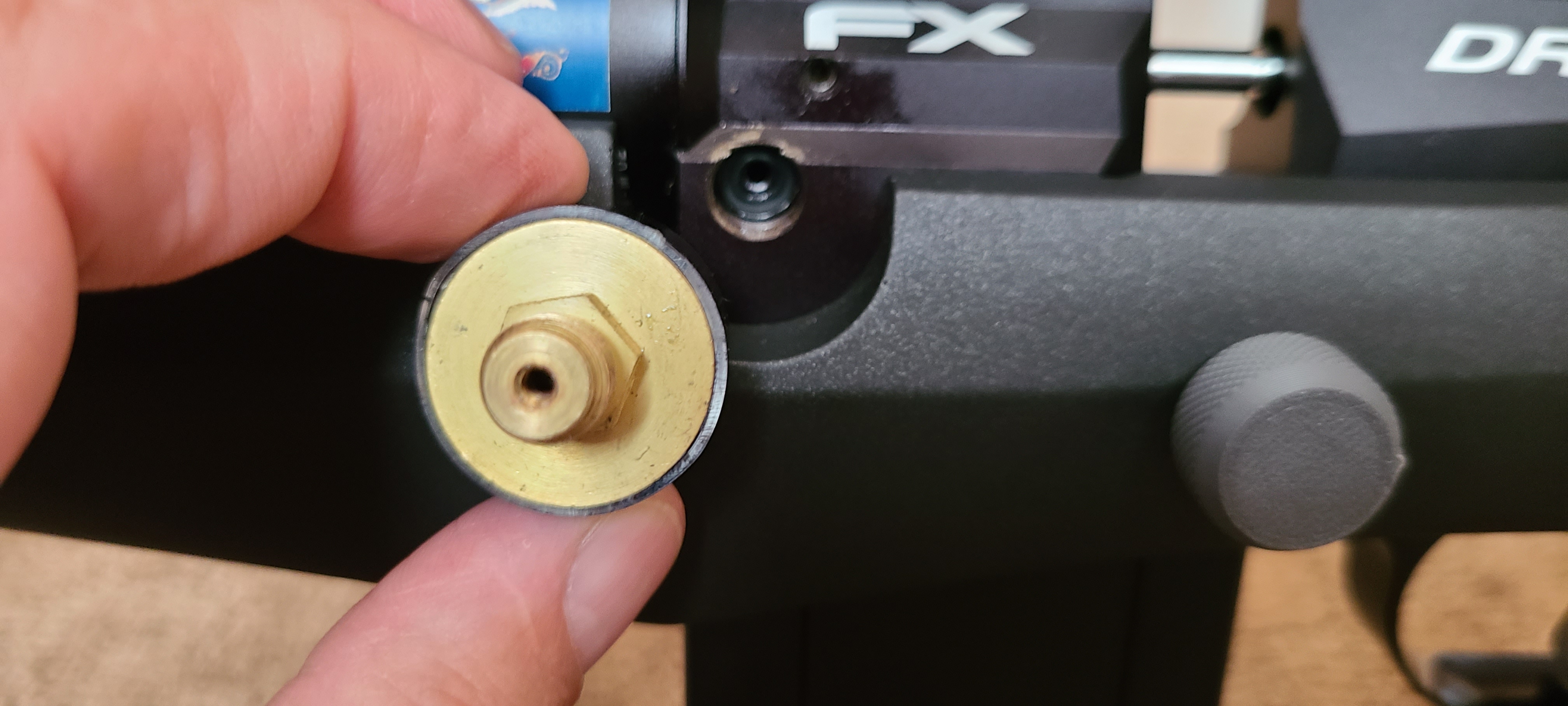

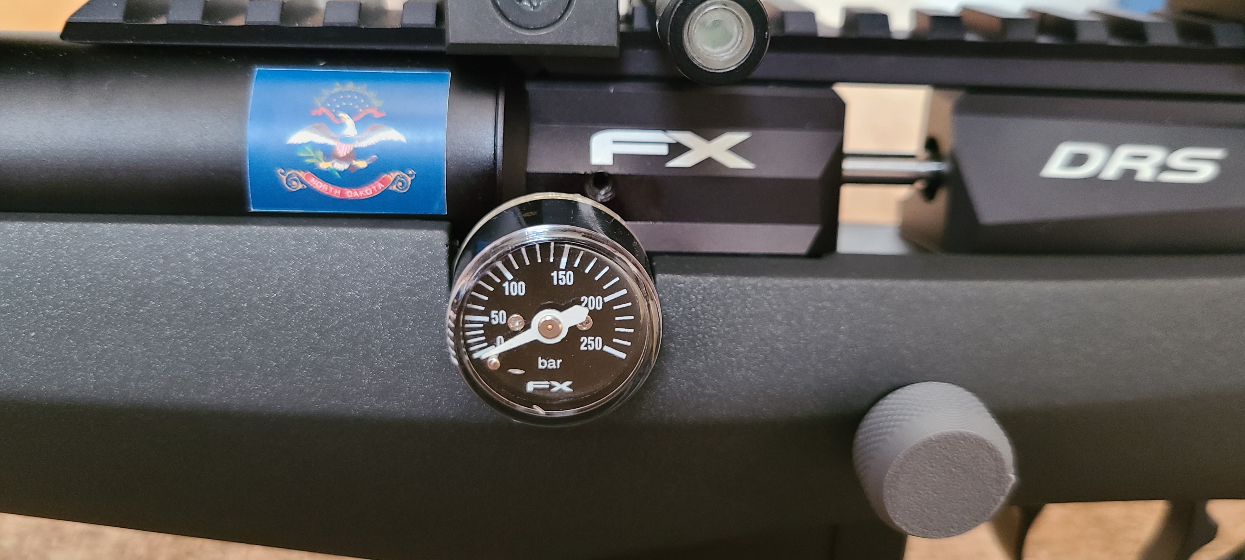

That has been my thought since page 10 of this topic. Or….. are half the guns being produced in FX’s factory and others coming out of a factory in Ping Pong China. I would like to see a guys gun with the true FX 1/8 gauge removed. Here’s mine. And there definitely is not a ton of material there. I want to see what’s different and why. @Ries, you claim to have a 1/8 gauge. Any pictures or your serial number compared to mine?
My DRS 22 700 came with the normal ⅛ thread
My 25 700 came with the M8 thread

Yes, because of shipping, Huma is now at the bottom of my shopping list. I used to spend hundreds a month with them but those days are over. I now will only order from them out of sheer desperation. Why doesn’t FX just offer a probe built like a Dreamline probe as a safe durable replacement under warranty? There are different kinds of brass. The one that comes with the DRS is one step above lead.
