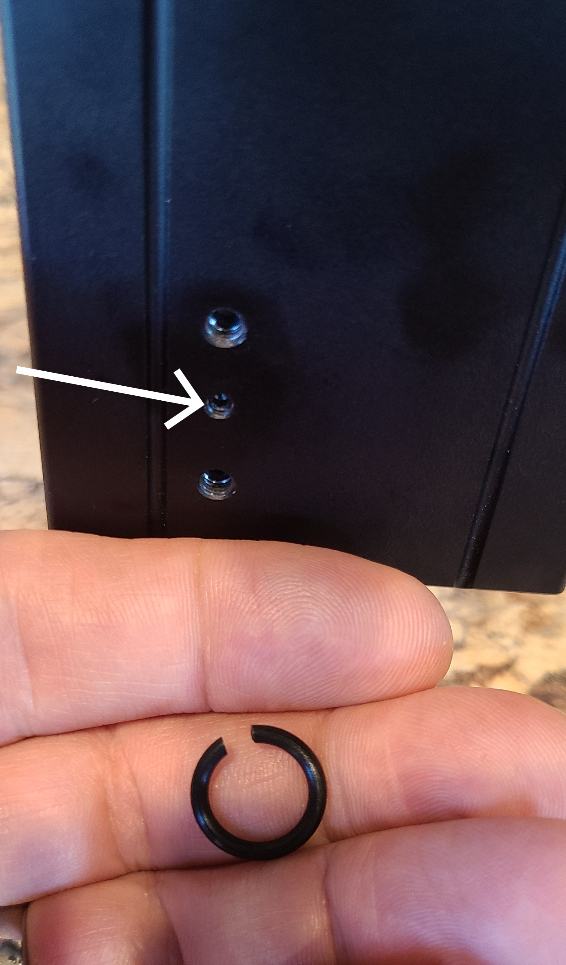

This is off the current topic, but I thought I would share a fix that I got from UA.
I have degassed my DRS a few times for different reason's.
But when I replaced the grub screw in the SHP plenum it would not seal.
I contacted UA and they recommended putting a small piece of o-ring in the hole before the grub screw.
Simple but highly effective !
