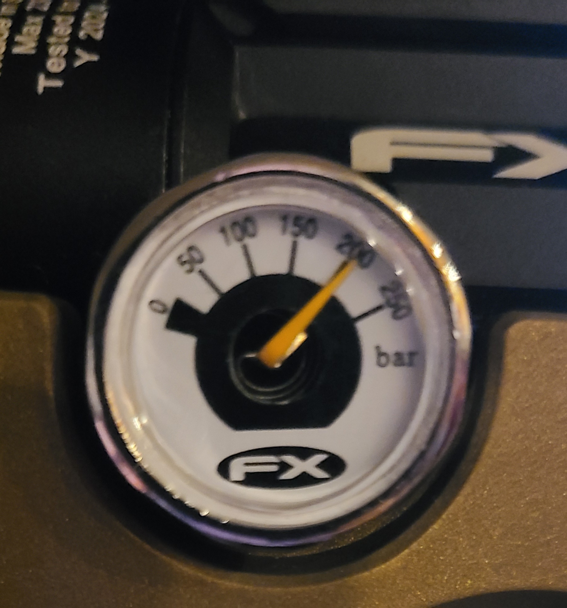

I told this story in a PM to another helpful member here but I think it bears repeating. Friday evening I took my Taipan and the DRS to a buddies house to take care of a bird problem. He’s a hardcore powder burner guy, doesn’t give a rats butt about airguns. But he knows how much I have invested because he has asked. I figured the DRS would be perfect for him. He liked it as we shot but asked about the tape on the gauge. I told him is was really far off so I marked it for when it’s time to refill. Then I showed him the chewed up probe. Said that’s the only two issues. Besides that, it seems like a good gun. He said did this thing only cost you $250? I said try almost $1,200. He said why is it not in a box headed back to where you bought it from. I told him that issues are not unique to just this gun. I said guys get bad regs, valves, gauges and have leaks. He said WTF is wrong with you airgun guys. You sound like sheep that have been conditioned to accept piss poor products. Then spend more money fixing them yourself. You guys are dumb.
After that slap to the face from a close lifelong friend, I’m definitely changing my approach. Oh, and he asked what kind of problems have you had with that gun, pointing at my Taipan. I said none for seven years. Still all original. He said give me that gun then, you shoot this thing if you love it so much. But the kicker was he didn’t like the rear cocking after two mags of forward cocking with the DRS.

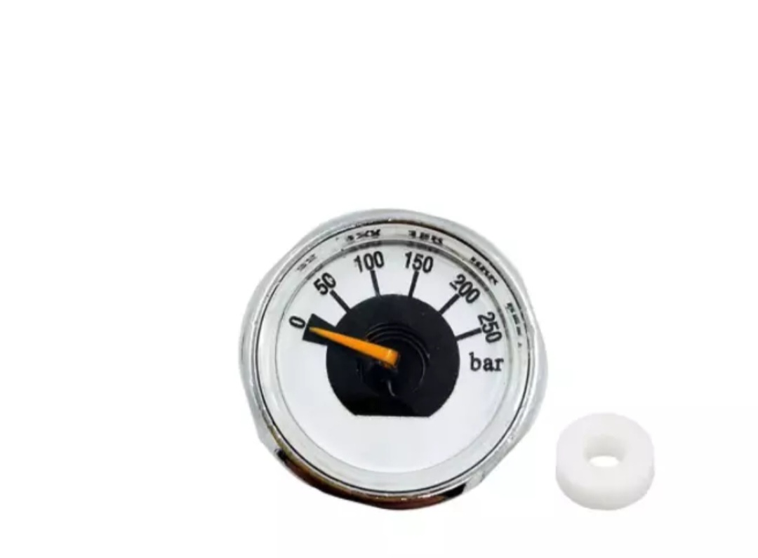

Just an update on the fill probes. We are to use them until they are unusable or blow apart. Then call for a replacement. FX is not updating the probe. With the M8 gauge, if yours is not accurate, I guess they will keep sending you new ones until you get a good one. I’m going to try one more M8. If it’s not accurate, then it will be onto the next step.
Since FX is only going to send out another Chinese Ebay gauge,

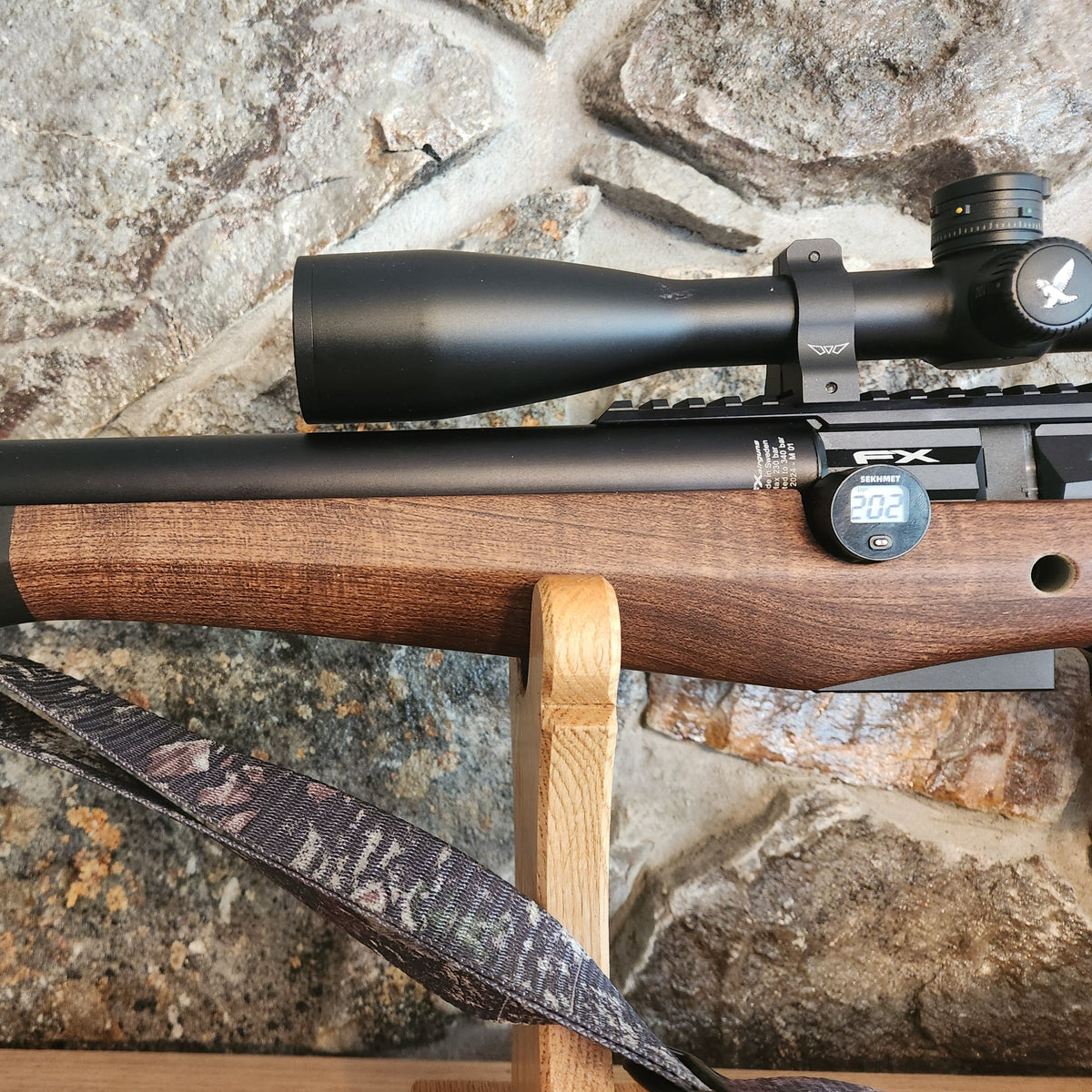

I broke down and bought a Sekmet M8x1 25mm gauge for my DRS
But the factory installed gauge has "FX" printed on the dial. Automatic additional 7 HorsePower.

That sir is an exact duplicate that practically confirms what we already know. I appreciate the link to the digital, but even if FX gifted a Sekhmet to every one of us with the obsolete block, I still wouldn’t use it. Beautiful sleek traditional rifle with a big knob hanging off the side is not what I find appealing. All I would like is to be able to use one of the few available low profile analog gauges that are available in 1/8. Like some of my other DRS Classic brethren can. I will try one more FX econo metric gauge. Or I guess Chinese eBay gauge with FX logo. I hope for the sake of my blood pressure that it’s accurate. I haven’t touched my gun in a week. This whole thing has me not liking it much. But I have been shooting my real FX’s. At least that’s what I hope.

I have to agree with your opinion on the Sekhment gauge. It is thick and does stick out further than I like. What I find weird is that they are an American company, but they only build gauges in BAR. I prefer good ol PSI.
