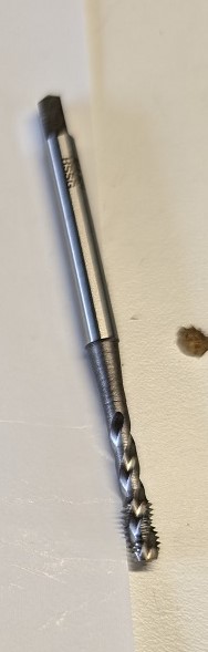

That's how I did it now, went to the store to get an M4 machine thread tap blind hole ($16) and then carefully tapped it to the bottom.
Next problem, after replacing the normal plenum with the large plenum, there is now a leak. That opening with an O-ring 10.0x1.0 NBR90 (no. 44 on the parts list) is so close to the plug for drs (no. 49 on the parts list) that it probably does not seal very well. There was also no O-ring with the optional large plenum and you will have to reuse this O-ring from your other plenum. I'm going to order some O-rings in advance. I'm really not satisfied with the build quality of such a DRS! This could be much better FX!!

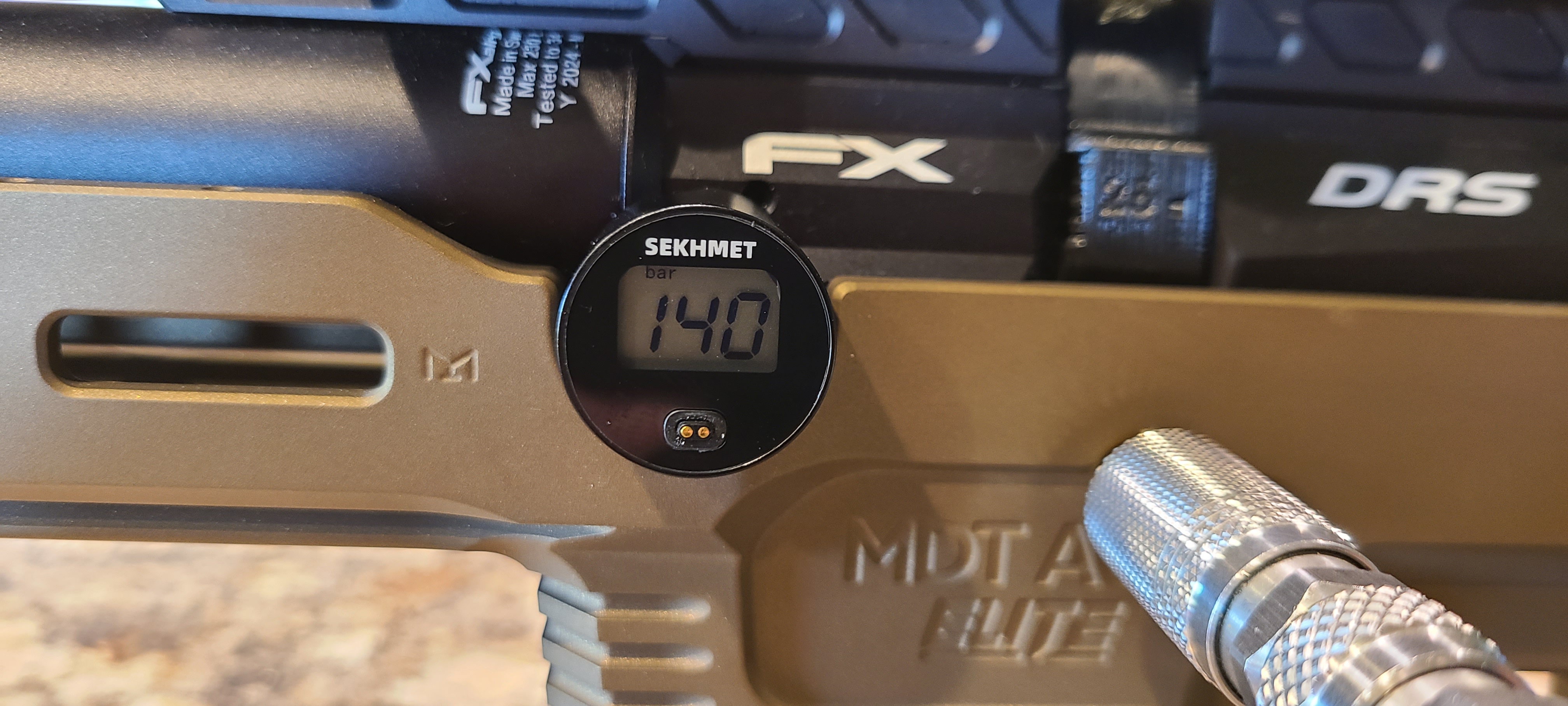

I didn’t degas it or put a gauge on it. i shot it over a chronograph and noted when the velocity dropped. If you look at the paper where I recorded the velocities you can see they were pretty consistent and then it dropped dramatically. That’s when it hit the limit on the reg . Just note the preasure on the fill gauge. As I posted earlier there is a grub Allen screw next to the fill gauge. I am thinking this is to degas either the plentum or the bottle. I haven’t tried it. No need yet. You could try that and if it is the bottle you will know by the gauge. You could then try loosening the plug on the plentum and see if that empties the plentum. Don’t shoot the plentum down. They warn not to do that as it will damage the valve. If you just start shooting different ammo to see what shoots best in your particular barrel you really don’t need a gauge to see the reg pressure . Once you have narrowed down a couple of promising pellets or slugs, then start increasing the hammer a full turn at a time. But take a measurement how far in the hammer screw is to start as a reference. Use a caliper or a small 1/2” wide ruler as I did. Make a note with measurement each time you make an adjustment to reference . Once you don’t see any increase in velocity, then up your reg preasure 1/2 turn and put the hammer back where it was before and start over all the time trying the different ammo . After all not all ammo likes the same velocity. Record the shot count and make a judgement where you want to be on velocity, accuracy and shot count on the preferred ammo either you like or the rifle likes. I determined my rifle likes the JSB jumbo monster grand 28.5 grn pellet in the mid 800 fps. I was hoping I could get them up to 900 fps but as the rifle is set up now I probably wouldn’t get a full mag of shots. I can get two mags shooting them in the low 800’s With not a really big difference in drop or fpe out to 60 yards which is my limit for hunting. I want to try some more slugs in .218” diameter too especially the new FX Halos. A carbon fiber shroud is on my list too. I’m not a fan of the bigger plentum on the Classic. From the looks on the drawing of the parts there is still a lot of metal to the plentum. I’m no expert on metallurgy an pressures but possibly a short plentum could be made to withstand 160 bar safely with more volume of air without being so long. Simple to make by a machine shop. I’m sure it will come up down the road.

Since someone got out their paddles and revived this topic I’ll add something for the 500mm .22 guys. My gun has just been sitting and collecting dust. For what it does best, I have the reg set at 115-118b. Tonight I felt bad for the thing so I tested when the stock components run out of gas versus the reg setting. I stopped at 140b and still had enough hammer to go 150b. Everything got worse while I was at 140b so the gun is back to 115b now with the hammer set about 3.57mm. The gun even started to recoil real bad at 140b with just an 18gr pellet. Slugs were horrible at 140b but they are not at 115b and going 60fps slower.
