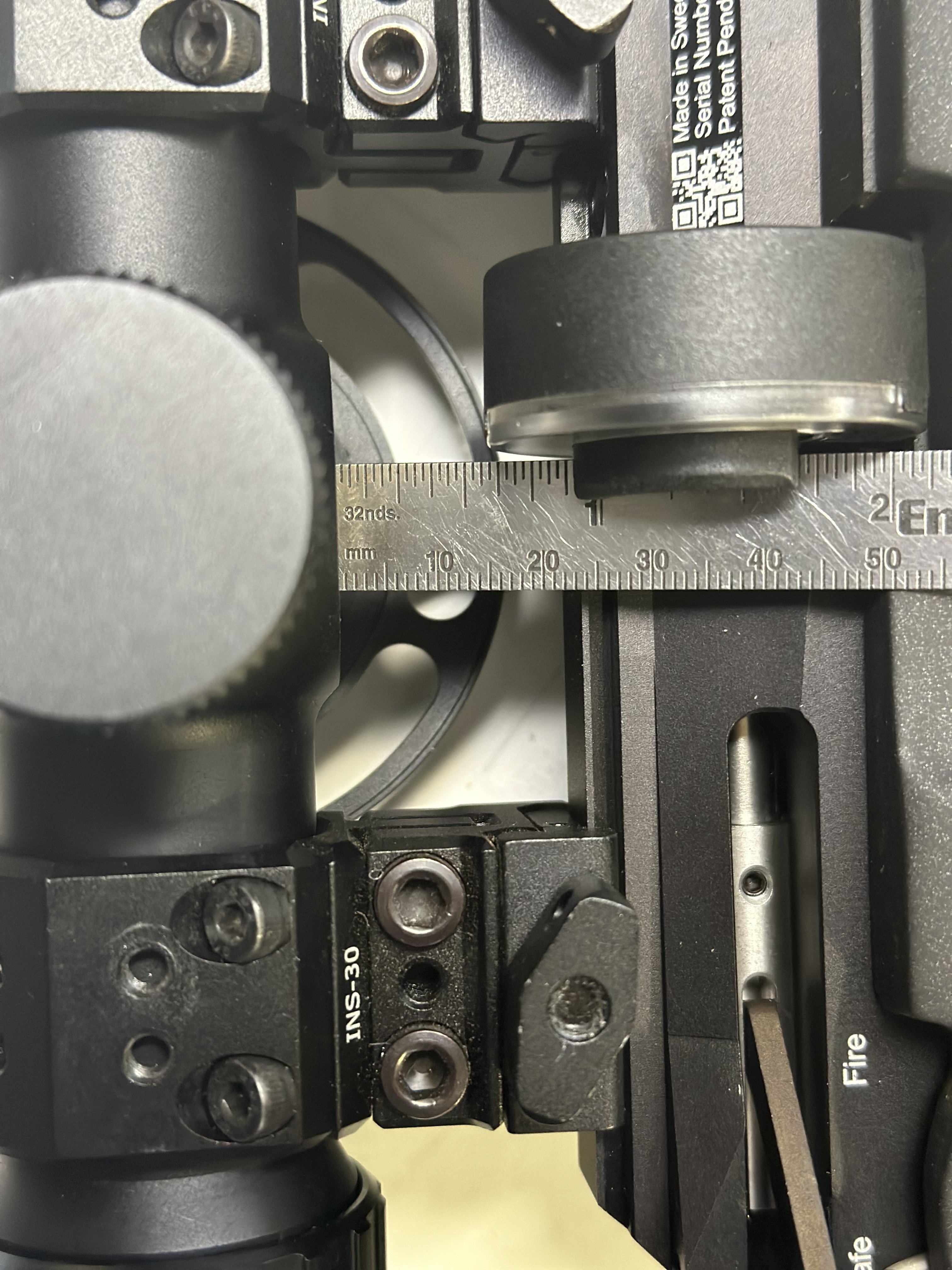

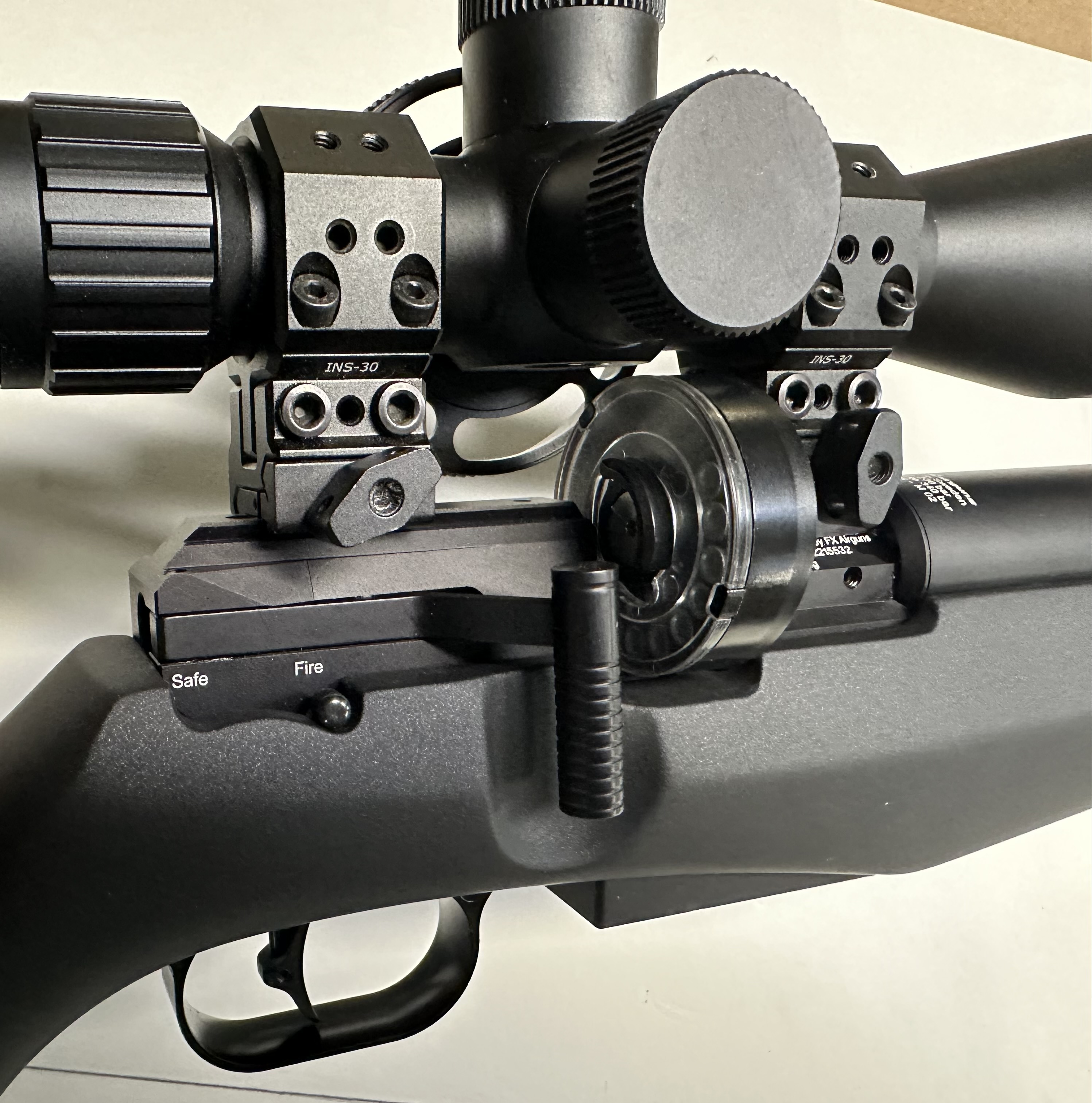

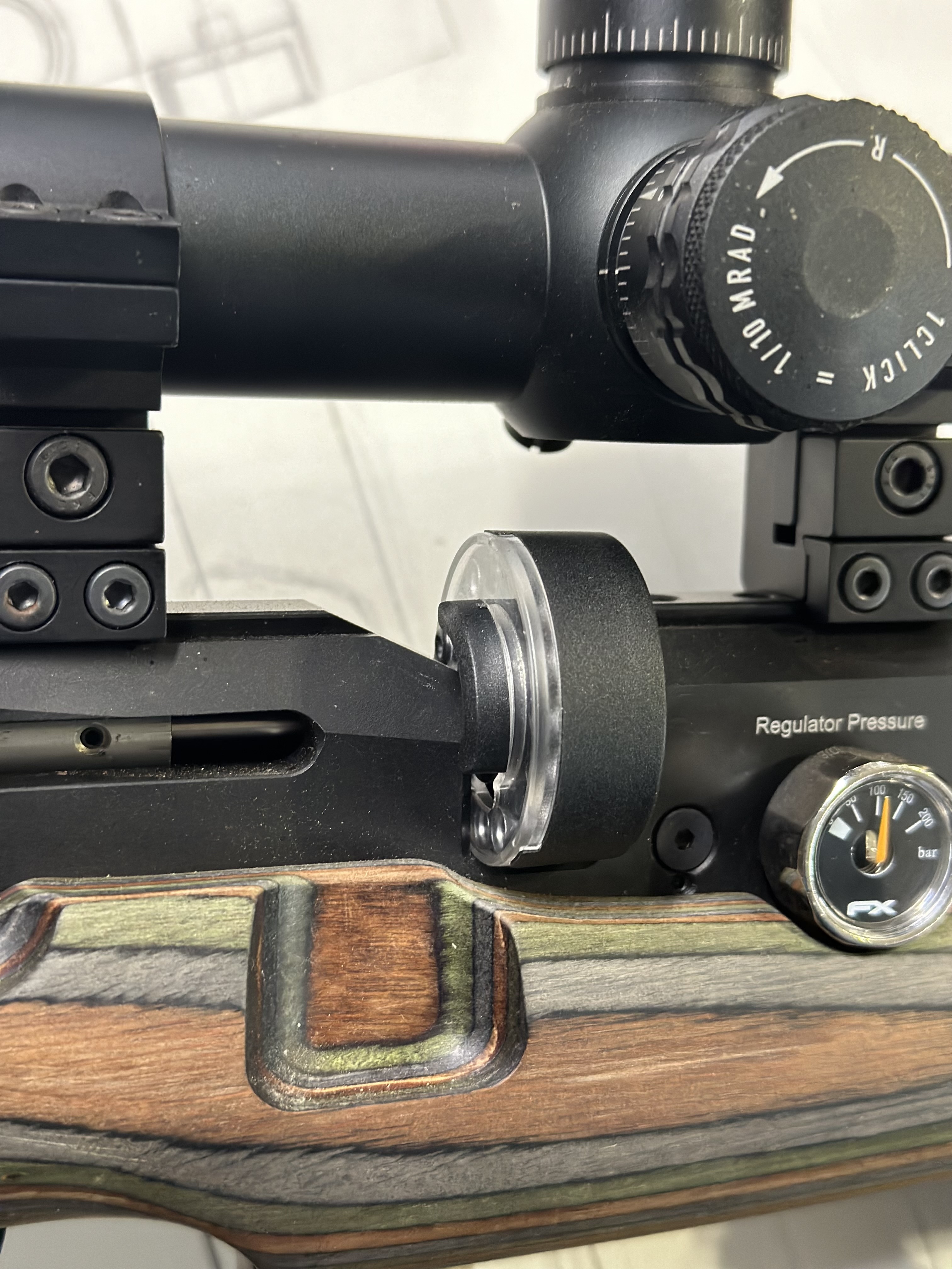

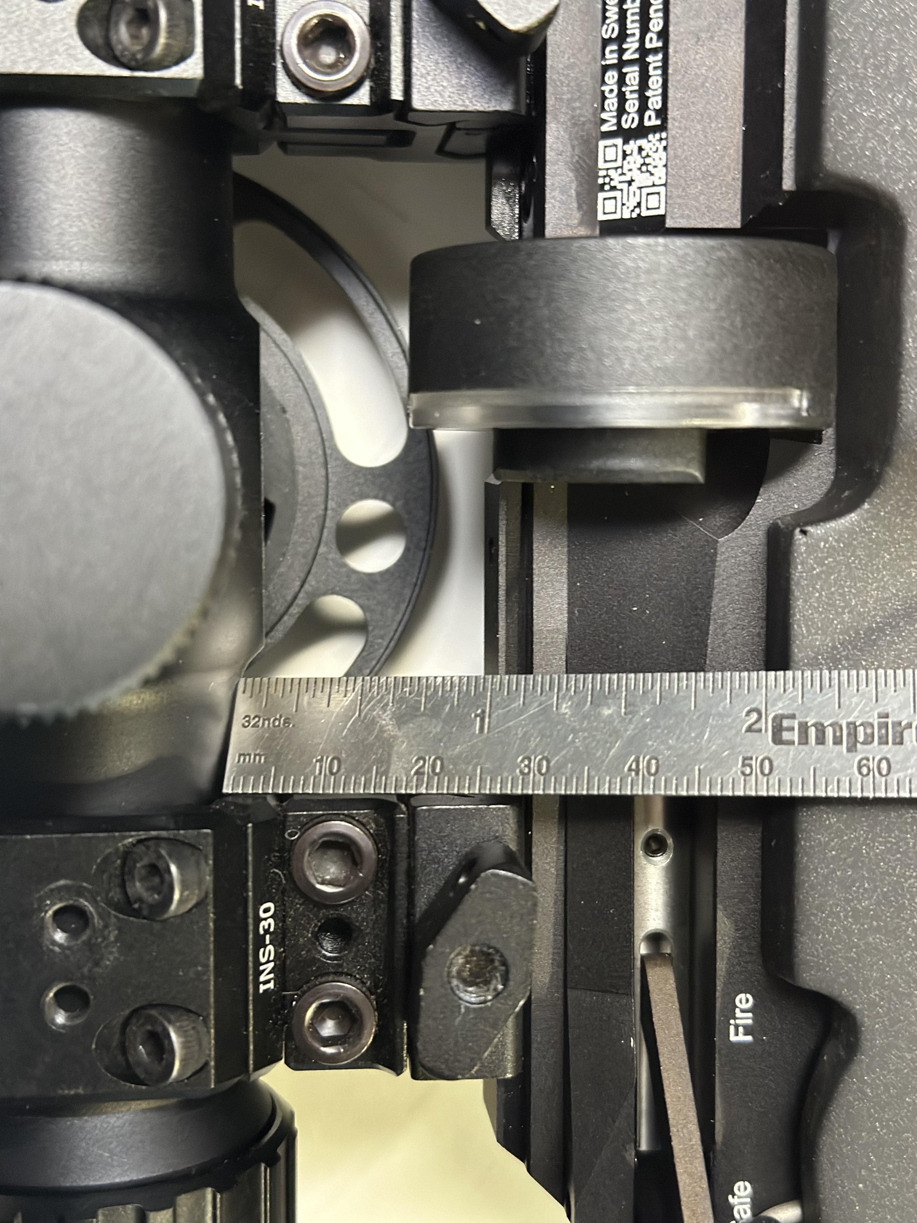

Here is some pictures . The Eagle Vision rings are set at 1” height above the top of the receiver. with the Small DRS mag in the receiver there is slightly over 1/2” between the scopes turret block and the top of the magazine. Now that is with a Hawke compact 44mm Airmax scope. Other scopes may have larger turret blocks. A half inch scope rings would probably work with my Hawke scope. If you add the low picatinny rail which I think is 1/4” , then you could go with a low set of rings say 1/4”. But you have to consider what front objective size your scope has. I’m not sure if a 50mm would still work with 1/4” scope rings. As I said this height is workable for switching between the Dreamline 18 mag and the DRS 13 mag. i just have to raise my face up to get a full line of sight with my jaw still on the stock. I just prefer a more face down , solid contact with a stock. People have different size faces and different length necks so one set up doesn’t fit everyone. I know because I make a living making and selling the Accu-Riser line of cheek pads and comb risers For all types of rifles.

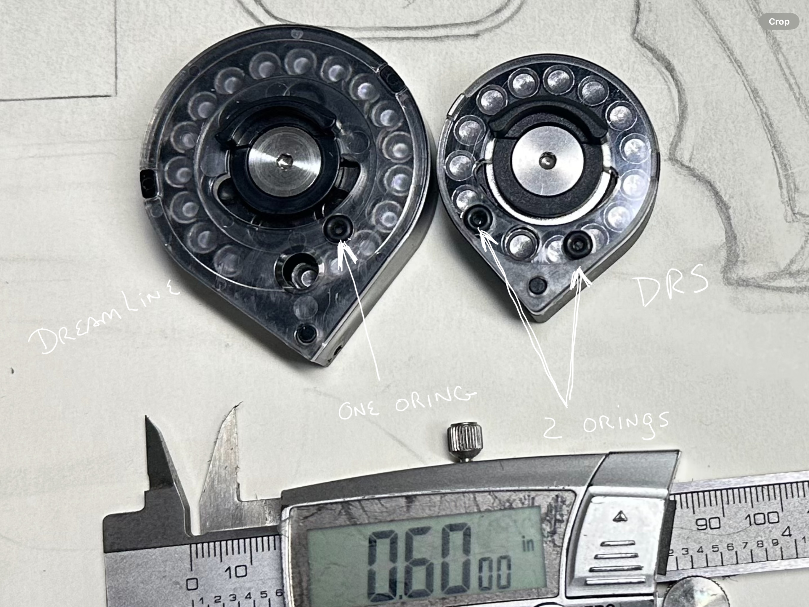

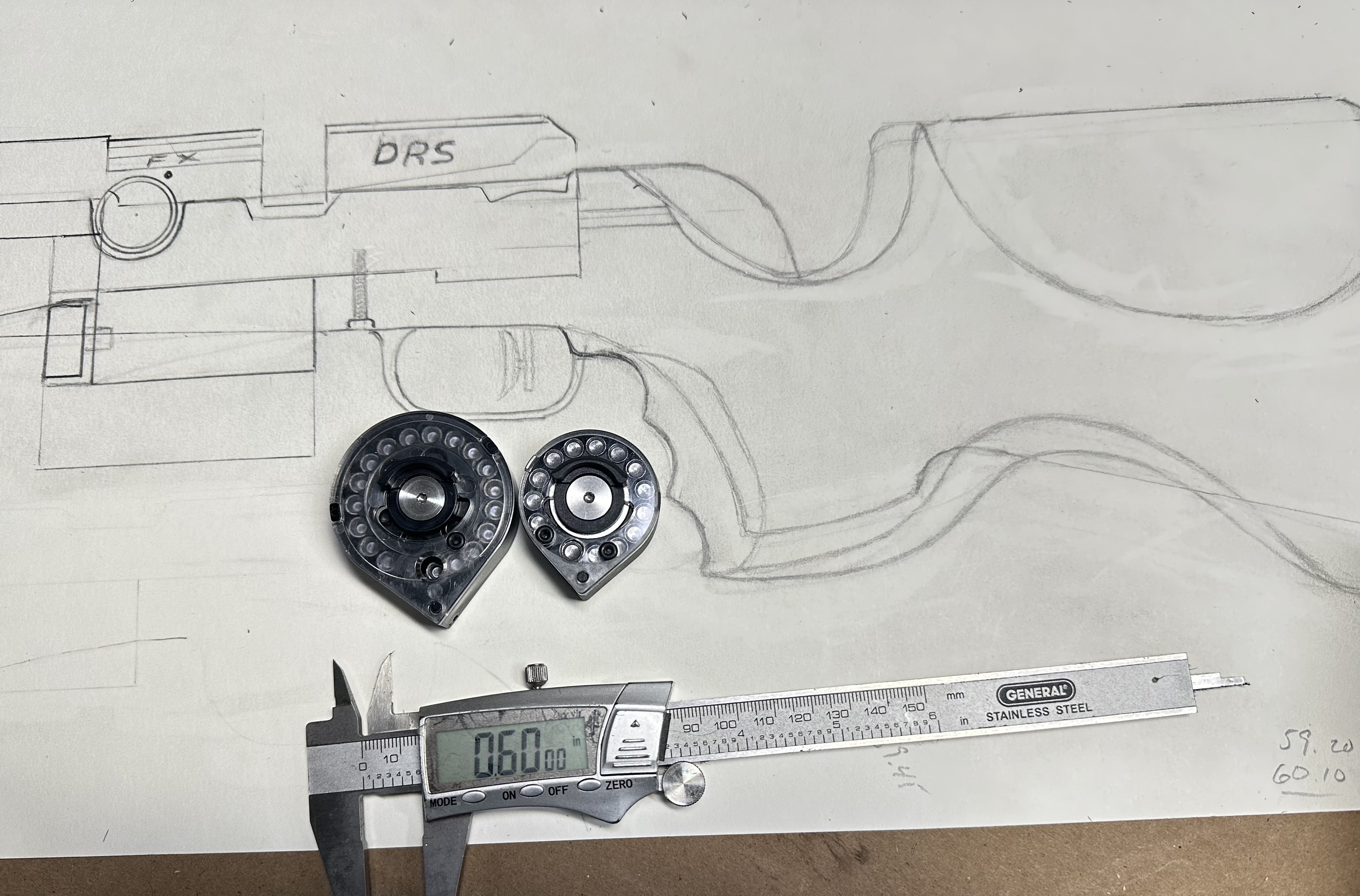

Another thing that I just found on the magazines. My Dreamline mag fits so loose in the DRS that if you tilt the rifle to the right it will fall out. Yet the DRS mag is very tight in the receiver. I checked the measurements between the Dreamline and DRS opening and they are only a couple thousands of an inch difference. Same for the width of the magazines. The main difference is that the DRS mag has two small o rings imbedded in the cover where the Dreamline only has one. I would not shoulder the DRS on a sling with the Dreamline mag in it as is. I would like to hear from others how their 18 Dreamline/Crown magazines fit in the DRS. Also I decided to check the fit of the new 28 grn jumbo pellets and some 37 grain slugs I have in the DRS magazine. No problem. So i then tried them in the Dreamline magazine and they fit and function fine. I was not expecting that. I have no desire to shoot say over 30 grain ammo in this gun
