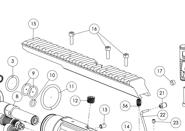

The probe looks to be similar to the Dreamline probe, but the parts drawing says pellet probe, Dynamic. So, if pin probes for the Dynamic are already available, they should work in the DRS. Mine already has the dual transfer port.

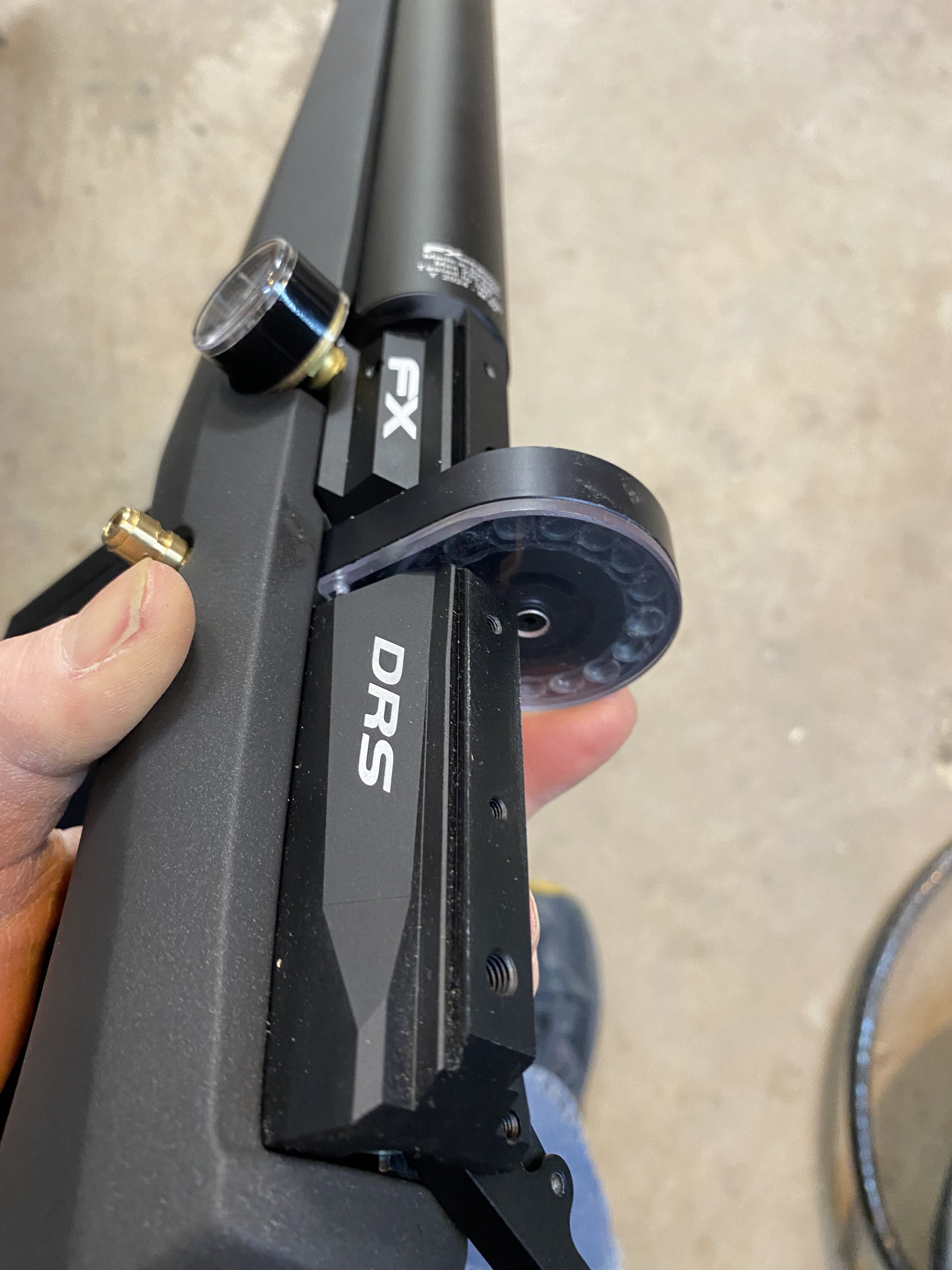

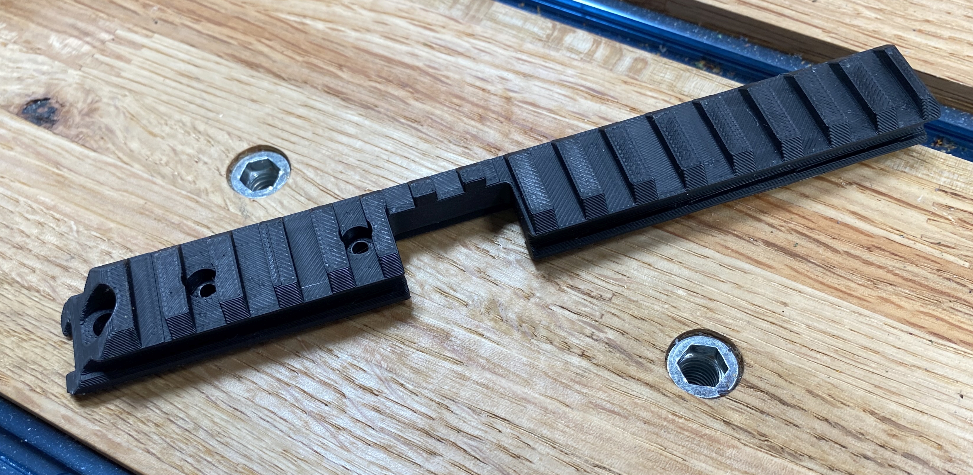

Working on a Picatinny Rail for mine.
3D printing out of PLA to check fitment before printing in carbon fiber reinforced nylon. I ordered a small dovetail cutter so I can cut one out of aluminum.

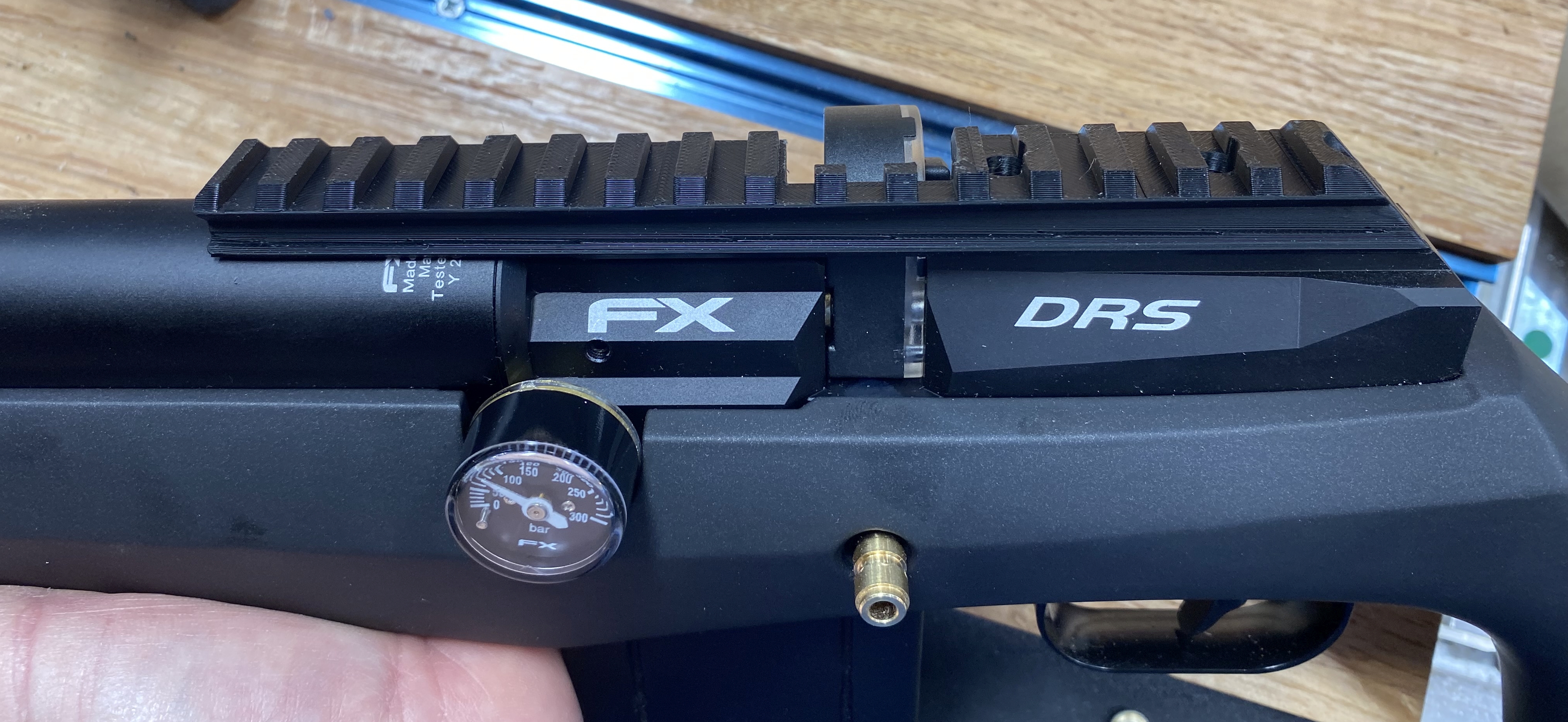

Fits like a glove. I made a change to the mag slot. narrowed in on the front end and printing another PLA version for another test fit.
The Crown magazine above is from MK I ,25cal. Anyone know if they have changed? How long of a projectile will the other non-DRS mags accept in .22cal?
That looks great! How sturdy is it was a Scope attached? I was looking at the parts breakout and it appears there is a mounting point in front of the magazine well. Or is that just an error in the drawing?

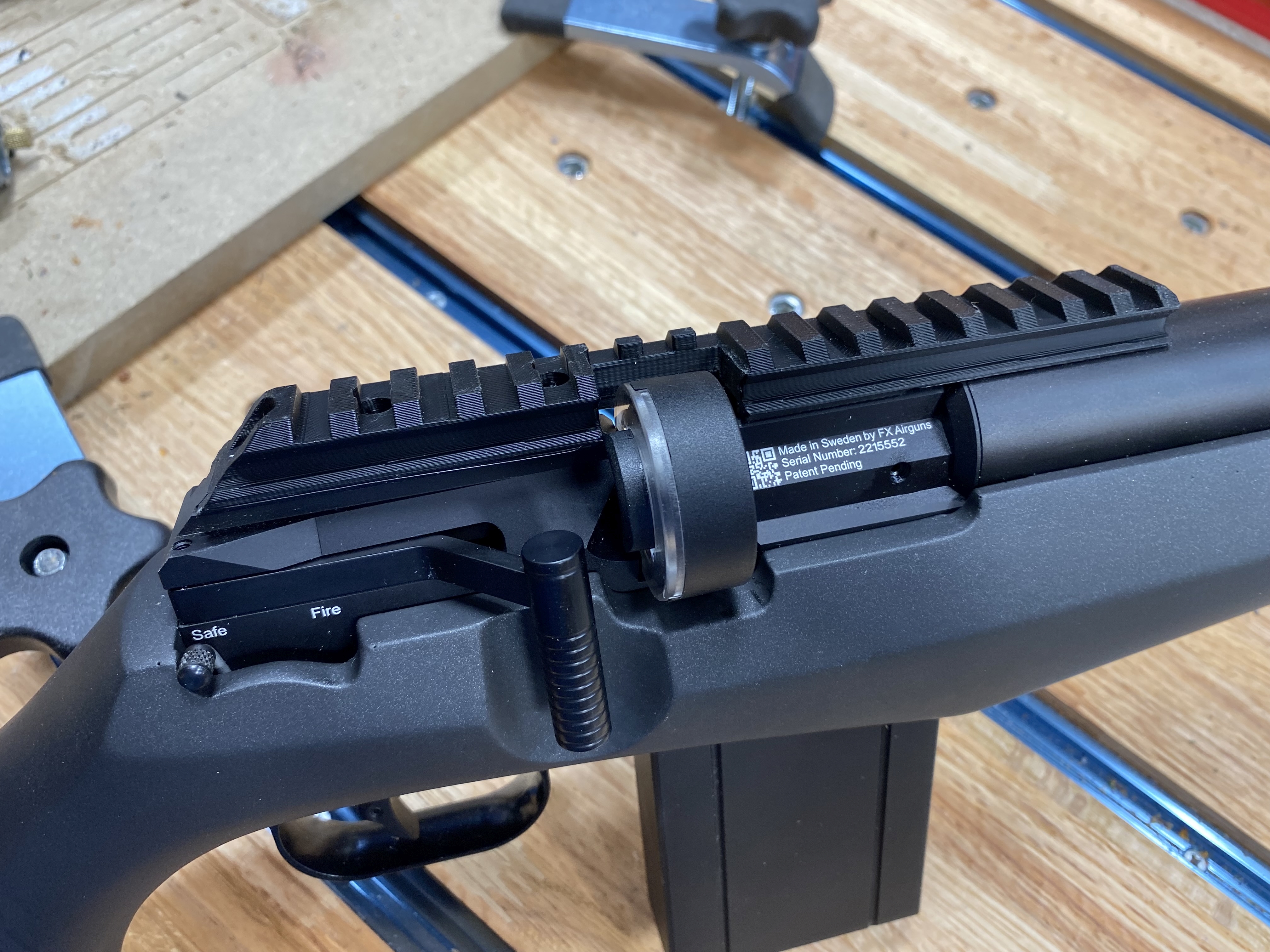

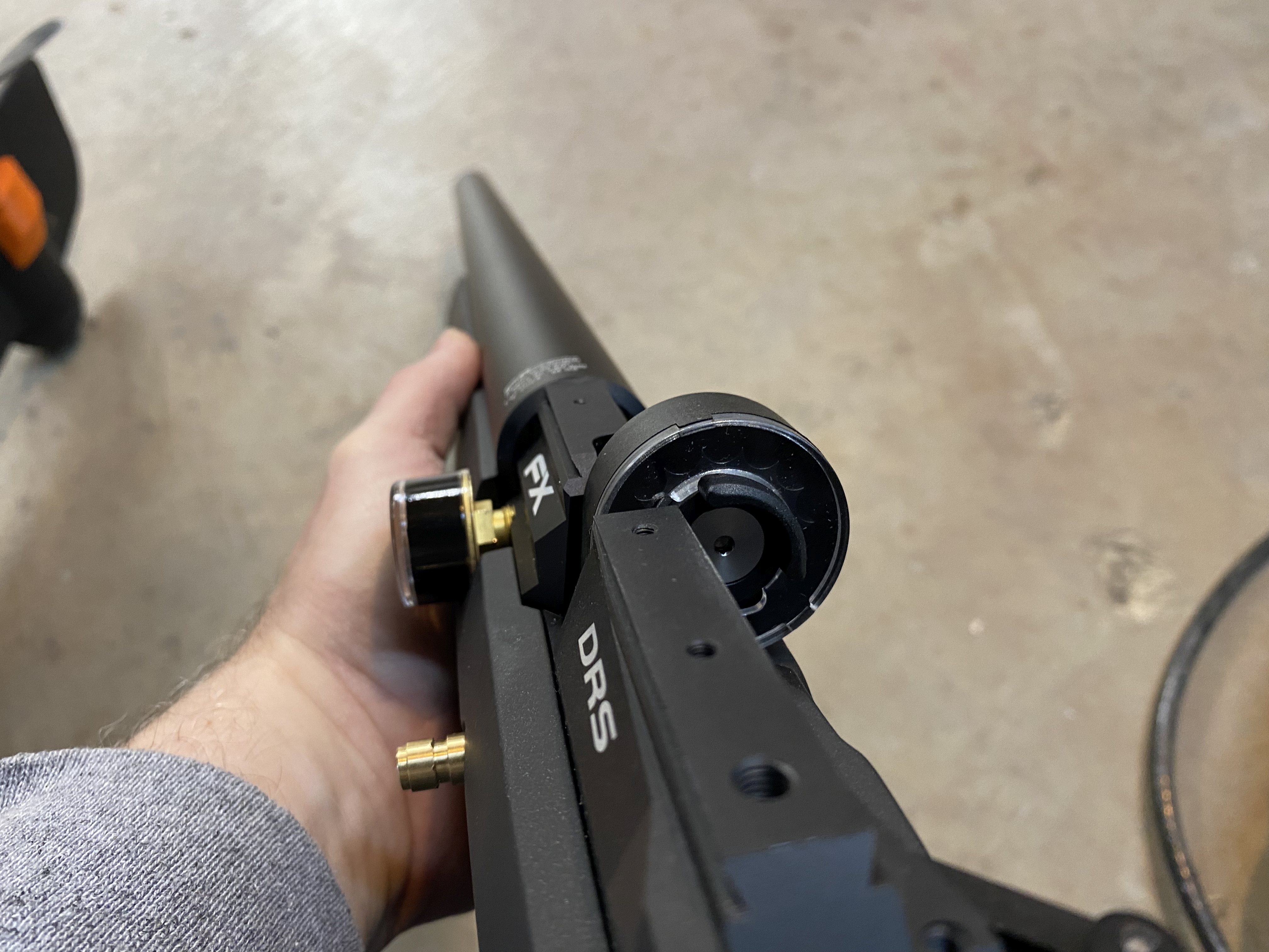

I know my DRS has a very small hole toward the front of the block and an off-set larger grub screw. The small hole doesn't appear to be used in the drawing and I'm not sure what the larger grub screw in the off-set hole does.
On my rifle the forward hole has a set screw installed in it. The two rear 3mm holes are empty. I will have to pull that forward set screw and see what falls apart…lol.
I have no mounted the scope yet. Still sorting out the details using PLA. I will print one in Nylon-CF then mount the scope. Right now the rail is a snug slip fit onto the dovetail on the receiver and doesn't move once in place. I am also waiting for some screws to arrive for mounting.

I tried to remove that small set screw on the top and it wouldn't budge. The two on the side that look like they secure the barre did, but the top one wouldn't budge and I didn't want to force it and possible strip the hex head. I'm interested to see if you can get it out. I'd also like to learn how to remove the barrel. Seems like the gun will need to be completely degassed and the cylinder unscrewed to do it. Which seems like a lot of work if you just want to change the probe.

If the one on top is a barrel retention grub screw, it seems odd it's not identified on the parts drawing like the 2 on the sides.
