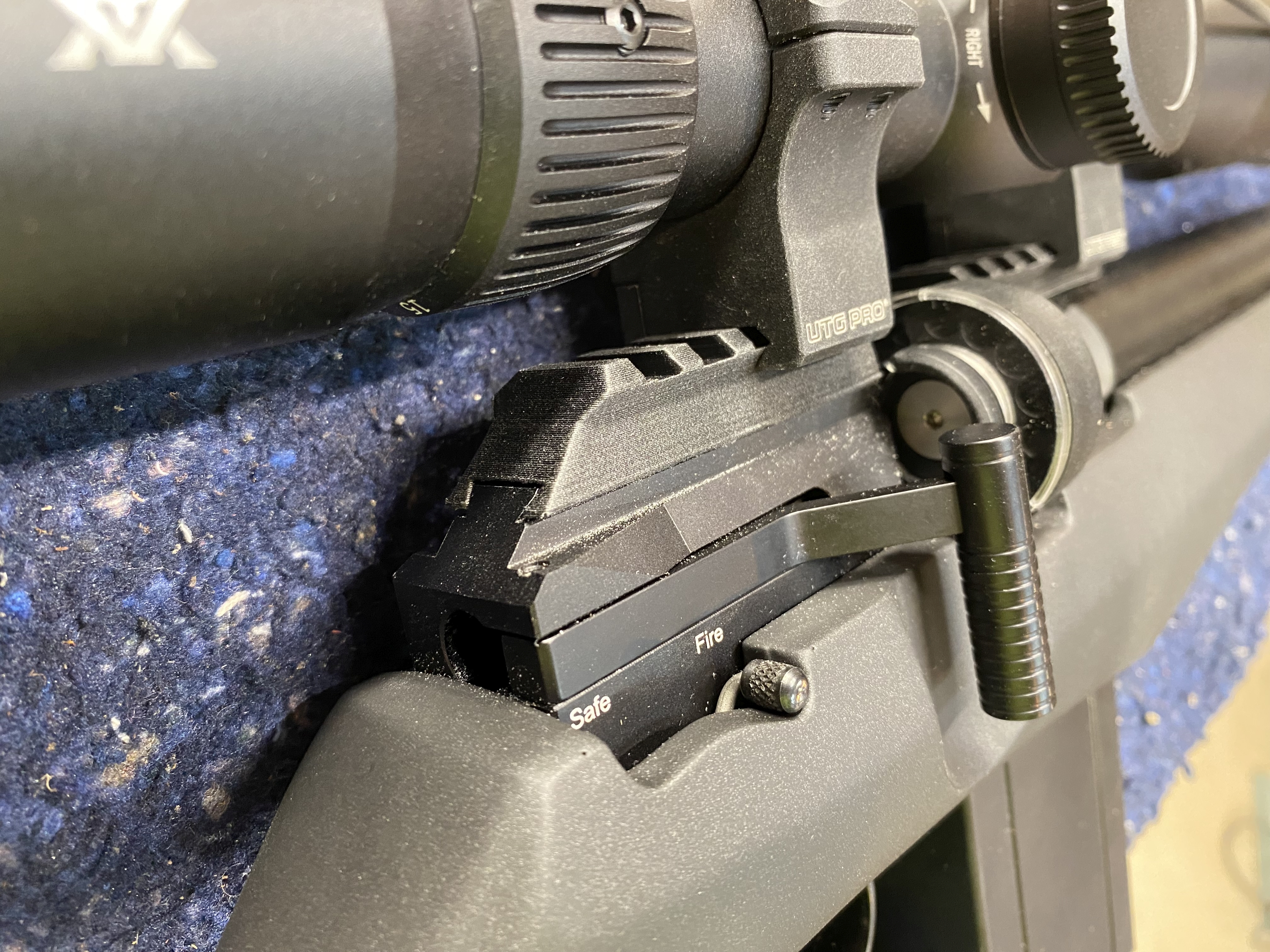

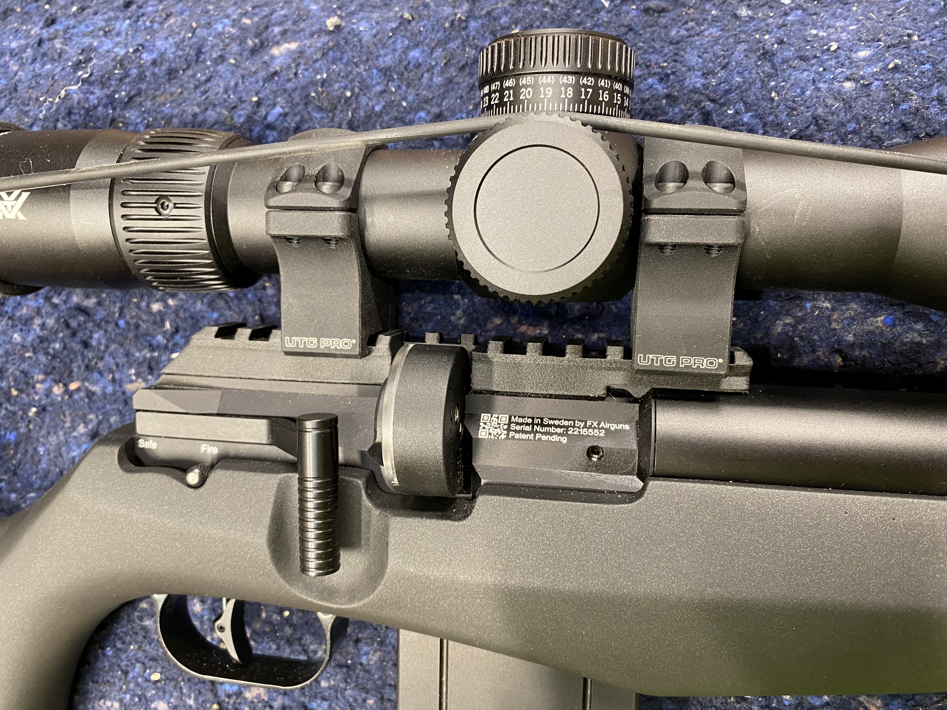

I made some more changes to the shape, and printed in a PA-CF filament. It is good up to the forward cantilevered part over the barrel flexes a bit.
Looks like I will be machining one out of aluminum. Still waiting on M3 screws and I ordered some low scope rings too.
Is there a place to add a screw in front of the mag well? The drawing makes it appear as if there is, but it doesn't look like it has one on the rifle. The rail look awesome! An aluminum rail will probably take care of any flex if the front half can't be secured to the area in front of the mag well.
Yes, I added a mounting hole at that forward M3 set screw location.

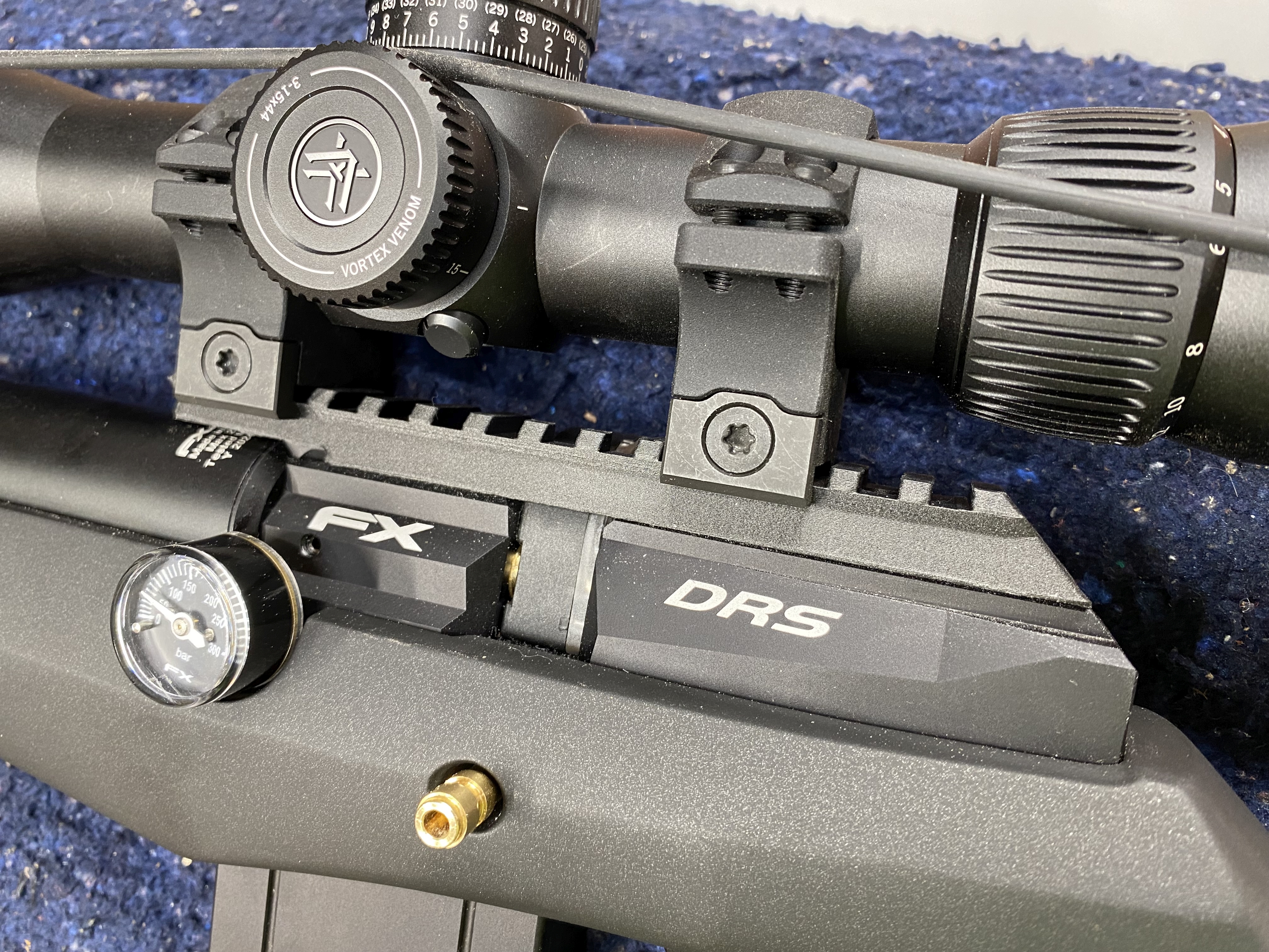

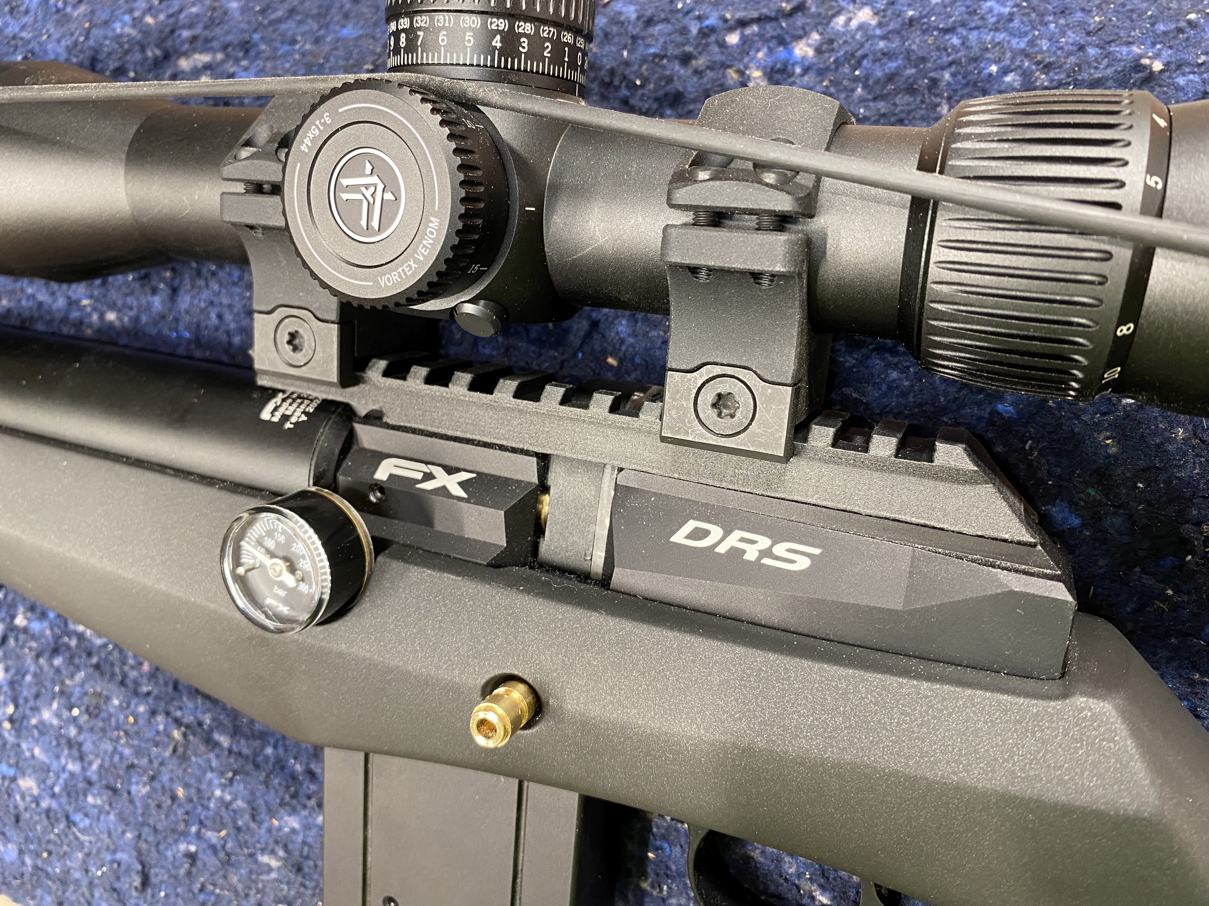

I have a question that I do not believe has been asked.
Is the gauge on the SHP removable?
In other words, could you install the gauge, tune the rifle, then remove the gauge until needed again in the future?
I had to buy the angled manometer bracket to install a gauge.
It does not have to say on the rifle, when I'm done setting up my rifle I will remove the bracket ang gauge.
Which you have to do to put it back in the stock anyway.

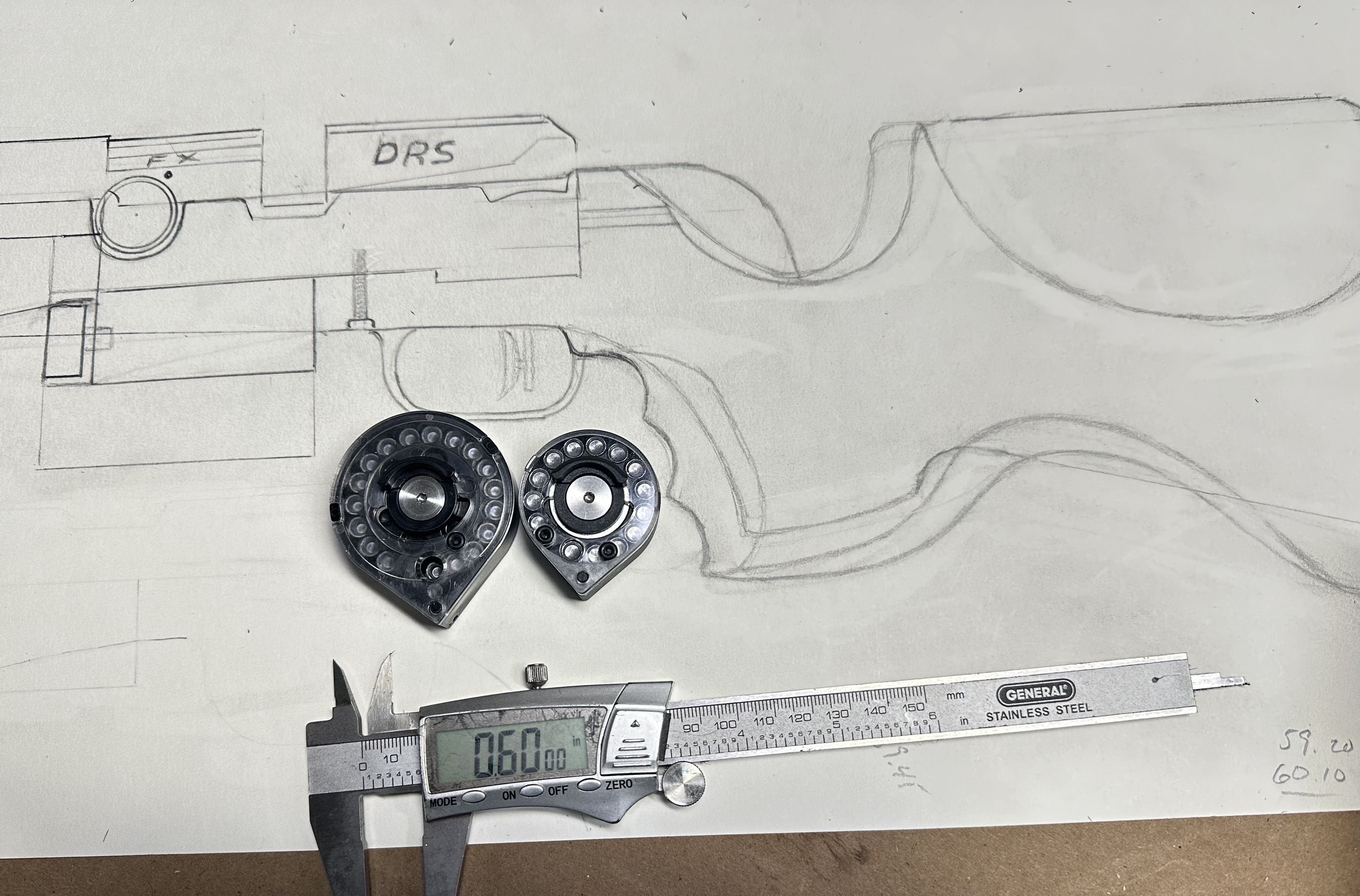

I am going to restock my DRS classic with a wild figured maple stock I have been saving for years for something special. I have the Dreamline GRS and also like the feel of the grip. I have laid out the pattern on a piece of art board in the picture. I’m not going to do the adjustable cheek pad or butt plate but I will make the stock with dimensions that fit me.

I found on mine with 1” high scope rings mounted to the action I had to raise my face slightly to get aligned to the centerline of the scope. You have added at least 1/2” with the picatinny rail . It looks like you can get that 1/2” back with lower rings but you will need to move the scope rearward so the adjustment ring will clear. I’m just bringing it up for those who are getting a DRS so they are aware lower rings are required . If you plan on useing the larger Dreamline, Crown magazine then 1” rings are required and you will loose the eye alignment. It isn’t that much though I am able to raise my face and still have contact but I like a tighter contact of my face to the stock, especially offhand shooting.

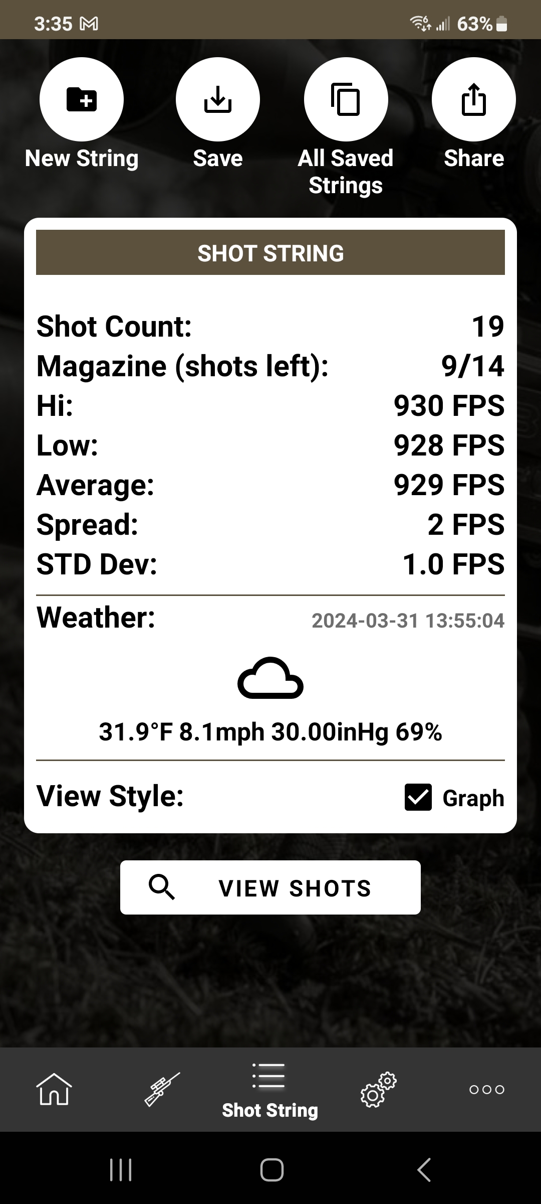

I like mine, mostly. The stock length of pull is about 1 inch to short for me and the forend makes it difficult to put a picatinny mount for a bipod.
The mini magazine is a real pain to load.
These are my only 2 complaints.
My 22 700 is very accurate and very consistent with the H&N 34gr Heavy @930fps.
It easily shoots MOA at 90 yards(thats as far as I can shoot in my yard)
I have not had any POI change so far.
It is just 7 lbs so it's almost ½ the weight of my 13½lbs. M3.
But being only 7lbs it makes it tougher to hold through the shot as it has a bit of recoil.

Only 2 FPS deviation for 19 shots....
Very impressive!
