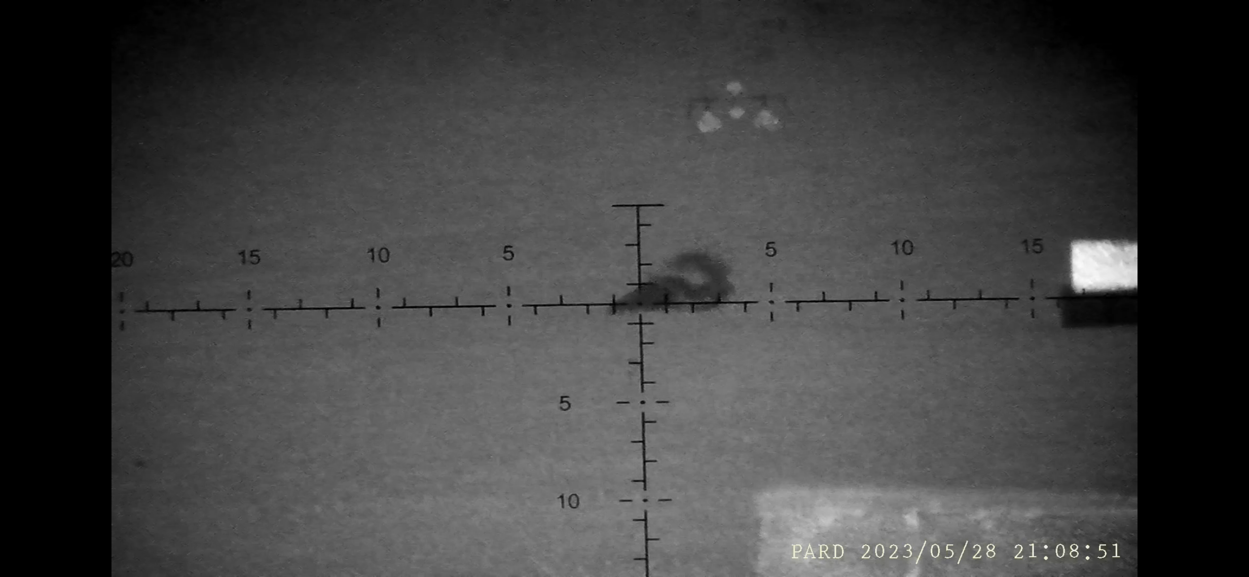

If anyone thinks a clip on is not effective out to and beyond 100 yards, send me your phone number. I got plenty of footage of me dropping critters with my Pards with no help of extra illumination. Here’s a skunk getting rolled at 90 yards with my Pard. Torch is on #1 and it goes up to #3. Those spinners are at 100. Like I said before, some scopes like clip ons, some don’t.
