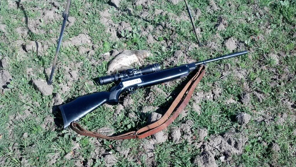

The couple of .20 cal Weihrauchs I've had were good shooters. Still have an R1 (HW80) that shoots well.

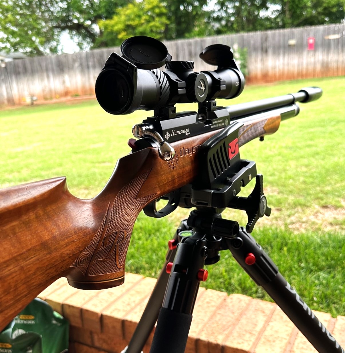

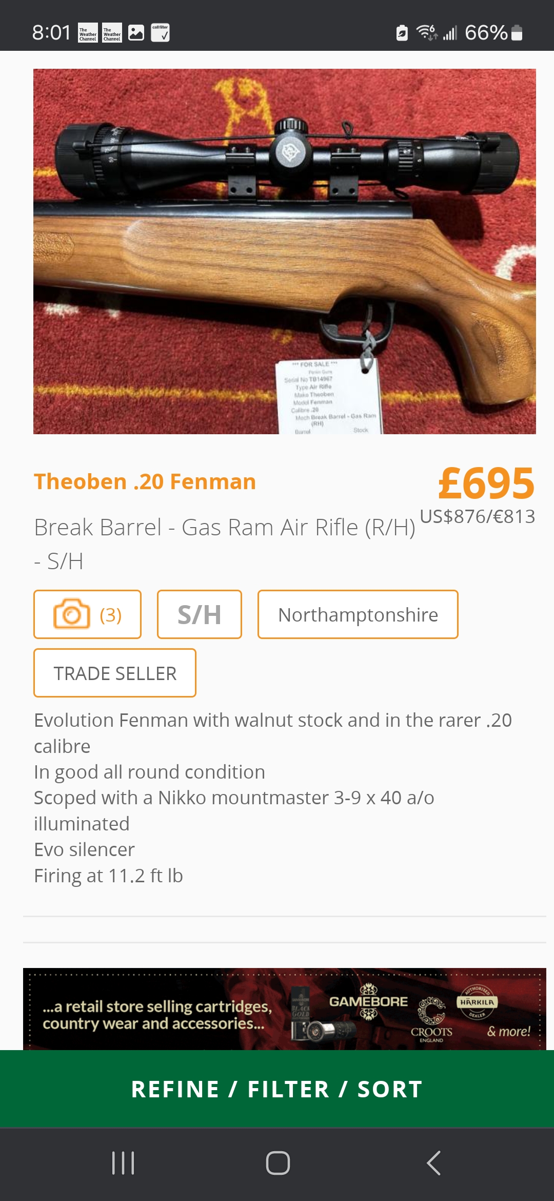

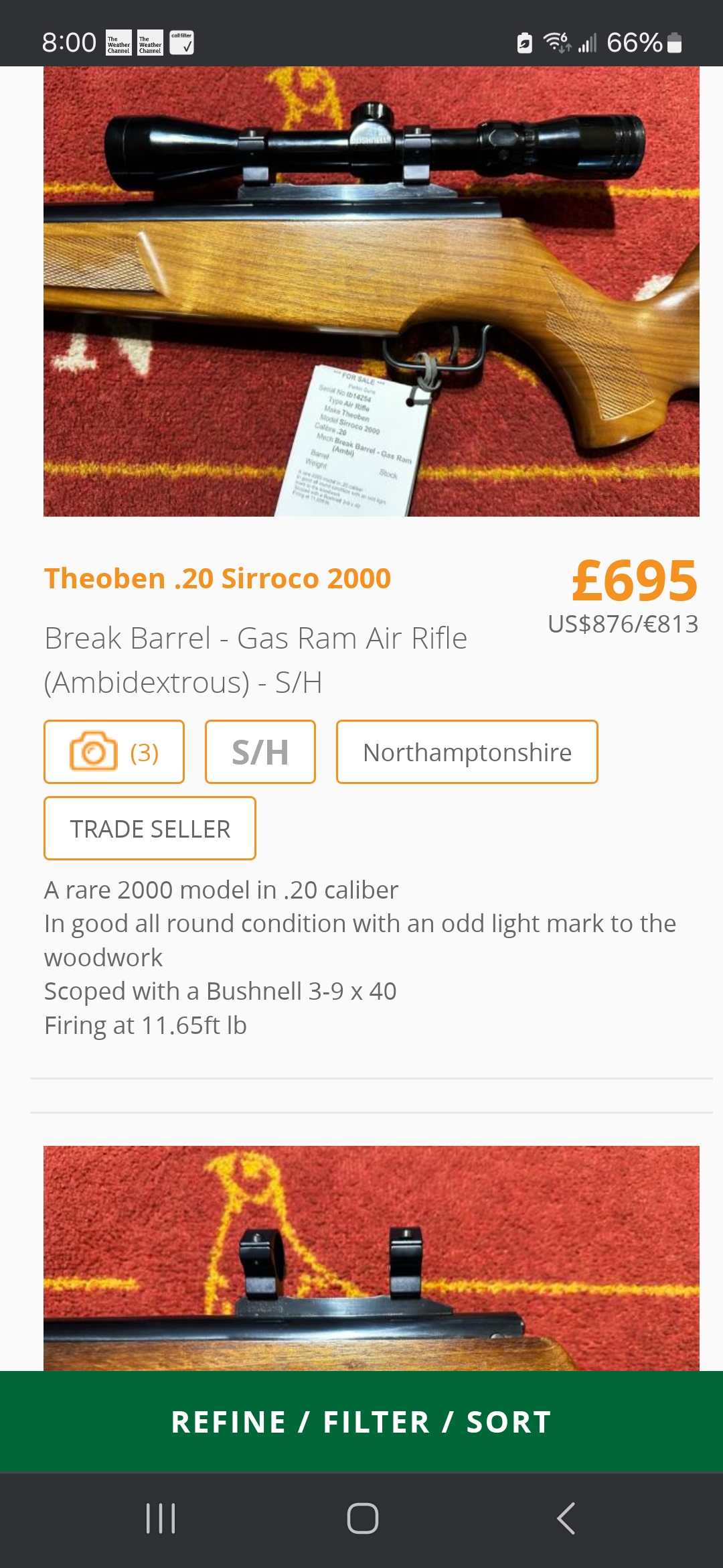

! I see your from London UK. You are in a unique position living where you do....Yes .20 caliber airguns are very poplar with AGN members, myself included, I have a .20 Huntsman and an HW97 .20 with a blue laminate stock also a Theoben Eliminator in .20...love 'em all and always had good luck with H&N 11.42 and JSB 13.73 pellets so no problem there. All that said, as a Theoben collector and advocate TWO Theobens have always eluded me...to this day...being an SLR 88 sporter "AND" a .20 caliber Evolution, Sirocco, or Fenman model...Elinimators and Crusaders in .20 cal are a dime a dozen here in the US comparatively....I honestly don't know ANYONE who has ANY of those Theoben models, except a couple of '88s, even the "ALPHA" collectors on AGN. IF I were you I would click out of here NOW and go to "Guntrader UK and buy BOTH of these Theoben .20s the Sirocco and Fenman....Those are IMPOSSIABLE to fine here....you will be the envy of the springer community here on AGN...OR put 'em in a box and get 'em to me and if you think about it put an SLR 88
in the box too...Not a joke...those guns are HIGHLY HIGHLY prized...I've been looking for all of them for years...and how to get them across the pond...HW97s in .20 are great guns but compared to a Theoben Sirocco in .20 ain't no comparison...

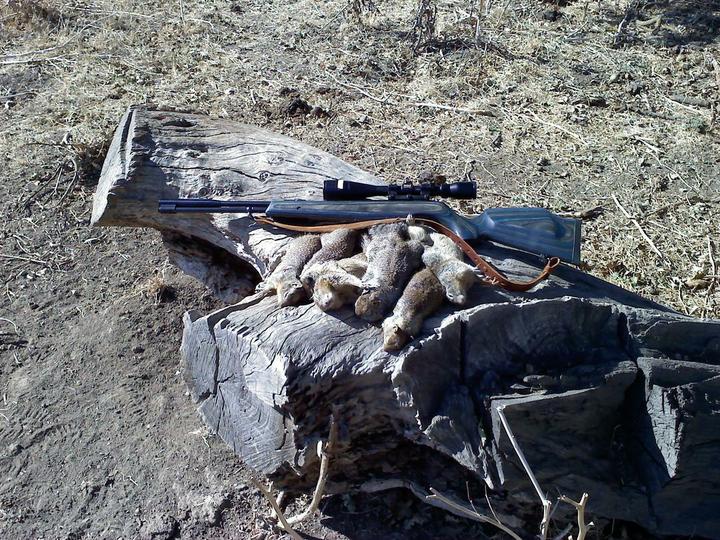

The limited choice of ammo isn’t a problem. Just means less fiddling around testing. When I got my 97k there were only 6 choices available in US. It was pretty obvious which pellet it liked and it shoots great. I think I am running 14-15 ft lbs with JSB 13.73. No need for twenty different pellet choices. Very tight groups at 30 yards and deadly on squirrels. I am very satisfied with mine, and like the extra pellet frontal area of the 20 over the 22, and the flatter trajectory of the 20 over the 22.
My vote would be to go for the 20.
