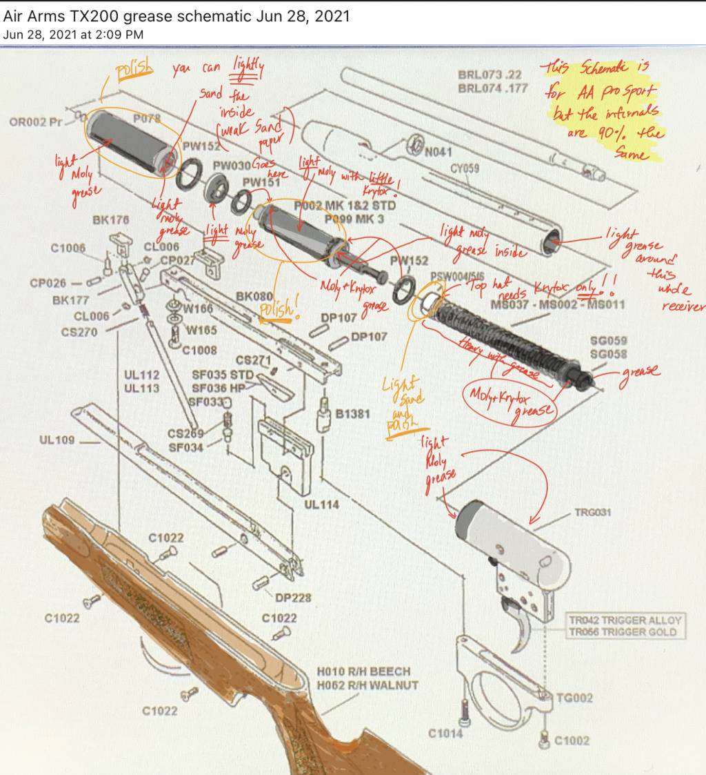

Anyone have a springer this consistent MOOOHAHAHA
How did you tune the TX Mustafamalikza if you don't me asking?
Good question! So as I mentioned earlier, the secret with mine is that I used GPL-205 lube (krytox). It’s just not my sample that was consistent, if you go to the first page and look at @deerstalker’s Weihrauch…you can see the same consistency with his HW95. Before starting, I used a polish to polish the internals specified in the schematic. The polish I used is called “Happich Simichrome Polish.” I used a double grease on the spring; one from V-Mach (moly) and another that I bought which is that GPL-205 (Krytox). I went light with the lube other than the spring which I coated quite heavily with 2 parts mix Krytox and moly applied separately. There is more Krytox applied near the guide rod. Again, you results may differ if you don’t have a v-mach kit. These steps should get you very close to my results even without the V-Mach though.
One thing to consider, is the Krytox doesn't mix and rejects other lubes. It doesn't react with them, it just doesn't mix and basically compromises the other lube.
What was your logic behind adding the moly lube with the Krytox?
The Krytox I purchased is mixed with molybdenum...I don’t see how it would not mix well. Besides as I said, I didn’t actually mix the two together. They were applied separately. I clarified something in my latest forum post. My thought behind the application of the Krytox was that Krytox is a little thicker as a grease. The v-mach grease I have is very smooth (like soft serve ice cream). I thought using a thicker grease (like Krytox) near the parts that seemed loose like the spring guide rod would make for a more smoother action and shooting cycle. This is just a basic idea of what I thought. I could go into more detail, but it’s redundant. Just do it...if the results are unsatisfactory, then lament the frustrations.

Just curious, I've been there and done that. What I found was you can put the grease wherever you want it, and it's just going to go everywhere anyway. It's not going to stay where you put it. It migrates everywhere.
And the krytox that contains moly, is fortified with moly powder, the solids, and not moly grease. Moly grease is moly powder suspended in thick oil, and the oil is what doesn't mix and burns off as dieseling.

Actually with this method, I only have gotten one shot that has dieseled. It’s weird. Works for me though hehe. This is why I thought I would share. Also in my experience, the grease does not displace too much from its original spot (after all when you regrease…the grease is still where ya left it). That Krytox is some tough stuff. I doubt it’ll move anywhere at all. Originally the v-mach I got was from a fellow local shooter from our air rifle club who had put Krytox on the spring guide (it’s delrin I believe)…that sucker wouldn’t budge because the Krytox had become some kind of tough paste. Time will tell I guess. Rifles like these just get better as you shoot it more and more. Thanks for the extra info though. Good stuff!
