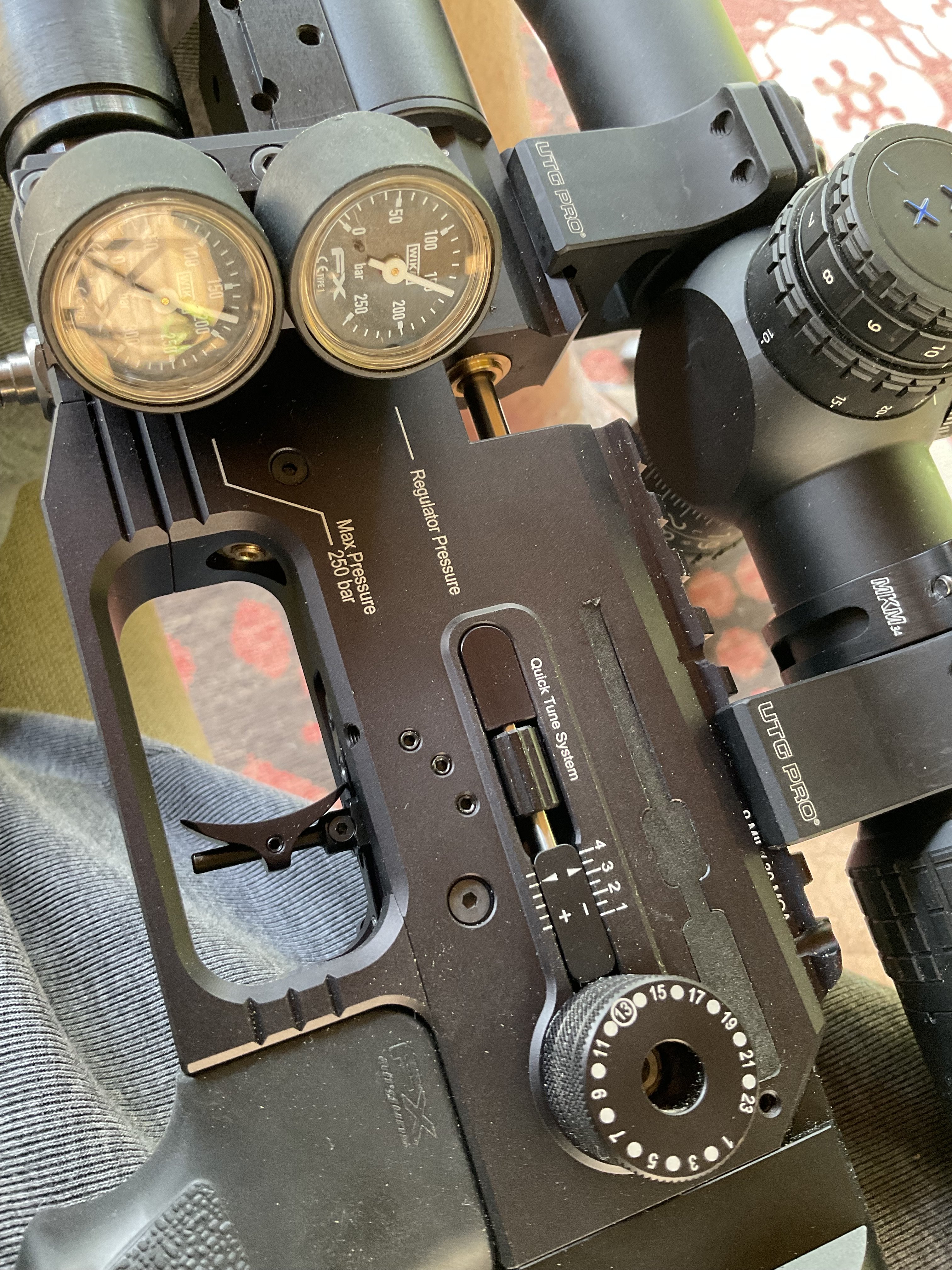

I have been trying to find an tune for .22 JSB MRD pellets in a 500mm Panthera. The barrel is a 1:24 twist standard Superior STX liner and I have the 4mm head 12 g hammer weight. So far I can get pretty good 50yd groups when I get the pellets to fly around 900fps. My problem is that all the tunes I have tried in this speed range either blow lots of excess air (2 magazines per bottle fill), have ES of 40 and SD of 15, or both. When the velocities are much off of 900 the pellets wander all over the place. I tried 880 FPS and got rid of the air consumption issues, but not the inconsistent velocities. The regulator is holding rock steady and I have polished the barrel, the spring ends, the hammer, etc.
Any ideas on what to try? Or should I go back to the 18.1 gr pellets where I can get a good (and accurate) tune at around 880fps? (Want to shoot well in local 100 yd competitions and really don't want to buy a 600mm barrel).
