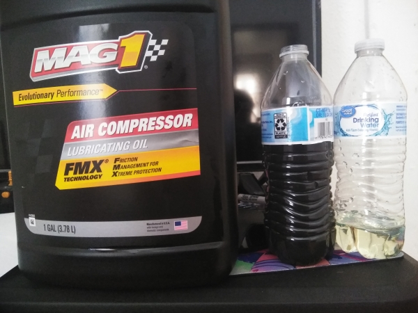

Ok update. I look at the oil and it was really dark. I didn't change the oil yesterday cause in the manual it says first oil change after 20 hours, then every 100 hours. I have a vibrating meter on it and it says 2.3 hours. They say change oil after first 20 hours but how did my oil get so dark in only 2 hours? So I went ahead and change the oil. Turn it on and try filling my tank. It went from 3000 psi to 4495 psi in about 20 mins. Yesterday it wasnt even going past 3000 psi and shake so badly. This time, very little vibration in the cylinder head, but not enough to shake the coil tubings. It barely move. Yesterday, the coil tubing was shaking so badly I thought it gonna break off. If you watch yesterday video and compare to one I will link below you can see a huge difference. i cant believe a oil change make a huge difference. No more bad shaking but still leaking somewhere and I cant find it .damnit. kinda bothers me that a new compressor that cost $1339 is leaking after only 2 hours. When I got it and tested. No leaks at all. Pressure stay the same till I bleed it off. Idk if it's even worth shipping it back to fix the leaking. I cant fix it cause its not like I can just tighten some nuts. It's coming from the cylinder head I believe. Anyone know a different type of oil I should use? I was thinking switching to Royal purple since I hear people having good luck with it in their Yong Heng. Currently using mag1 air compressor oil, iso 100 30w non detergent.
Oil on left, after 2.3 hours. Oil on right, new pour right from the gallon bottle.

that oil looked really bad, I used royal purple in my av and it still looks new at 7 hours run time.

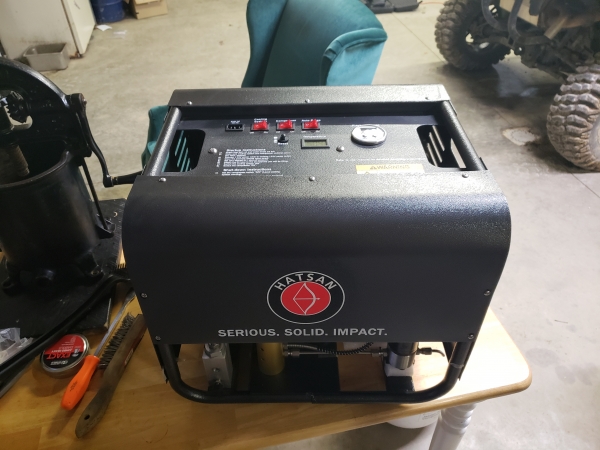

Received mine last week, but I didn't fire up till Tuesday. I did put the purple stuff in it. After break in and 30mins of run time black. Replaced tonight with fresh. Still filling great. I got worried at 126 degrees. I've not seen temps like that yet.
I felt the vibration was bad, but I have it on a steel tool cart. The gold filter is shaking really bad. But nothing like your coils. Wow.
