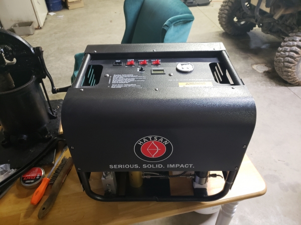

Got mine tonight. Only unboxed it to take a pic. I'll set it up this weekend if I have any free time.
Nice. Hope you have good luck with yours. What oil are you gonna use on it?
Going to use RP and I have good antifreeze from work. Yea I hope I have good luck too. Some of these incidents others have had kinda make me concerned. My Yong Heng blew up a couple months back and I rebuilt it . Now it runs great so at least I have a back up plan.

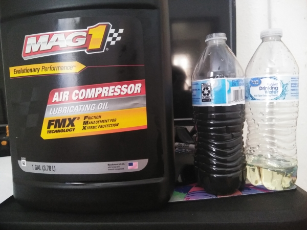

I used mag1 air compressor oil iso 100 30w. This is after 2 hours of run time. It is about same color as if you pour pepsi into a bottle. In the window it looks cloudy greyish. In the manual they say change first oil after 20 hours and like 100 hours after. Idk if they mean just run the oil dirty for that long period or what. Cause they get dark pretty fast. And it's gonna be expensive to keep changing oil after every 30 mins.
left oil after 2 hours. Right new oil
SK, when I was having issues with mine, the one where I opted to send it back for repairs it was blackening the oil really bad. I was even getting oil blow-by into the filter bottom. Glem Chally's thoughts on the oil blacking was possibly due to the oil detonating/combusting which was being caused by my high pressure piston rings failing and allowing the lube oil to be compressed. I was also getting some strange short "knocking" sounds at high pressure. Some of this now contaminated oil probably found it's way back into the crack case as it ran. Every since I replaced the high pressure rings the lube oil (now RP) has been staying a lot cleaner, the knocking has gone away and no oil is making it to the filter.
