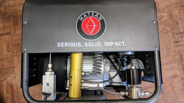

I have just received a unit... Finally.
It is for retail sales in my store in Solvang,CA. May do a quick YouTube.
Just wanted to let people know.
Jim

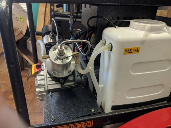

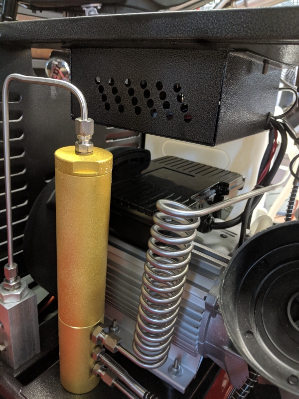

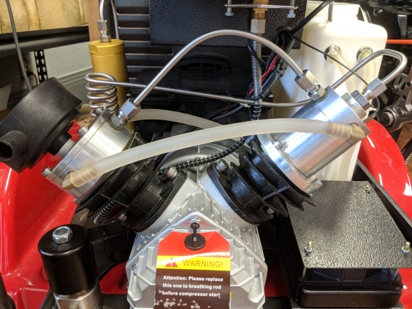

Thanks... Are there cooling coils like that between the first and second stage also? Can you post close up pics like this of the other 3 sides?
From what I remember, the "gold" filter on the Hatsan has a cotton tampon type filter inside. And then they advertise another part with dessicant, but its that outlet block to the left of the golden colored filter, which hold at least 15 to 20 silica dessicant beads. Not enough to make a difference. My Tuxing has that same outlet block and when I opened it up, the silica beads were wet and the insides were already starting to rust. Replaced the silica beads with small cotton tampon filter, much better. I'd still recommend using the "after market gold" filter with this Hatsan for moisture removal.

But mine doesn’t have an auto purge. One thing I think is a bit misleading about the Hatsan is the “dryer” section. It’s the same as the outlet block on the tuxing and Is worthless. There is less than one cubic inch of space for desiccant. So a “gold” filter is still required. The Hatsan does have a good size cotton tampon filter similar to the AV.
