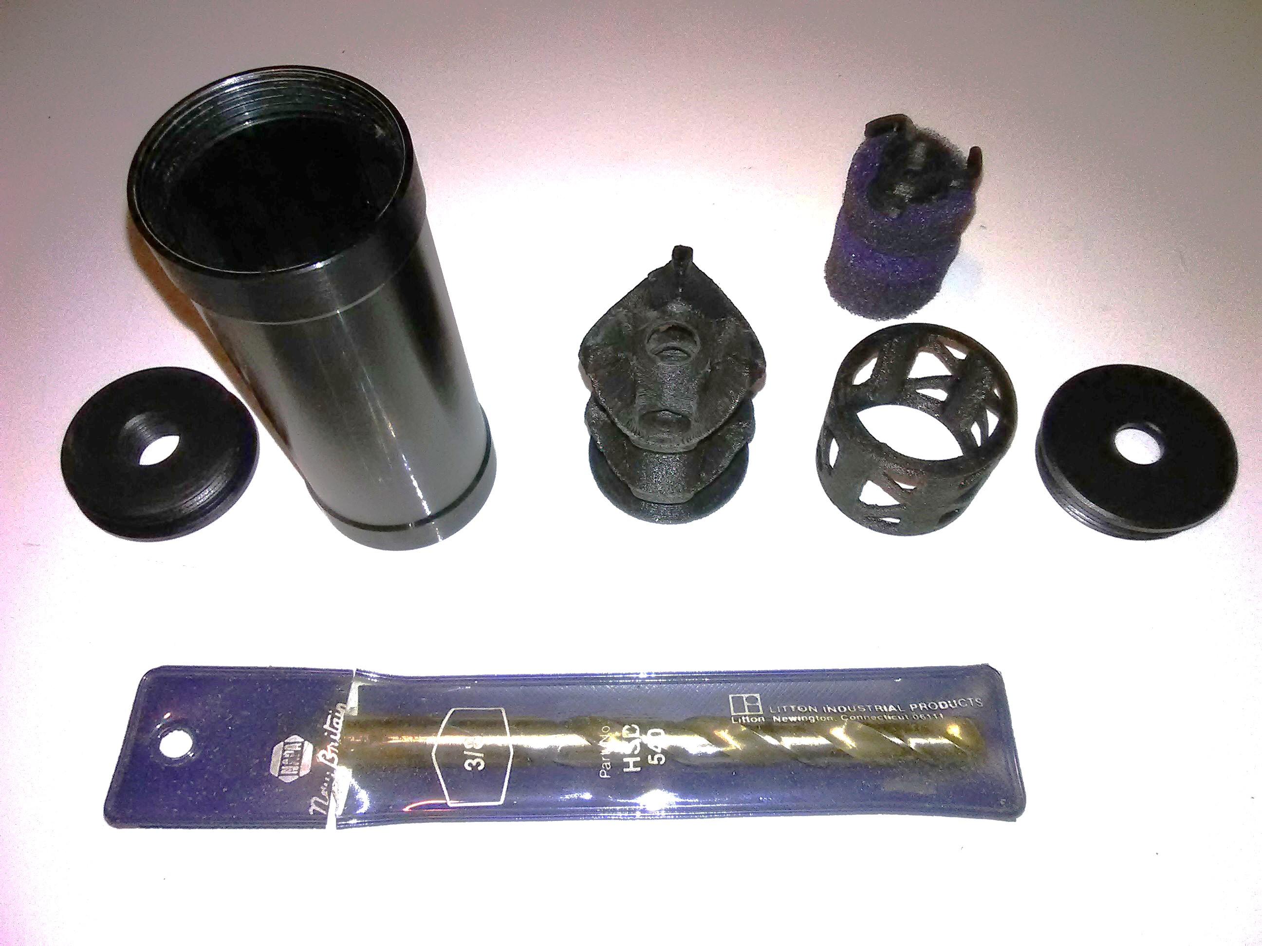

I have been trying to get mine to shoot accurate with a moderator on and I agree with you that its not so much clipping that's causing the accuracy problems. I took a moderator and drilled the hole in it plenty big for the pellet to not touch it when shot. I shined a light in the breech and looked down the muzzle and am sure the pellet had plenty of room. I found a carbon fiber rod that was a little small but all I had and shoved it in the barrel from the muzzle to help check for alignment. Without the mod on its accurate and consistently hits a 1/2 inch dot on a paper plate at 30yds. Put the mod on and I can't even hit the paper plate. So right now I'm thinking something else is going on when a moderator is put on. If I get a chance today I'm going to take the guts out of the mod and see what that does

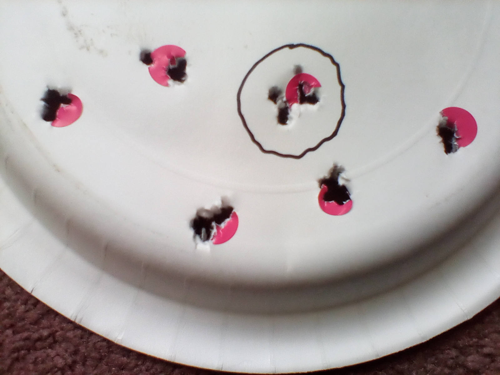

I just come in from working on it and here's the results with a suppressor installed. Its my usual 30yds shooting a paper plate with 1/2" peel and stick dots. The one circled is a 8 shot group and the rest is 5 shot groups. I had to drill the suppressor out to 7/16"

I was also able to fix my rifle's clipping issue to the point of getting consistent grouping. The point I was trying to make is that a person should not have to alter a new rifle as much as is needed with many Airacudas in order to get them to not clip. What's even worse is JTS will not stand behind these faulty rifles and correct them for the buyers.
My Airacuda is going on the consignment rack at the local gun shop and I'll have no worries about JTS products or lack of support.
If yours is fixed to your satisfaction then I hope you have many hours of enjoyment shooting it.
