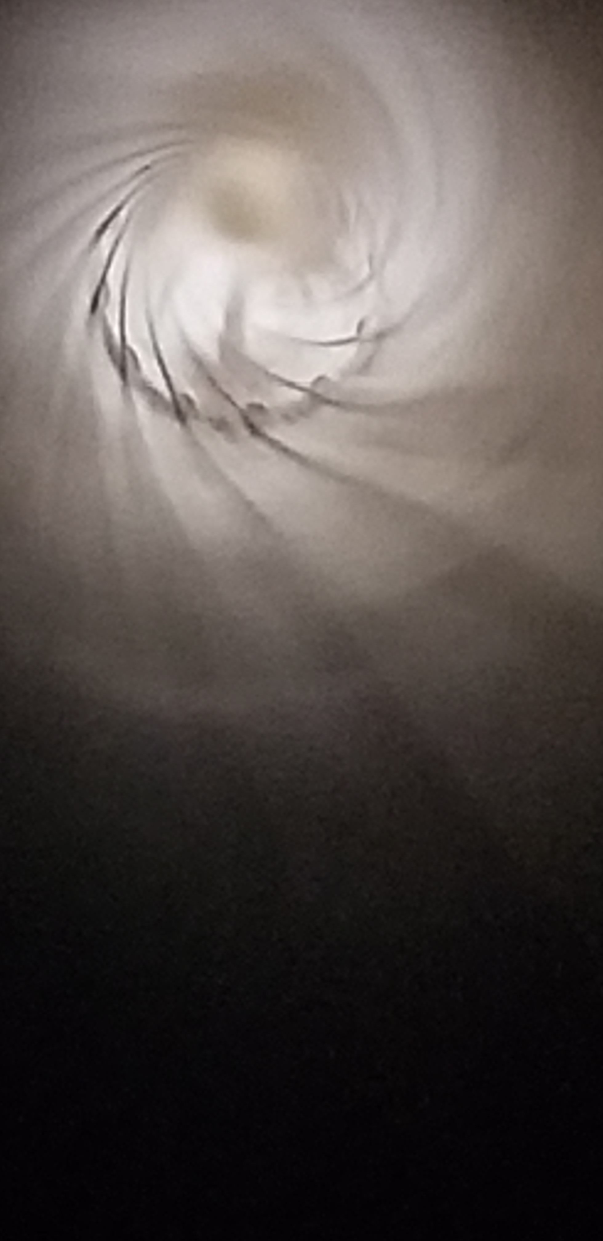

Anyone having a moderator clipping problem on Airacuda Max .30 ?
3 Dec 2023 UPDATE. I received another Max in 30 caliber from Pyramyd Air a few days ago. This replaced my previous three Max, one in each caliber that were clipping moderators due to a manufacturing defect in the air gun not the moderator. This defect has been extensively reported and commented on through most of the appropriate forms. So it's likely my new Max in 30 caliber was from a batch wherein the defect has been corrected. That means that I shot my Airacuda Max in 30 caliber with the Ronan 35 caliber moderator and it did not clip and it shot very accurately and substantially reduced the report.
