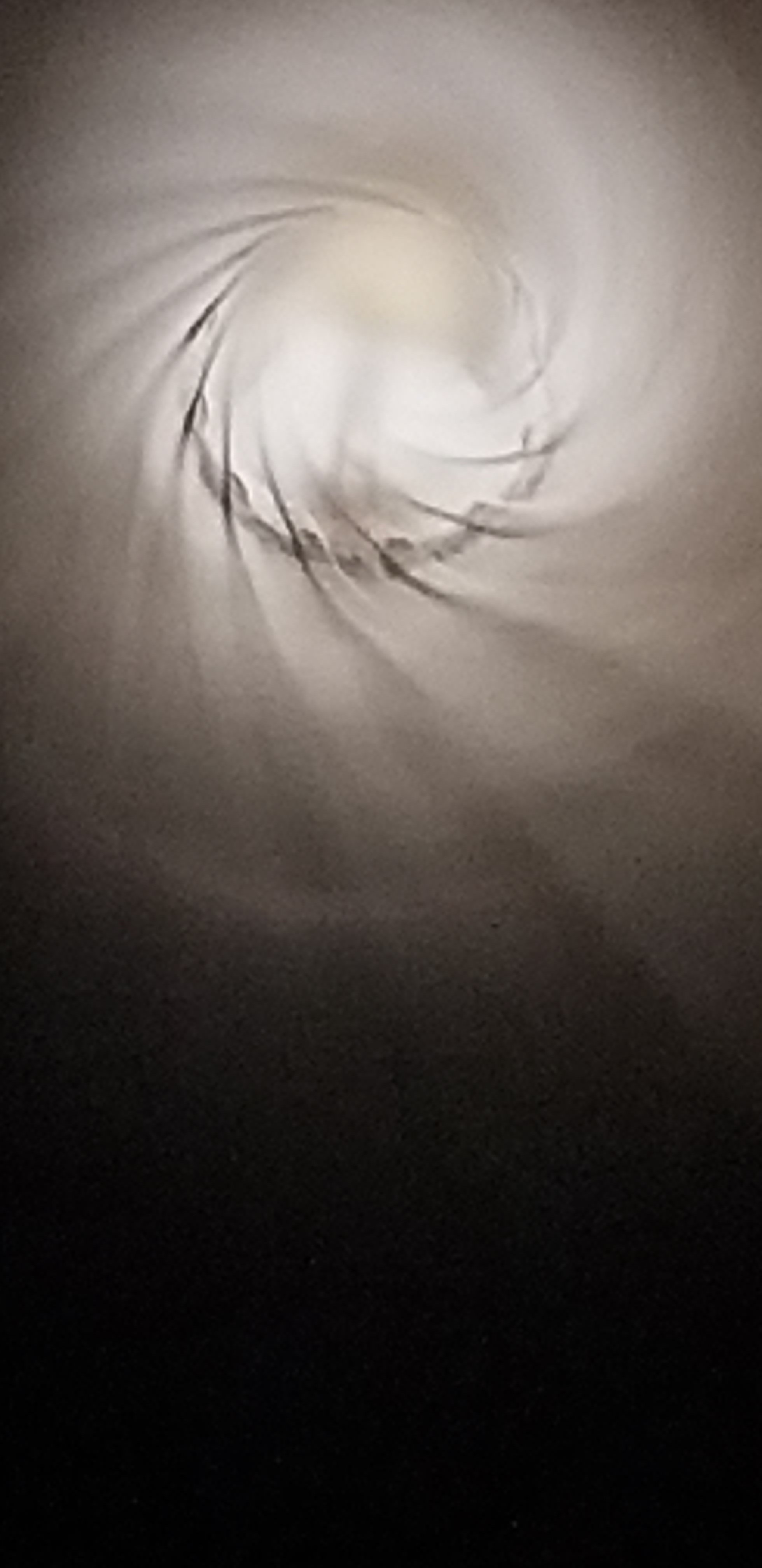

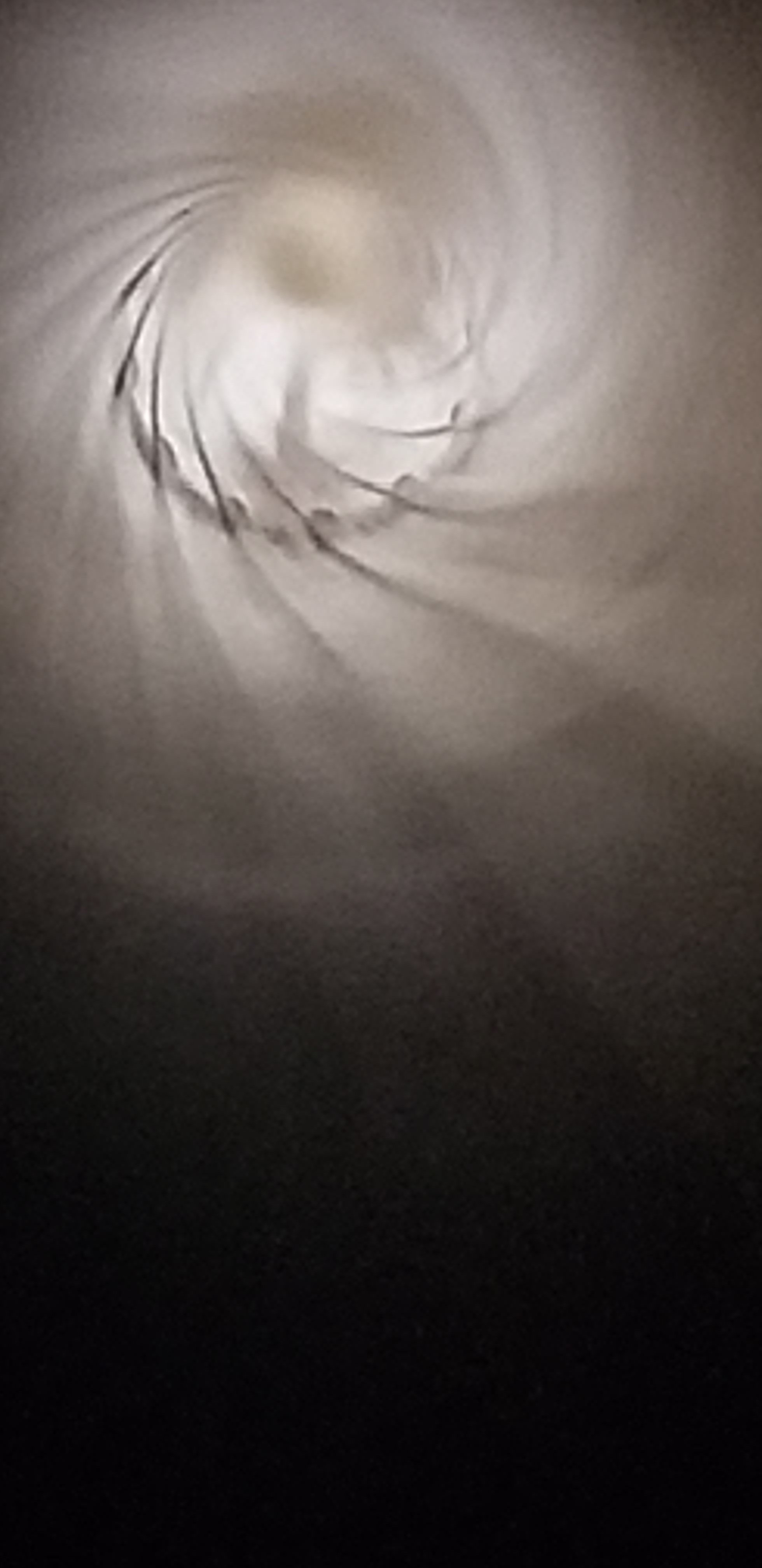

I've had problems getting my 22cal to group so i posted on a airacuda Facebook page looking for answers. I posted pics of my barrel and a rough patch inside it that i have concerns with. Travis whitney commented
"just lap it out".
To me that is the wrong response. He should have said, sent it back and I'll replace the barrel! I shouldn't have to gather up a bunch of tools and products to work on and try to repair a new gun. To me it says alot about what kind of guy travis is. You don't treat your customers this way and you should stand by your products. I will not purchase nor will i refer anyone to purchase any products travis whitney is involved with.
Below are pictures of the rough patch inside the barrel. View attachment 424258
Definately send it back to your dealer or JTS as it is a defect and must (unbder law) be covered by Warranty. The response from Travis is unbelievable ! Who did you buy it from and when?
