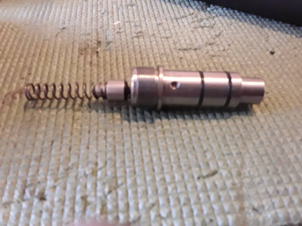

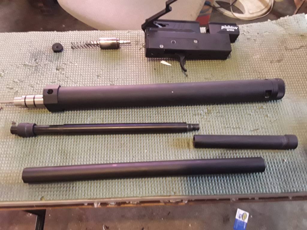

I was unable to get the valve out of the tube block. Figured it must have thread sealant on it. Thought abut adding heat, but that could destroy the poppet. Por in the bbl was a tiny .161 dis. Far too small to pas much air. No wonder thy are off in fps. I opened i up to .187 last night. Poppet stem is FAR too large in dia. Takes up too much room iin the valve body, again choking off flow. I wanted to turn it down, but again, I failed to remove the valve body from it tube.
The bbl shot terrible with both my cast slugs, (Probably too low fps, and poorly wth my cast pellets. The JSB 18 shot OK, but not up to my standards. I wanted oto know why. Well, the bore look like it was soaked in salt water and put away. I have never seen such aj pitted bbl. And the usual circle created wit a poor reem for the crown was very present as well.
The leade was off center, and no bevel into the rifling at all.
I lapped and polished the bore and re-crowned. Well see if it helped in a few minutes.
Now if I can just get the darned valve body off the tube, I can increase the port size and turn down the center section of the poppet stem to be better in allowing air to pass!
I tried to call the company yesterday, but only got "Leave a message" I will try again Monday. Apparently they sent me the gun to find any issues, and since that is what I do, I will follow up.
It is a good looking unit, with nice machining in the mono block. The bbl. apparently got away form the machinist, and it has terrible cuts on the outside Dia. as well. GRRRRRR!!!
I do appreciate the Tensioned bbl. It is very ridged. If a proper bbl. was present, it should preform well.
