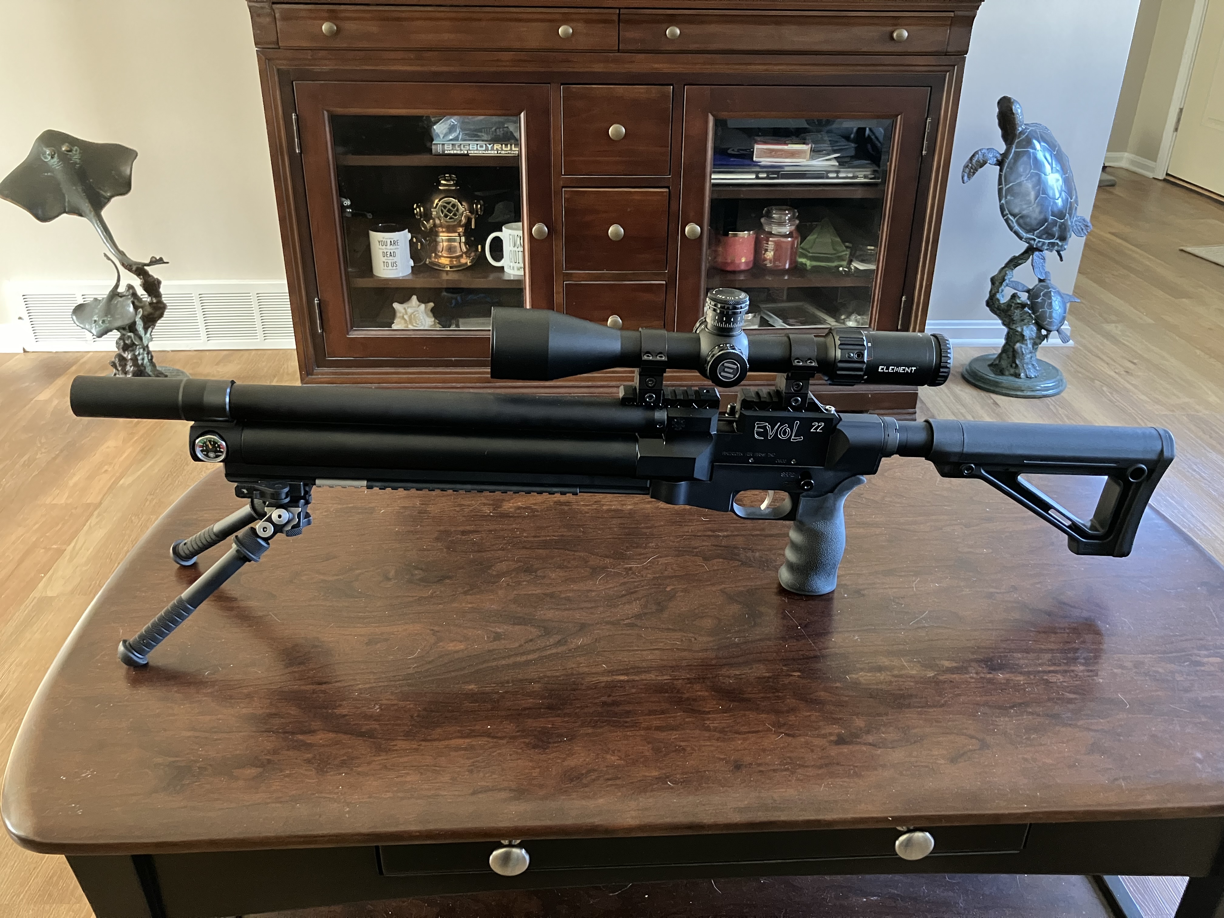

American Air Arms Anyone hunt with slugs in an Evoll .22 with 15” barrel?
Have the .30 and very well built and accurate
I have the Paradigm .30 I pest with but want to pest with the Evol too.
Reactions: madeintheuk
Depends on the barrel. How old is the rifle? There were a few different barrels that were used
I bought it in December from AoA.
Yeah, I meant to mention in OP that I know every barrel id different. I have some polymags with the brass penetrator, hope they might be good but also have some H&N assortment packs that are slugs in various diameters and weight.

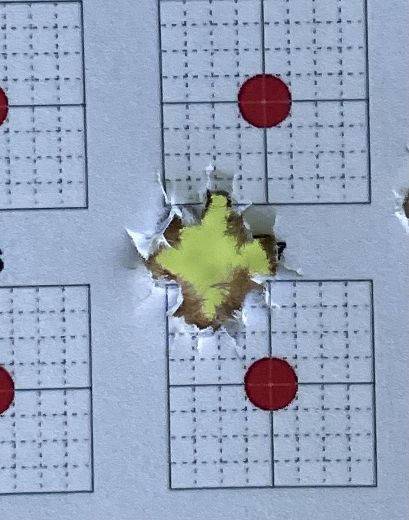

So I tried a variety of brands and weights of slugs and pellets today. I used 30 yards as my initial group testing distance. I also chrono’d them as well.
The most accurate, and if I’m not mistaken, AAA tunes for the same pellet that was most accurate, the JSB Exact Jumbo Monster Redesigned 25.39 grain.
I was getting an average speed of 801.4fps for 36.22 ft lbs.
Fortunately I have about 20 tins of them on the shelf.
