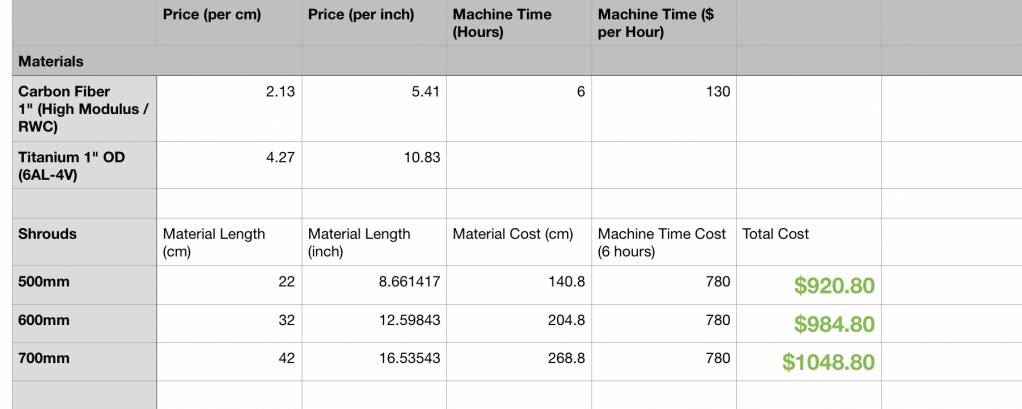

I made a quick and dirty spreadsheet after I machined my CF/Ti shrouds just to get a ballpark of the material and (manual) labor costs. I don't have the actual spreadsheet file on this device, but this was a screenshot that I took with the actual amount of man hours that I spent making an individual shroud and Ti locking ring with my crazy tolerances inside and out:
That was formulated with the costs from about 4 months ago for the professional grade high modulus CF tubing and a 2' rod of 1" OD 6AL-4V Ti (certified material). How's that for sticker shock?! lol
