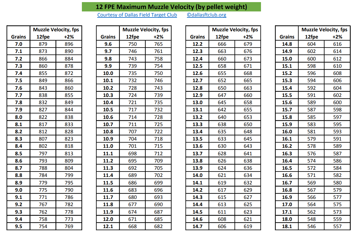

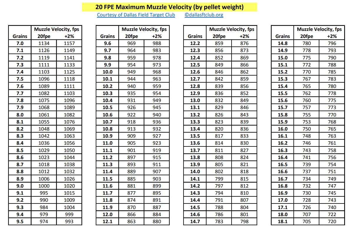

So it's 2% of the velocity, not the fpe, right? Because an 8.44 gr pellet at 800 fps is 11.997 fpe. Give 2% to the velocity and you get 816 fps, which is 12.481 fpe. However, 2% of 12 fpe would be .24, or 808 fps. Do they also give 2% to the pellet weight due to variations in "calibrated" scales?
Actually, I did the math and adding 2% to a 8.44 gr pellet has very little effect on the fpe.
Note: These are just math questions, not ethical questions.
As I understand it; it’s +2% of the velocity.
That's very tight. Like, a damaged pellet + chronograph variance could easily exceed that.

You are correct that a damaged pellet or chronograph variance could cause your velocity to exceed the 2% limit. As a shooter and knowing the rules, it is best to plan for this and allow some margin to the max limit, and make sure you don't shoot discrepant pellets over a chronograph. The 2% allowance is in place to accommodate those kinds of variances from shooters; AAFTA realized the issues and granted some tolerance. Most match directors are open to listening to your specific issues with why you are over the limit +2%, but as a competitor you are responsible to be within the rules that are established for all.
In my opinion the variance isn't there for the gamblers or to make it easier for cheaters, but it's there b/c there truly is variation from one chrono to the next. I saw the same gun (consistent and dependable match-winning gun) show three different fps values from three different chronos one time, back to back to back. One of them put the gun JUUUUSSSTTTTT barely legal, with 10.34s at 934. Another showed 915, and the third had it in the 898 range. This gun never has a 35+fps spread over the whole fill, much less over a handful of shots taken right after each other. My point? Different chronos display different values.
Whoever was on the BOG at the time this was added into the rulebook must have thought that getting DQ'd b/c the testing chrono at a match reads 20-30fps faster than a shooters personal chrono is a sorry reason to get DQ'd. I agree with that. (edit: this is why it's a smart idea to be 15-25fps less than max legal, per home/personal chrono).

There is still an absolute cutoff, it is just 2% higher than the stated maximums for the classes. You can still be DQ'ed for being over. Do you think some people will set their guns to 925-930 fps with the 10.34 pellets? I bet they will.
Absolutely agree with setting up the gun with a healthy safety margin. I keep mine a good 25 fps lower than the maximum and never have an issue.

2% allowance for variation is reasonable, in my opinion. That 2% should keep a guy under the limit from being disqualified, even if they're just barely under. But somebody up around 22 or more fpe (not even trying to play within the rules) is gonna get the big ole DQ, as they should.
For example, 933fps with 10.34s is 19.99fpe. 2% of 933 is 18.7fps, putting the limit to almost 952. If a guy is trying to get away with a gun shooting faster than 950 with 10.34s.....well there's a problem.
