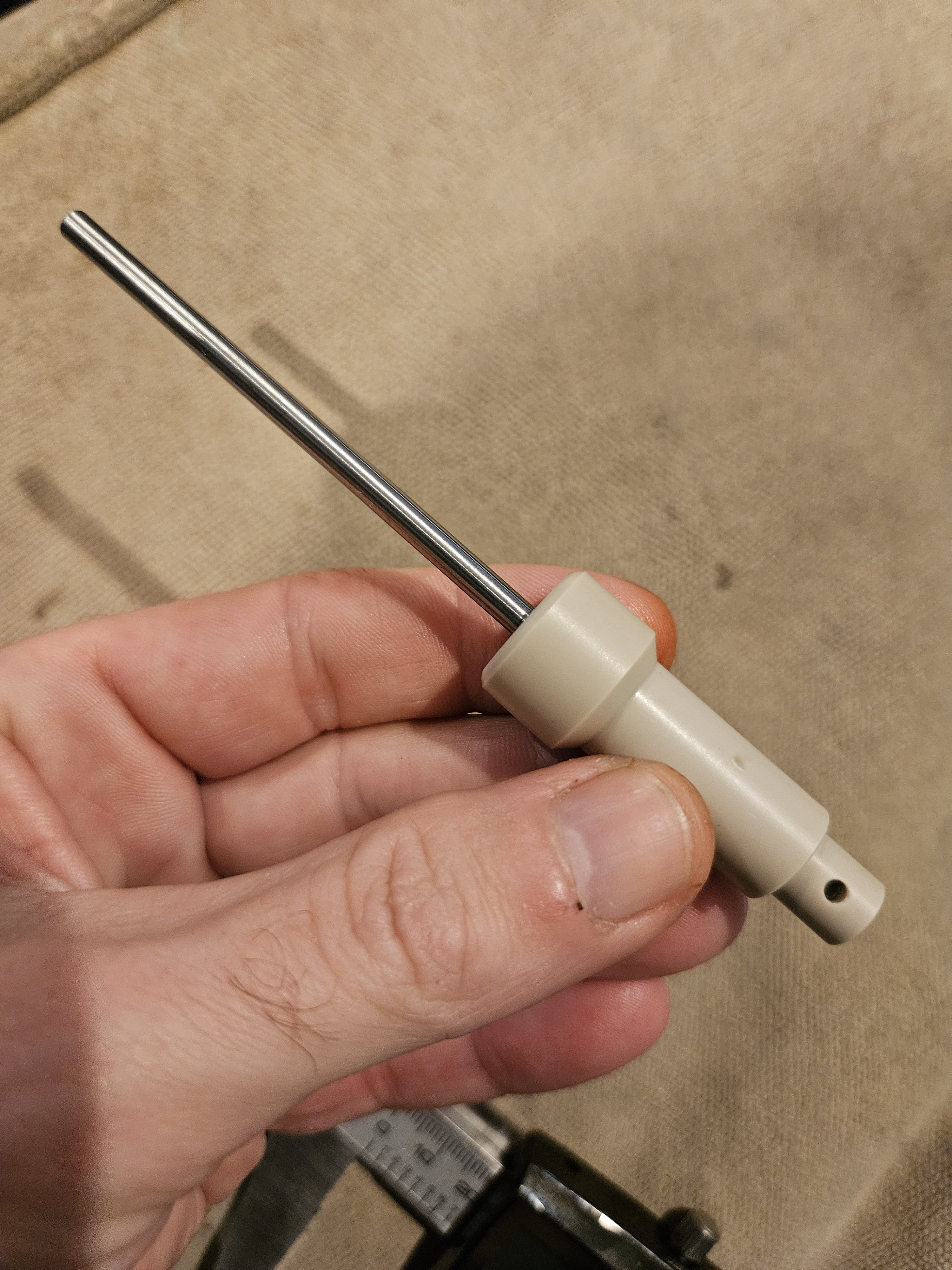

AEA Anyone machine an AEA Zeus 72 cal. poppet valve?
Zeus pin dimensions, it's massive!
120.93mm overall length
17.53mm wide 13.69mm long for the face that the metal pin extends out of, that face has the 4 holes in it.
25mm long 12.98mm wide for the middle of the body
9.61mm long and 9mm wide for the end of the poppet body, this post has 1 hole on each side and 1 hole in the end.
