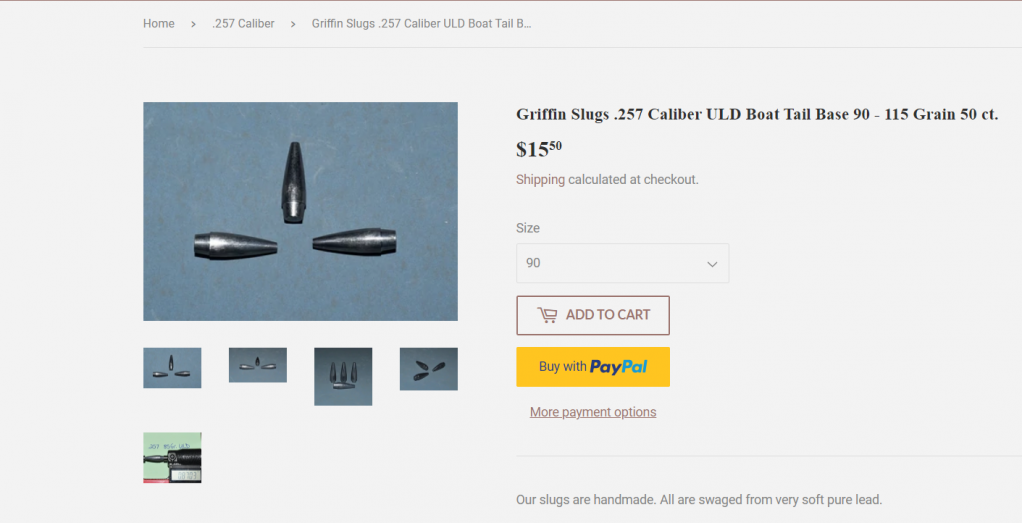

Griffin slug also makes some GNARLY boat tails in .257. at 90-115gr. Below is a picture of them:

I dont think 1:14 257 texan is enough to balance 90gr BT.. FB yes but BT bullets tend to require more spin to be on balance.. so 90-115gr bt bullets are completely useless unless you wish to obtain custom barrel.
You're correct. The website says it will require a 1:12 twist. I didn't even notice that until you responded.
