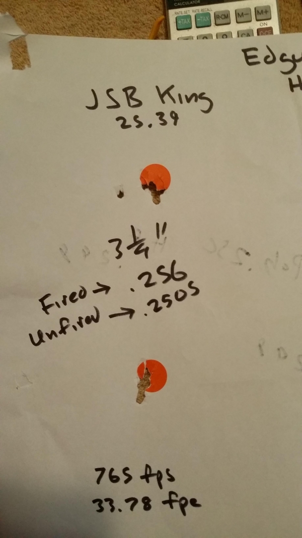

I am going through all my pellets tested for accuracy and measuring the head sizes and then seeing how easily they seat into the breech. Since as mentioned the larger the head size with no barrel lead the greater the chance to load the pellet in crooked. That certainly would be one aspect that would affect accuracy. I have found that the JSB's in .22 cal. seem to have smaller head sizes and while the .25 cal. are about the same range of other brand pellets the JSB's are made of softer lead, making them easier to load in straight. I will say since I have started testing my .22 cal. barrel it is much easier to load pellets into the breech than the .25 caliber. While in my video at 72 yards the groups are nothing to write home about I do get good groups at 50 yards. I get groups in the range of 1/2" to 1" with my better shooting pellets. Here is a picture two five shot groups with the JSB Kings .25 cal. at 50 yards. That day I was testing pellet head expansion and penetration in to clay at 50 Yards. Anyway I plan to try sizing and see if it reaps any good results. Bill
