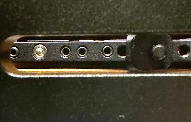

Anyone adjust their M4 Quick Set Trigger (QST)? I have watched the FX video on making the various adjustments, but found it's lacking one pretty important point...
In the video it appears you move one grub screw to two different locations ignorer to change from the Standard to either the Match or Hunting trigger positions. In the video, there is only one grub screw shown and it's removed from one position and installed in another, depending upon which trigger configuration you want. My confusion stems from the fact my M4 trigger has a grub screw installed in both the Standard and Match position. Do I remove one? Do I just back one off and adjust the other inward? It's my understanding the M4 comes with the trigger in the Standard configuration from the factor, but is it? I really think FX needs to be a little more clear on what sub screws should be where and if they are all needed or not! At this point, I'm not wanting to touch it because I don't want to mess it up!
Another adjustment I'd love to make it moving the trigger shoe forward a bit so it fit me better, but for the life of me, I con't get that screw to move! I've tried applying heat to see if it might have Loctite applied, but that's not working either. These grub screws are too small and easy to strip, I'm afraid to apply too much pressure. Anyone else experience this?
Well, based on the responses, I'm guessing no one has! I pulled the trigger today and discovered one grub screw was shorter than the other. The long one activated the different trigger configurations. So, I swapped them, putting the longer one in the Match Grade Trigger position and the shorter one in the Standard Trigger position. All I can say is WOW! It really does make a difference!
I still can't get the screw loose that allows the trigger post to move front to back, I've tried heat, cold and penetrating oil, nothing is working! I'm not sure what to try next, I can already tell the tiny little hex head is starting to round and I sure don't want to strip it out!

Thank you Randall! What is this "creeping oil" you speak of? I did give it a blast of penetrating oil, but that didn't seem to phase it! I'm about to reach out to FX and request a replacement. Seems to me if they advertise the trigger as being adjustable from front to rear, and it doesn't move because the screw won't loosen, then it must be defective! :unsure:
I used Kroil, which says it creeps, and tried the soldering iron. No luck! I contacted The Pellet Shop about a possible Warranty claim since it's not adjustable if you can't get the screw loose. They referred me to Utah Air. They also recommended using MIP Hex drivers, saying they are more precise. I ordered a set of 3 from Amazon, they are supposed to arrive tomorrow. I figure I'd give those a try first and if that doesn't work, I'll reach out to UA and see if I get any help.
I hope those new hex fit and give you a tighter fit! 🙏
The MIP driver set arrived today, and it worked! Amazing what a difference a quality tool makes! I now have the trigger moved slightly forward and it feels so much better!

I have not delved into it that far, yet. There are adjustments for both the 1st and 2nd stages, but I have not touched them to see how they affect it. Thus far I have only swapped the grub screws that change it from the standard configuration to the match configuration and adjusted the trigger post forward about a ¼".

I'm in the same predicament... trying to learn how to adjust the QST. Have you had success with your adjustments?
My M4 also has 4 set screws, labeled 2 Break Point Position, 3 Break Point Resistance - Soft (match) and 4 Break Point Resistance - Medium in the user manual. Position 5, Break Point Resistance - Hard (hunter mode) is open. The video only shows set screws 2 and 3 inserted.
It appears from your posts that one should only use one set screw in either positions 3, 4 or 5 depending on the resistance level you desire and leave the other two open... or back out the unused set screw to where it is inneffective. I'm going to try that with all 3 positions to see what difference it makes.
I did take my trigger out to examine and make the change. I was pretty straight forward and easy. If I recall correctly, one of those grub screws is longer than the others, you just move the long one to the position you want. I just eyeballed how far the long one was screwed in and put it at the same depth in the match position. It made a pretty significant difference without having to touch any other adjustment.
