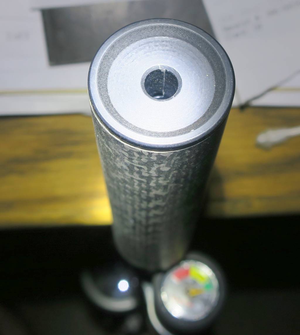

Was out shooting my Daystate Huntsman Regal XL yesterday. Bought it new from Airguns of Arizona, but hadn't shot it much yet.

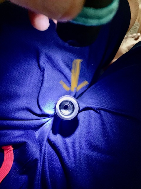

Was getting flyers, 1/2-1" from the group, mostly around 10:00. Checked moderator and saw this:
Sent pic to AOA and they essentially replied 'Yup, you've got clipping and the moderator needs to be milled out a bit.' Led me to believe that it was not a warranty issue even though the gun is less than 2 months old.

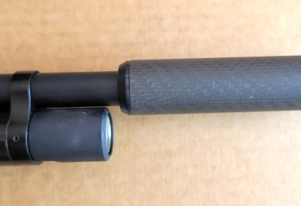

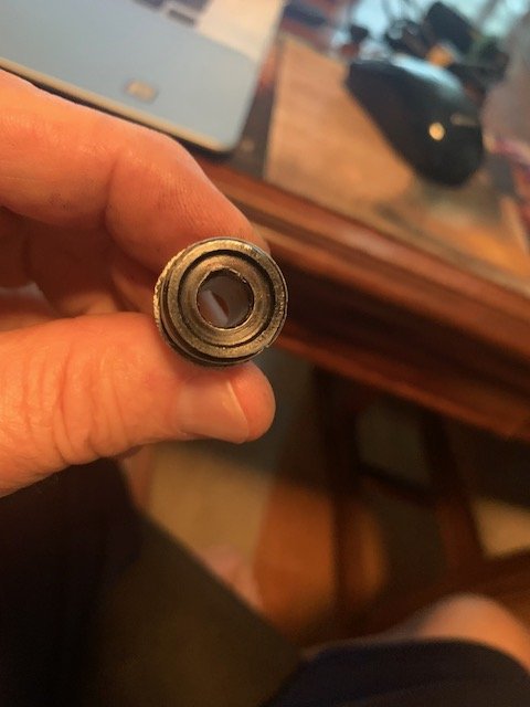

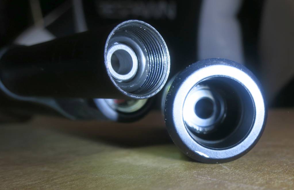

So I heated it up, and was able to unscrew it. Pics below of moderator in place, and removed:
So this was not what I was expecting to find. I thought that the shroud would terminate in a 1/2x20 male fitting. Do I need to take the moderator apart to get what I need in order to attach a larger caliber Donny? Anyone done this before, and have any hints? Or was AOA incorrect in telling me that a standard 1/2x20 fitting was available under the Huntsman moderator?
Any help appreciated!
Wrong part unscrewed off. It took off the factory 1/2unfx20 threaded adaptor from the shroud!
You need to red locktite it back on and let it set for a day then unscrew the Airstream LDC off of that. That part remains permanent to the shroud. You want it that way or else you will forever unscrew it completely off again with your new LDC if you don't permanently red locktite it.
Reactions: dgeesaman
It looks like you have unscrewed the moderator body, but the base still needs to be unscrewed from the barrel, which is where the heat is needed. I would recommend against using any type of thread locking compound anywhere, it's not needed.
Apply heat to the base until it frees from the barrel. This takes rather high heat. I recently needed to unscrew the moderator from my HW100, and it took serious heat from a torch.

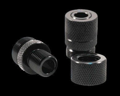

I think I will be good with the DonnyFL adapter.

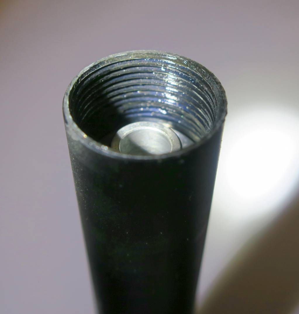

The shroud actually has internal threads:
The DFL adapter looks like it will fit right into these threads and give me the mount point I need:

I hadn't known that DonnyFL made a Huntsman adapter until it was pointed out in the linked thread.

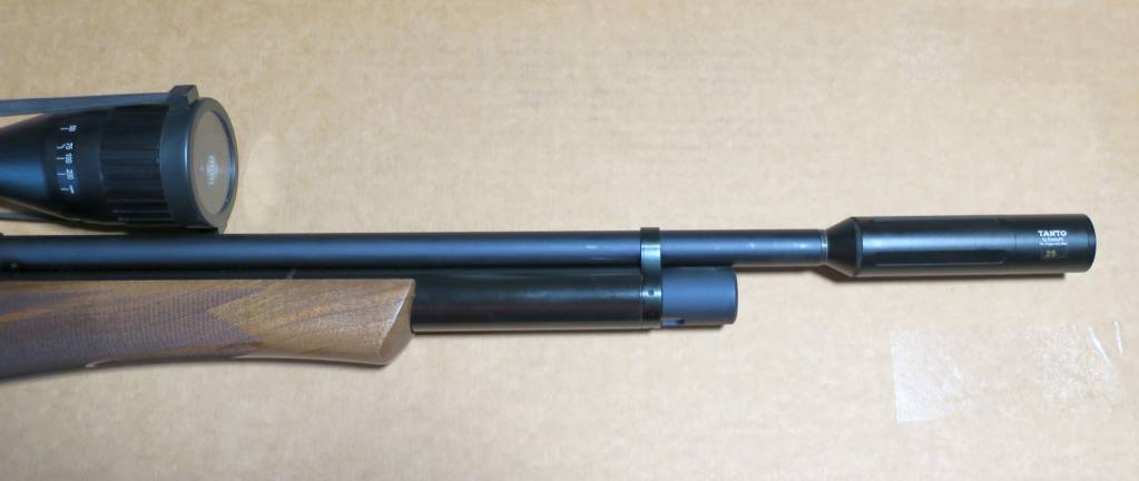

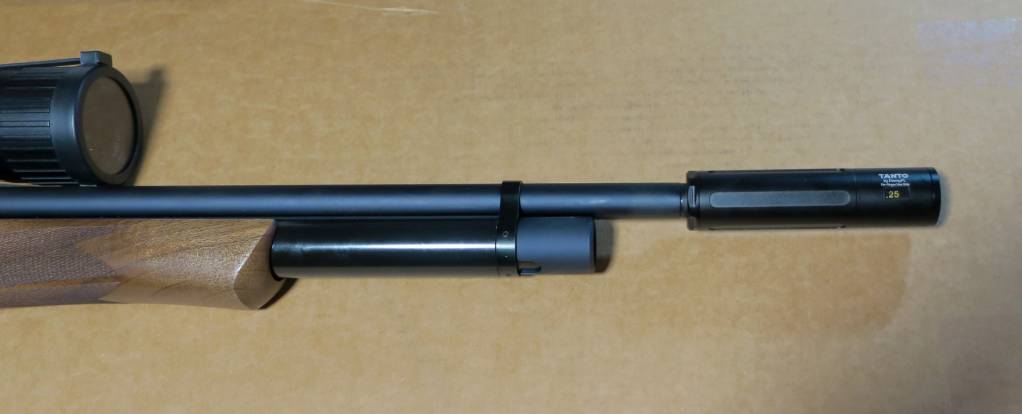

So here is the business end of a Huntsman Regal wearing a Tanto instead instead of the OEM Daystate 'Clipper'. Note the caliber of the Tanto. Now I get to shoot the gun tomorrow... and decide whether I need to go to one of my .30 sized moderators.😉
Hooray - No more clipping/flyers! Now I get to (have to) own all stray shots and can't blame the gun any more. Also found out this morning that it likes Daystate Sovereigns (8.44 gr) which is great since I have a bunch of those. I have new love for my Huntsman! Although not loud with the .25 Tanto, next is to try a .22 Tanto and see if there is any clipping. Gun is .177 cal.

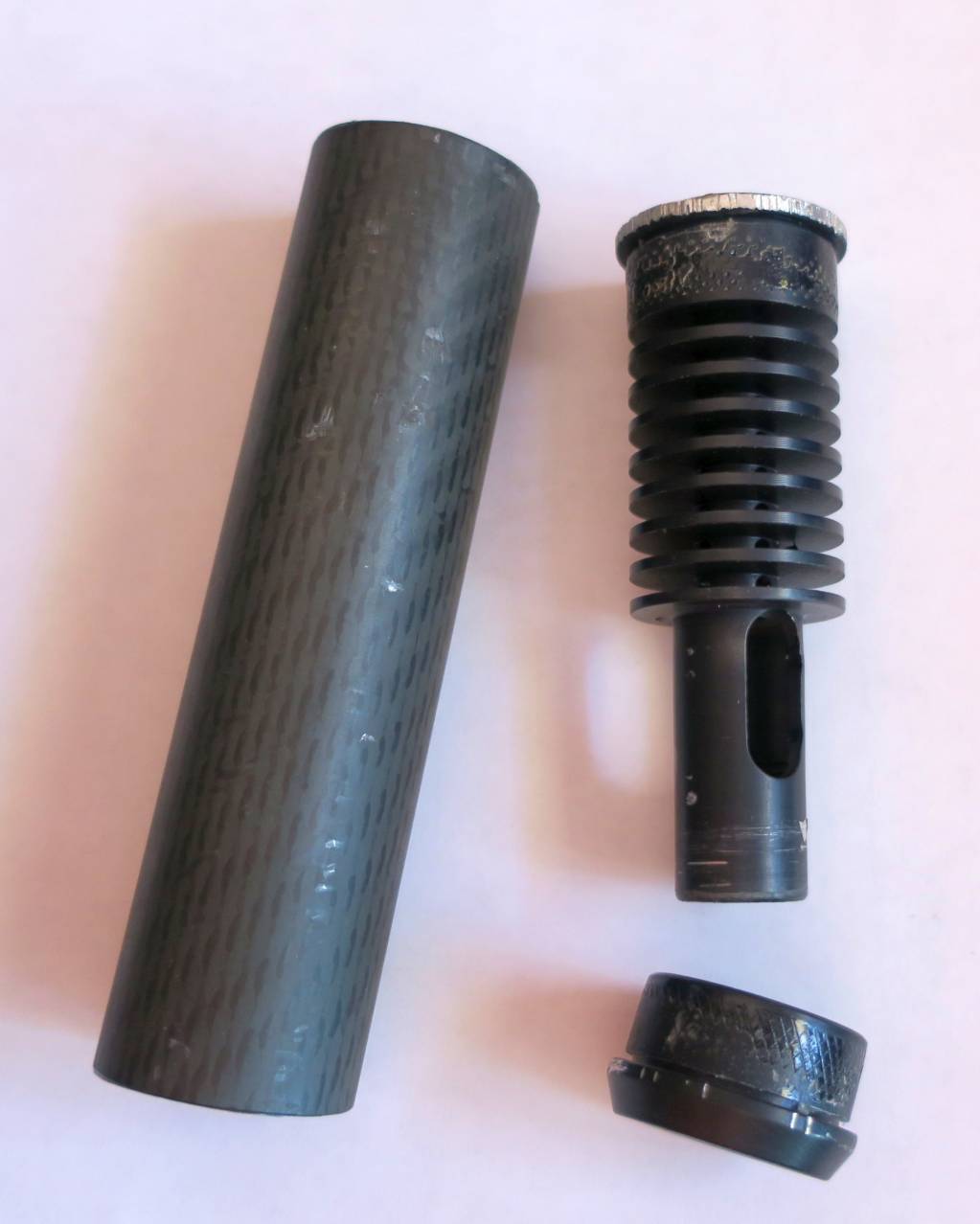

Knowing that I just needed to access the one interior part and not caring much about the mod itself, I just attacked it with heat gun, channel-locks and even a hammer/punch, until I got the innerds out and attacked those with the torch. The front and rear caps are not threaded but are glued in.

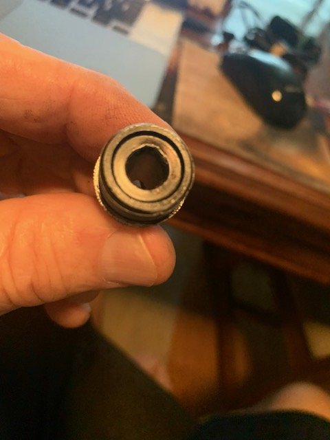

i really need some help with my daystate huntsman regal .22 cal. mine is clipping inside the hole of the moderator on the adapter. you might have to blow the picture up so you can see where it's clipping. i will try to post picture so anyone can see it. i would sure appreciate any help. i have tried just about everything except a brand new shroud. which what i might have to do next unless someone has some great idea's. hoping to save me some $$$ if possible.
