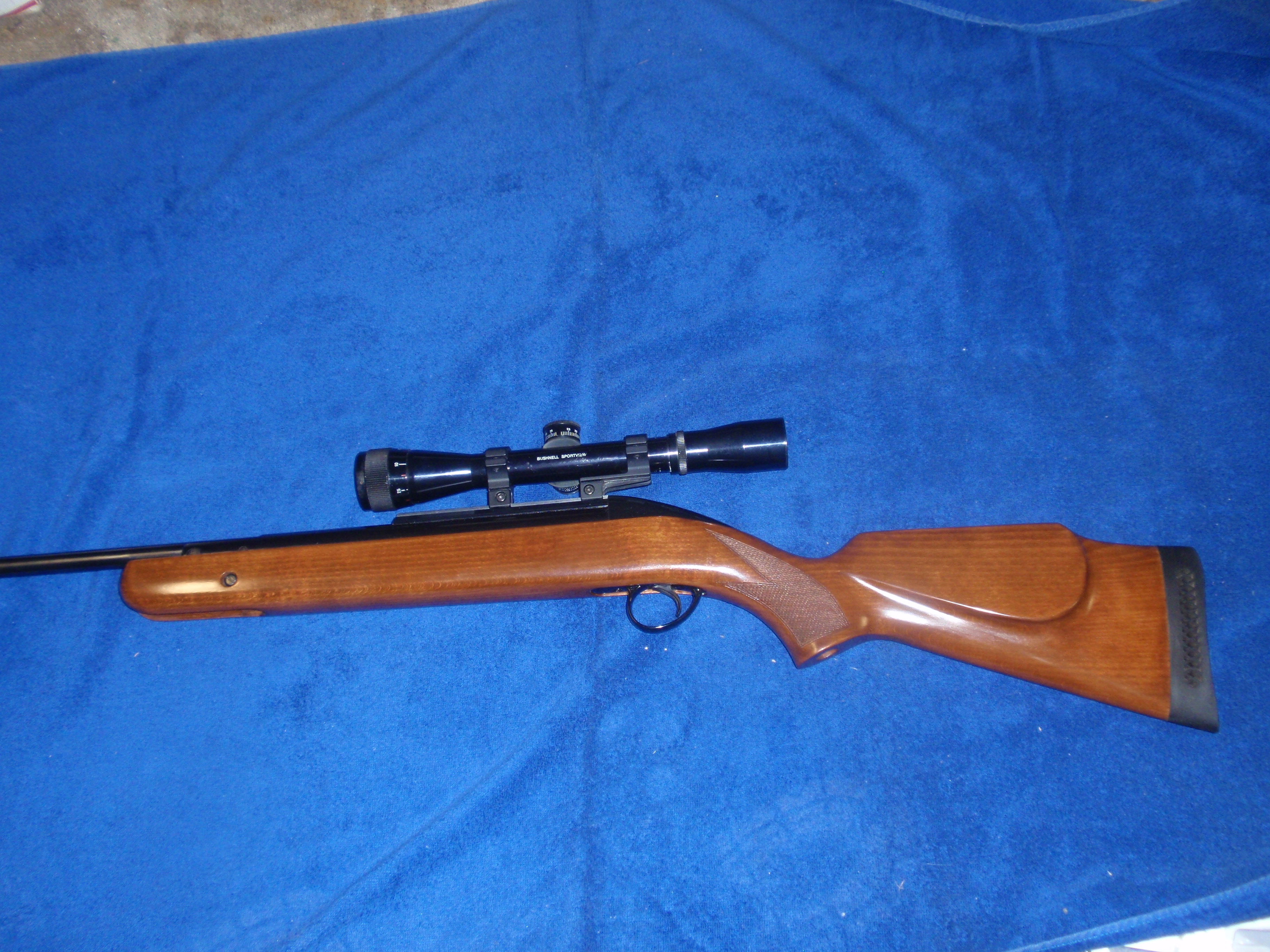

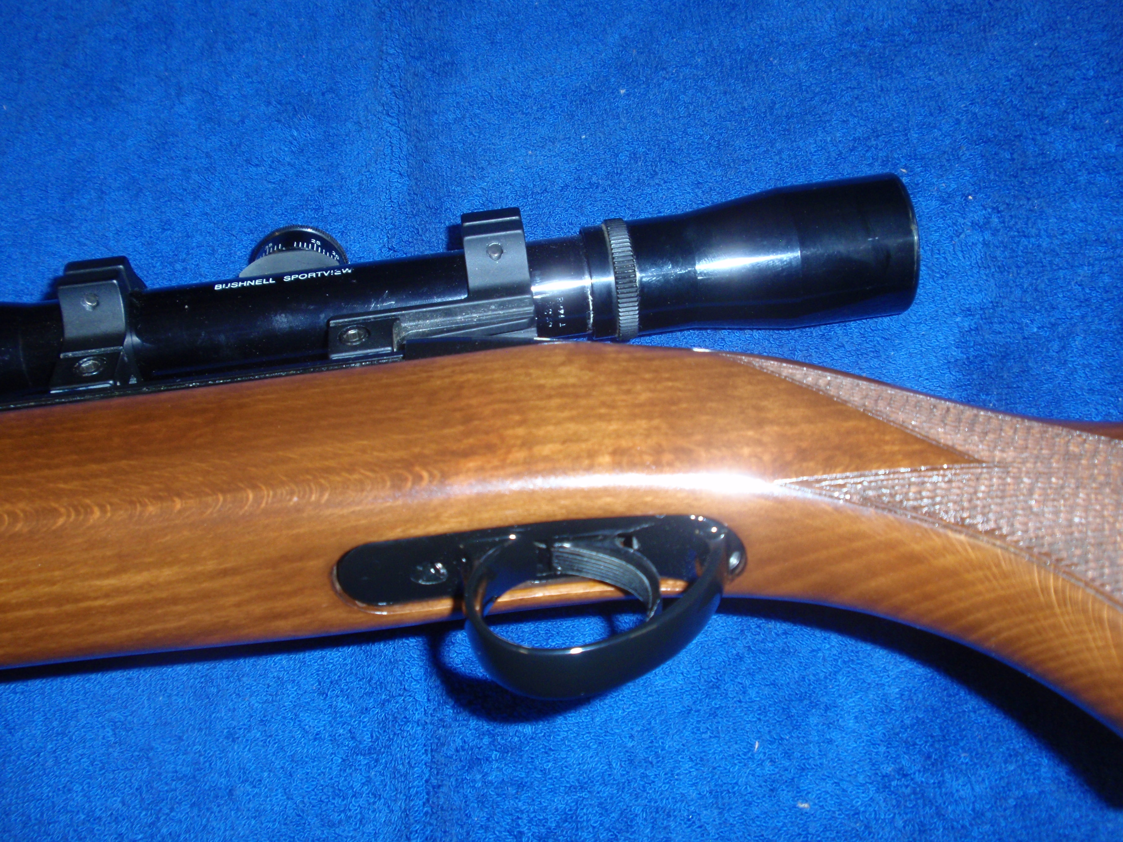

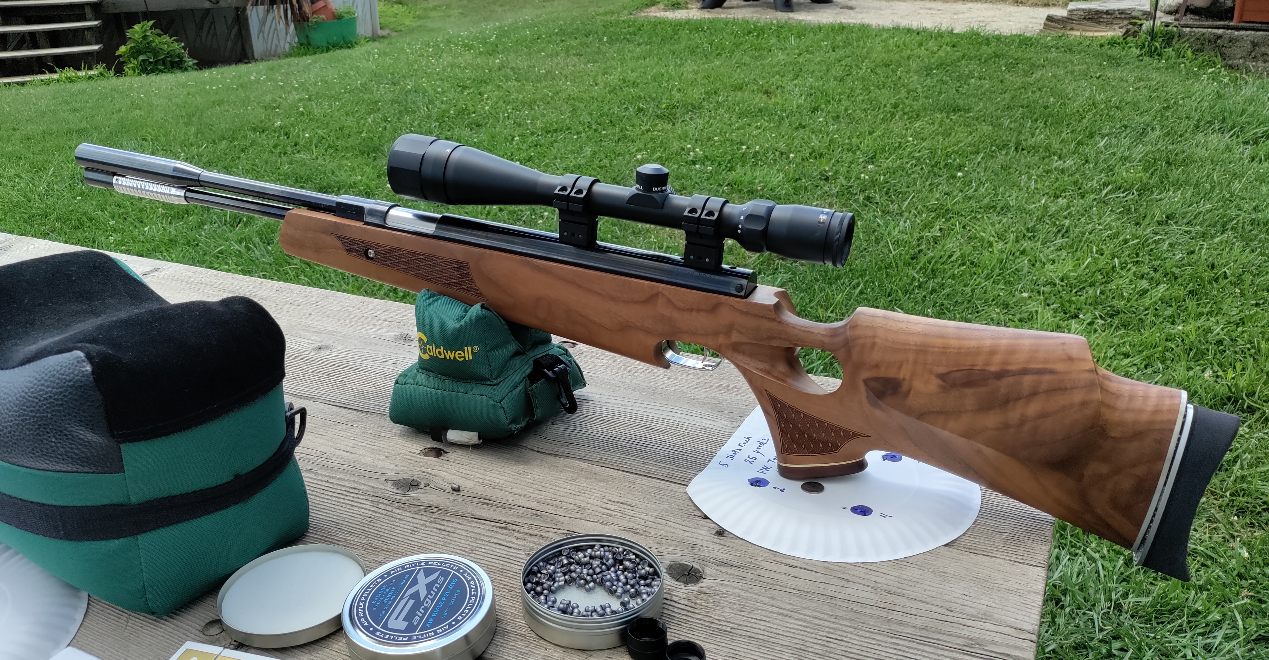

Very nice ,looks like a better stock version of itself.Yes, on my HW77K. The grip was too thick and I defined the raised cheek rest. I had to cut new checkering on the grip. I also had to stain the wood and refinish it. If you have some basic woodworking skills and knowledge along with some patience, you should have no problem.
View attachment 431193View attachment 431194

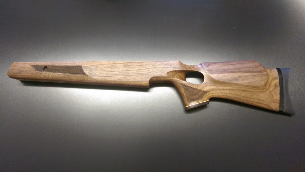

Oh ya, can't go wrong with CS UK.Thanks to everyone who responded. I’m glad I asked here before I just started sanding. At this point I’m planning on just ordering a replacement stock from custom stocks in the UK.
I’m thinking this one.Oh ya, can't go wrong with CS UK.
Which style, if they have more than one for that rifle?

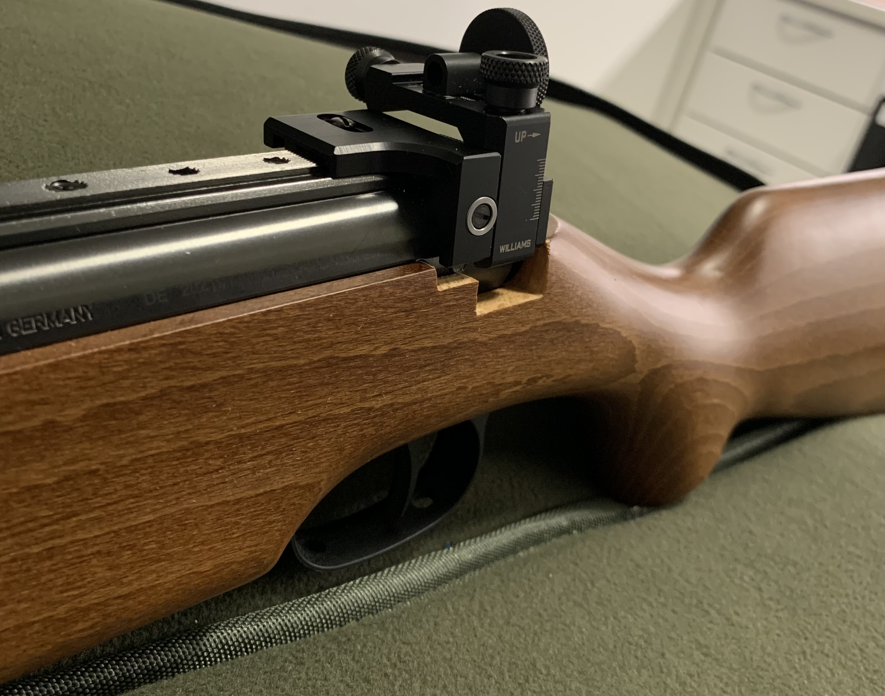

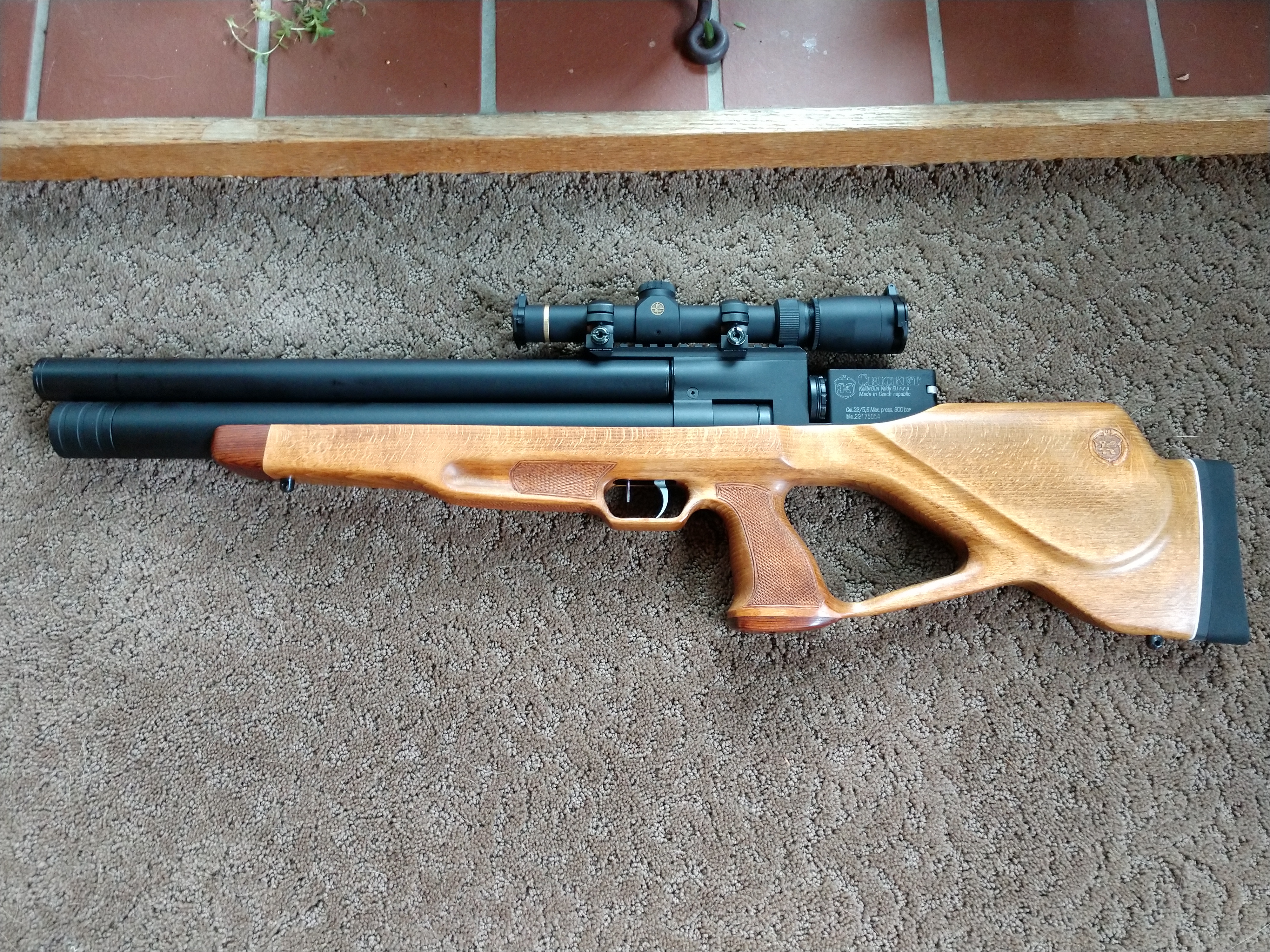

Hear is one example. My Kalibrgun Cricket Carbine. The factory beech stock was mud brown ugly.
I like the lighter shades on my stocks. YMMV.

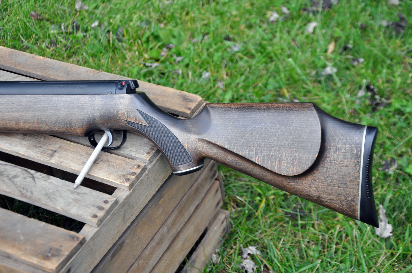

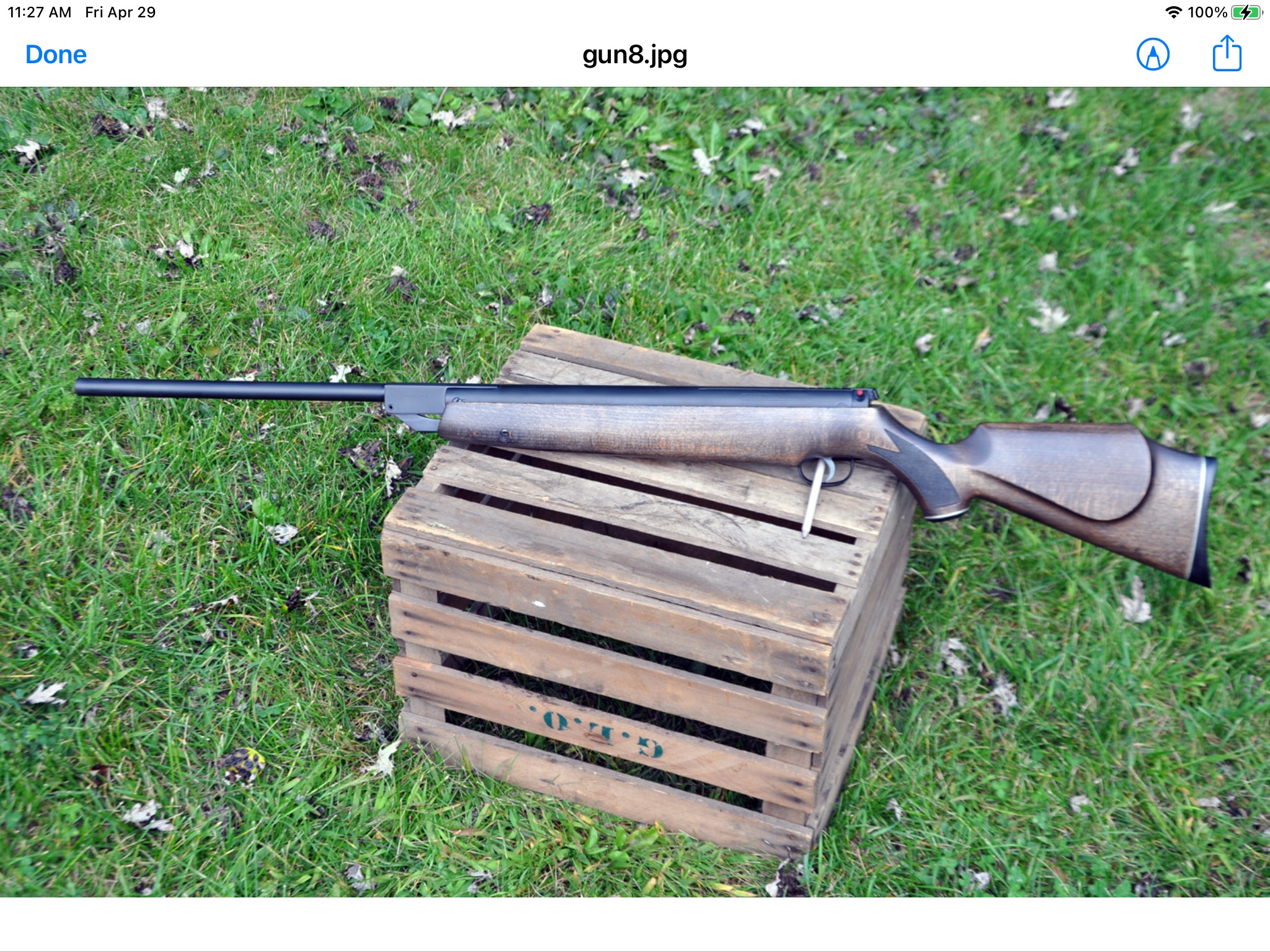

Depends which direction beech is sawn to determine where they lay. I always go back and try to carefully darken those crescent shaped light medulary rays in beech. I can't stand them. Little trick I use. I did the same thing on other beech stocks. An airbrush set to barely apply anything works, or very carefully dabbing stain with a cloth or lightly loaded squirrel hair brush.Beech is tricky.. dye is the ticket. oil finishes only after the dye has been sealed. Factory finishes are sprayed with a two component most likely conversion varnish. Over a sprayed dye , you can see plainly inside of all HW and any beech stock the dye. This one was done for a guy who wanted grey tint but not opaque. semi transparent look to go with satin black finish. View attachment 432158View attachment 432157View attachment 432159
