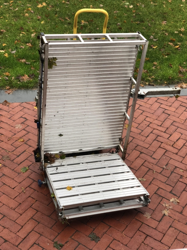

So im trying to set up a backstop to sit behind my squirrel shots to prevent any pass through follow on or ricochet....backyard shooting
I have an aluminum cargo carrier which is perfect for outside as it doesn’t rust and it’s pretty much just sitting there going to waste. So what I was going to do is put some ballistic panels which are 2ftx2ftx1 inch in front of the aluminum backing, the aluminum plate backing is about 5mm at its thinnest point
Any thoughts on this?

On topic.. I have a cargo carrier that looks just like that. If you hit it with a .25 at 33yards.... you are going to go right through it. Heck, you'd punch through 1/2 to 3/4 inch plywood. But if the ballistic mat is as strong as I think it is, the AL tray won't be the problem...
Mostly 'concerned' because you're describing a 100 FEET, that ain't far for a .25...

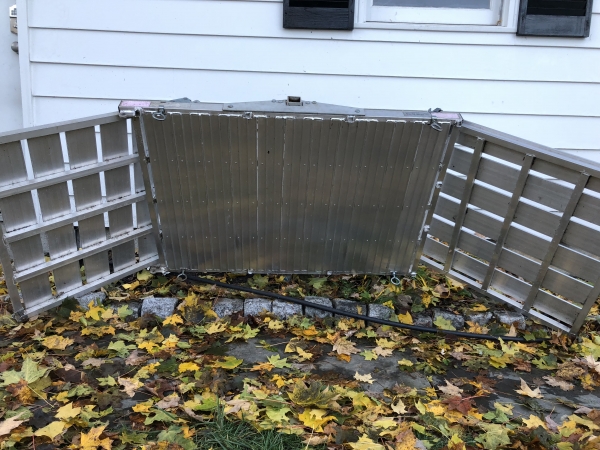

Here’s where I am at now, I’ve got the back aluminum panel at a downward angle, and I’ve got two sides. I was going to put the ballistic panels (4) on the back and one on each side just as an extra, not for direct hits

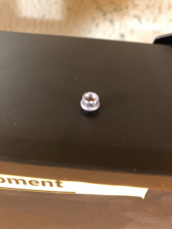

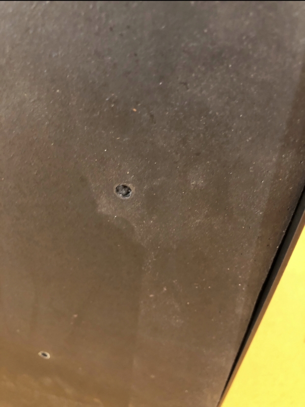

The guy at STS claims to have tested this for me and shot it he said with a .25 Marauder
and below is the pics he took afterward, he said it stopped the pellet in its tracks and didn’t even penetrate
i also heard that this stuff is NOT recommended for air rifles under 600 fps
I don’t know how the Marauder .25 will compare to the FX Wildcat .25, any thoughts?
I used 3/4" old gym mat rubber with 2 plywood in back. The rubber slows down the pellets so much that they barely dent the plywood. They rubber also has the added effect of shrinking back to a tiny pin hole. It also absorbs the noise of the pellet impacting. I think the rubber and aluminum alone will be fine. My gun adjusts from 30 fpe down to 18 fpe (Bantam sniper) and I havnt had to worry about any ricochet or penetration. I think just some rubber plus the hard aluminum will be fine. Or you can use rubber mulch bags stacked up infront of the aluminum. As far as attaching everything use bolts washers and nuts. Stews much be mine but they might not thread nicely into the aluminum.

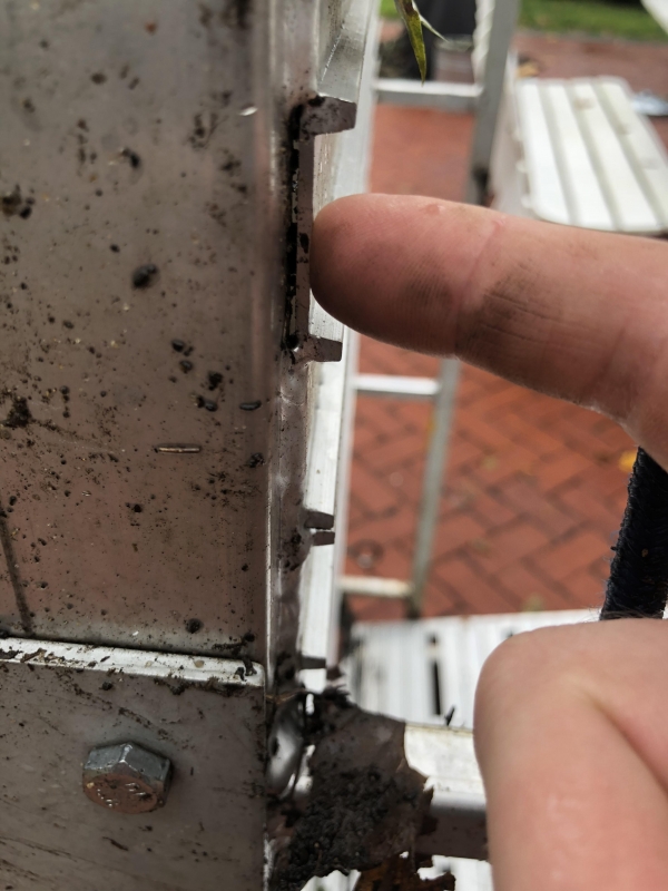

I since bought a truck and an SUV, so I don’t need it, and to be honest the thing was made in China, I wouldn’t trust it hanging off the back of my car, I gave it a kick and cracked the aluminum weld, and it’s pretty much new!
