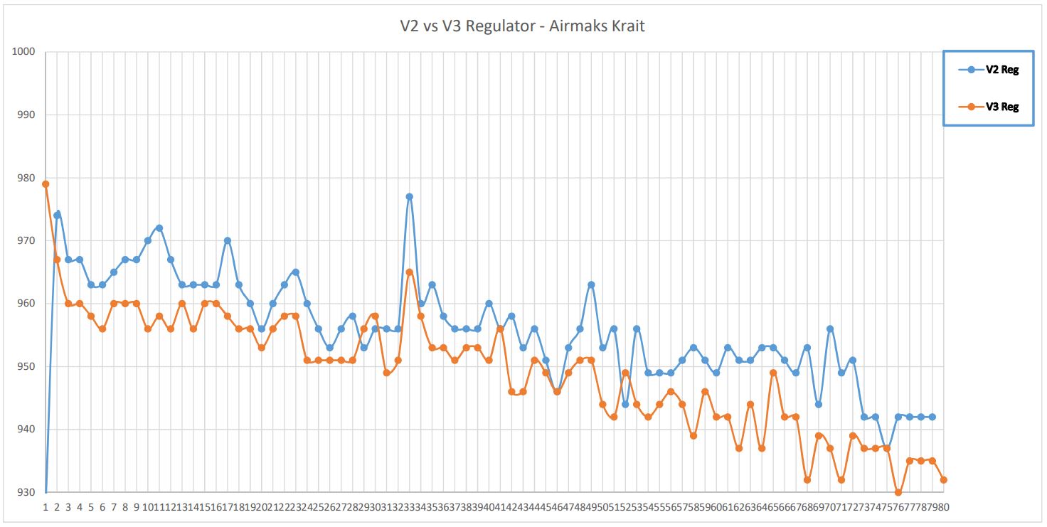

Here is a graph with actual data from the V2 vs V3 Reg. I took the V3 reg data yesterday. It is bizarrely similar the the V2 reg data I took on 11/05...

Still looks like too much hammer strike with the V3.
I don't think so. It gets on consistency "nodes" where it hits the same velocity a bunch of times in a row, but as the tank pressure continues to change, so do the velocities. I think the hammer is pretty tuned, or at least respectably enough to not get this kind of awful performance. The hammer spring adjuster is turned in exactly 1/16 of a turn from factory. We did not touch the valve adjuster, because most consumers of this gun would not open up that panel to touch that and we feel it should be pretty reasonable set from the factory.
