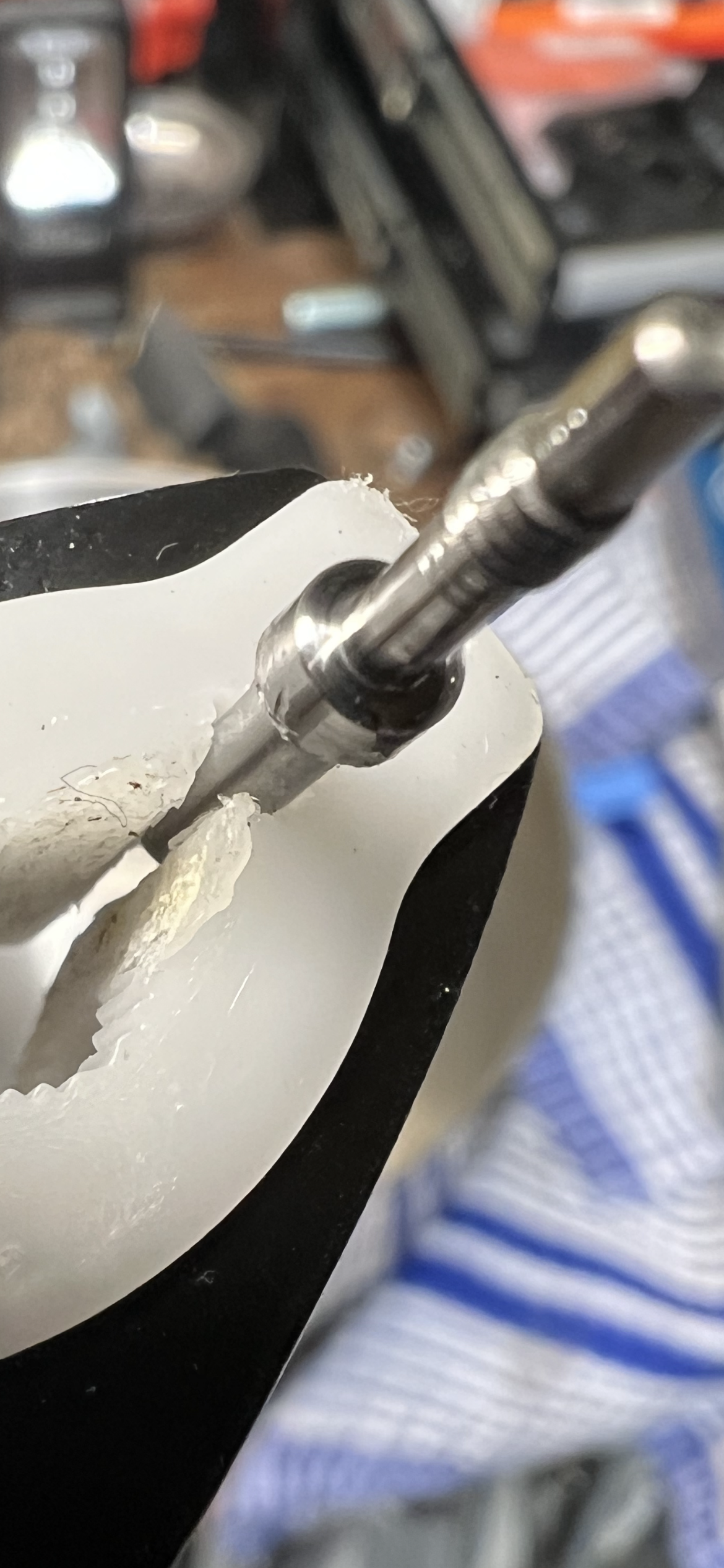

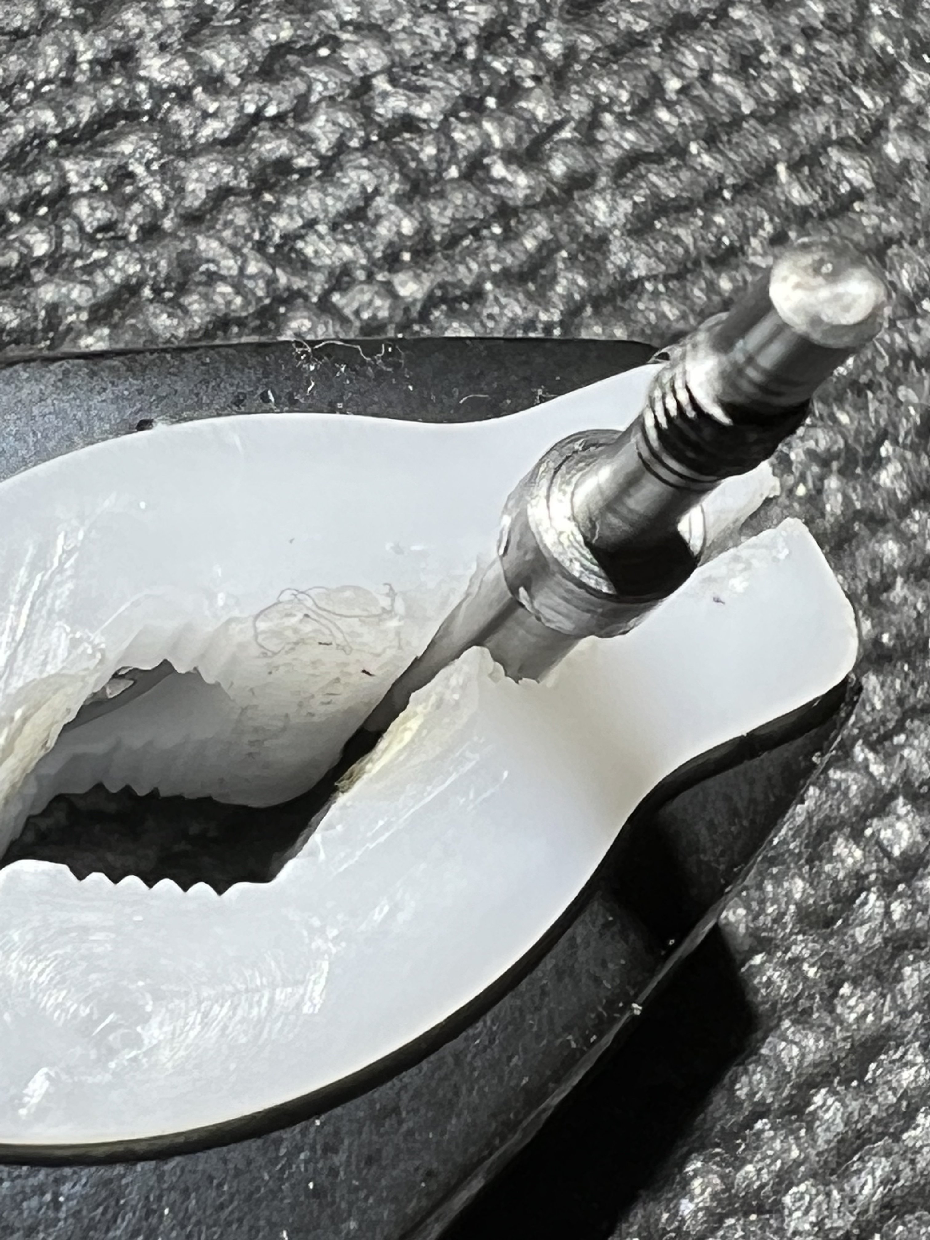

Here is a pic of the brand new never installed reg they sent me. It’s another V2 that I was told should work “good enough”. This is the hard sealing surface that contacts the soft seat. This my friends is a no go. Doomed before installation. Time to work on it.
Holy cow!!! What kind of pig iron rough a$$ poop is that!!! How is that even presentable? No one bother to look at that and a said hold the horses? WOW! Didn’t expect quality to be this bad!

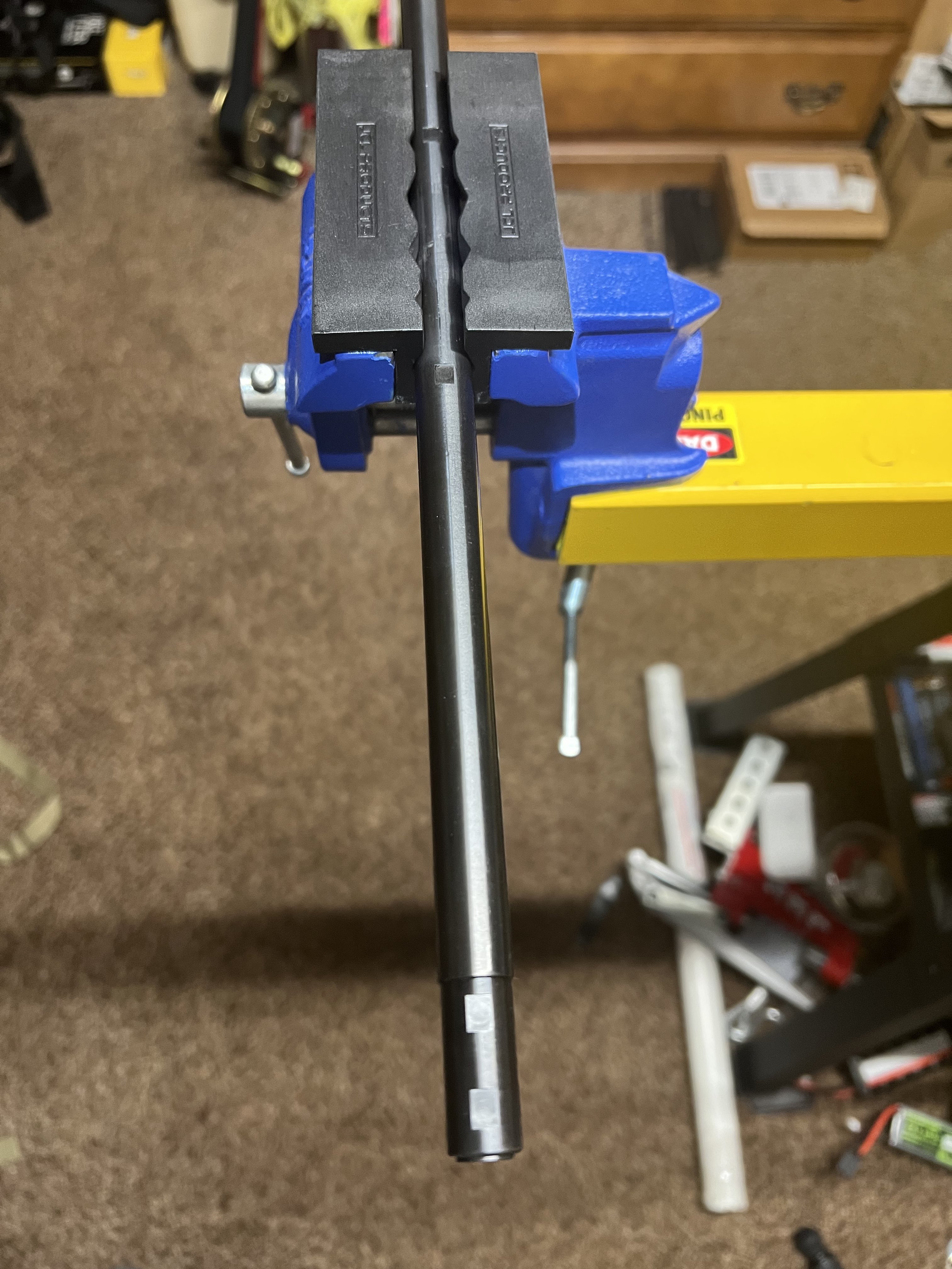

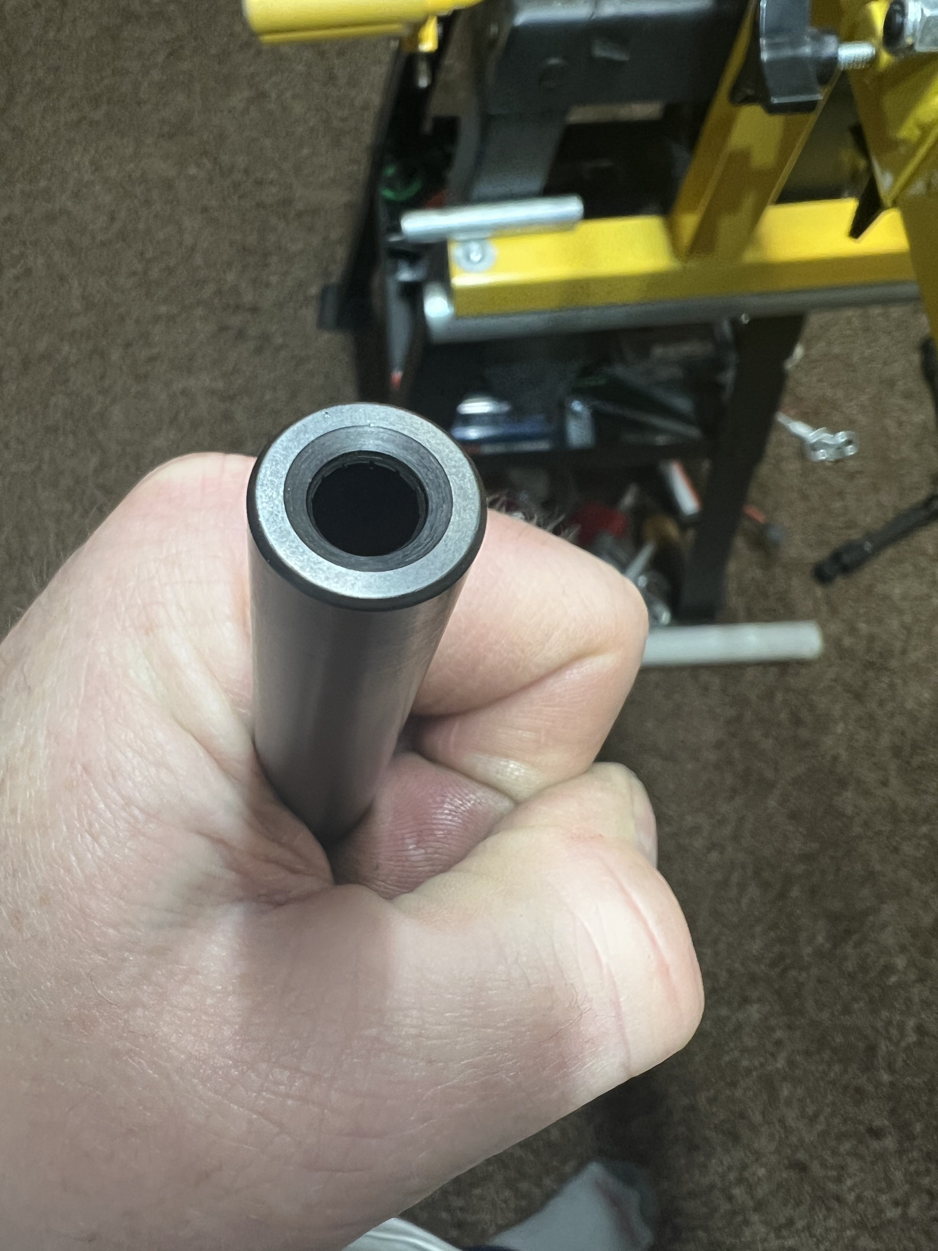

Reg back in the gun and I burned through a ton of pellets trying to get it to settle. Was experiencing some weird things with my velocities so I decided to just go back at it later. Decided to clean the barrel again and take some pictures of the reason why I decided to keep the gun and try to figure it out. I don’t agree with the statement that this gun is a piece of crap. It’s far from it. It’s does have an issue though. Here is the barrel. Nicely done crown, four nice flats for the four places the barrel is clamped to the gun. And finally the transfer port. This gun needs no orings to seal the TP. None on the barrel and none below the TP. One could argue that piece of crap guns need orings on the barrel because well, they are pieces of crap. What’s interesting is this is a big TP. And the porting below it is big. But I can’t get the gun to waste air and get loud. It also doesn’t produce big power for my reg setting so this gives me some things to think about and how I tune it.
