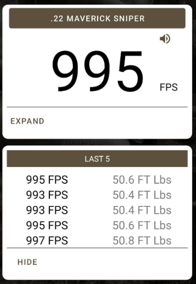

I have a first batch Maverick and it shoots absolutely cash money. +/- like 5fps from 250 bar all the way down to 140 bar and I shoot sparrows with it at 150 yards with the stock liner, no joke.
The only messed up thing about it was no 20MOA rail - it was 0MOA or possibly negative MOA and I couldn't zero my scope at first. FX immediately acknowledged the problem, apologized, and sent me a corrected rail along with a few freebie parts. They didn't even need to do a V3, V4, V5, etc version of the rail to get it right - imagine that! 🤣 🤣 🤣 And get this, they were NICE to me about it! 🤣

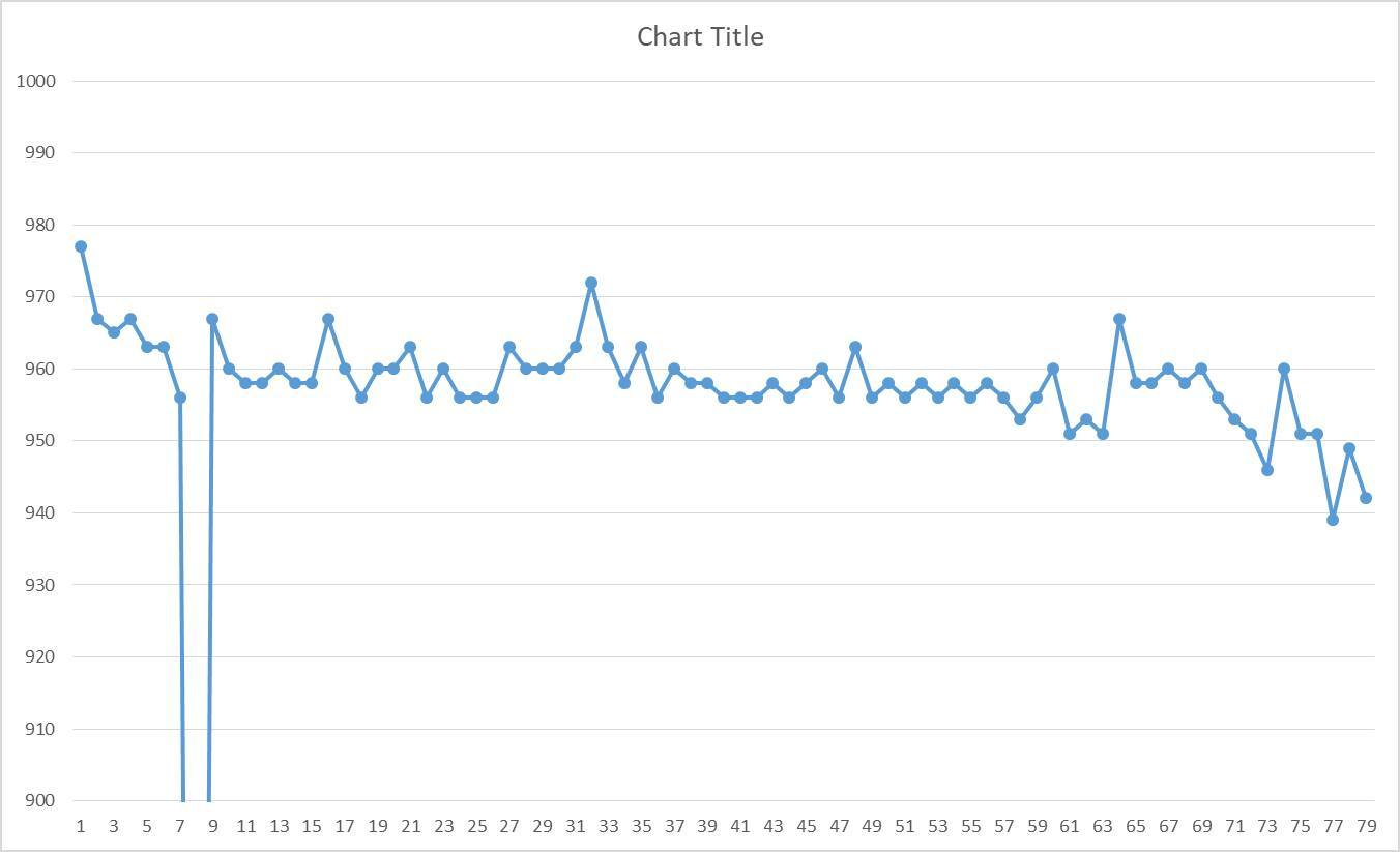

Well guys, we got to testing the double-reg'd TurdMaks Krait today.
  • Started by turning the valve adjuster all the way out (of course there is NO mention of this very important tuning aspect in the manual).
  • Then we applied a slight bit MORE hammer spring just to make sure we could tame the creep by making sure we could always open the valve fully. Make no mistake, this terribly designed reg will ALWAYS creep, you can slow it down by double regging it to supply it with lower pressure, but it will still always creep...
  • Oh, and disregard the super low shot #8, that is from the anti-double-feed NOT F*CKING WORKING (par for the course for TurdMaks)... 🤡
Anyway, the graphs are below. First one is the results from today with double regs. We fell off the reg at shot 69 (nice). Pretty decently flat shot string. We could actually use this gun for hunting now.

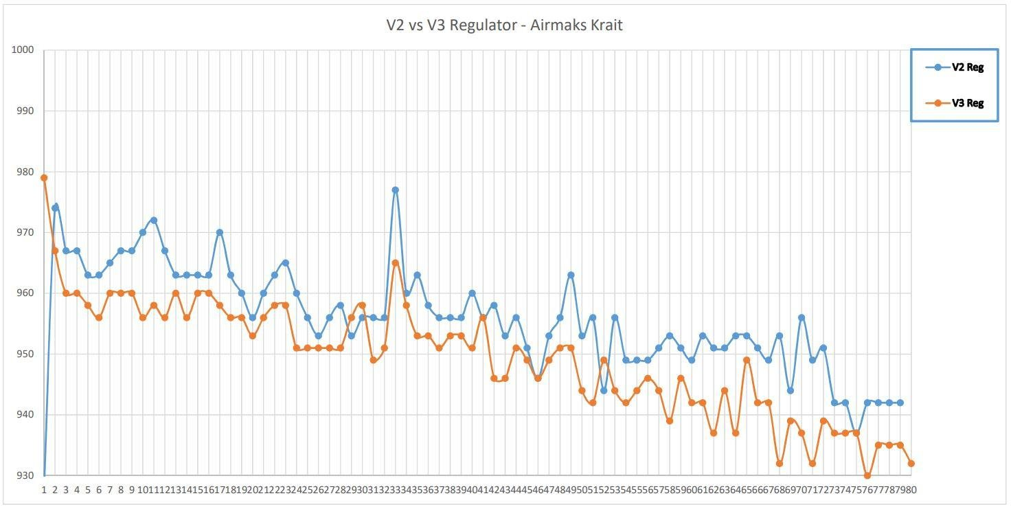

The second graph is the single reg'd stock configuration with the V2 and V3 regs (which are literally the exact same thing).
As you can see, the consistency vastly improved with 2 regs. We are still messing around with the tuning a bit, but this is likely the best we are going to see until someone who doesn't ride a short bus while wearing a helmet designs a proper reg for this thing (looking at you, Huma! 🙏🙏🙏).

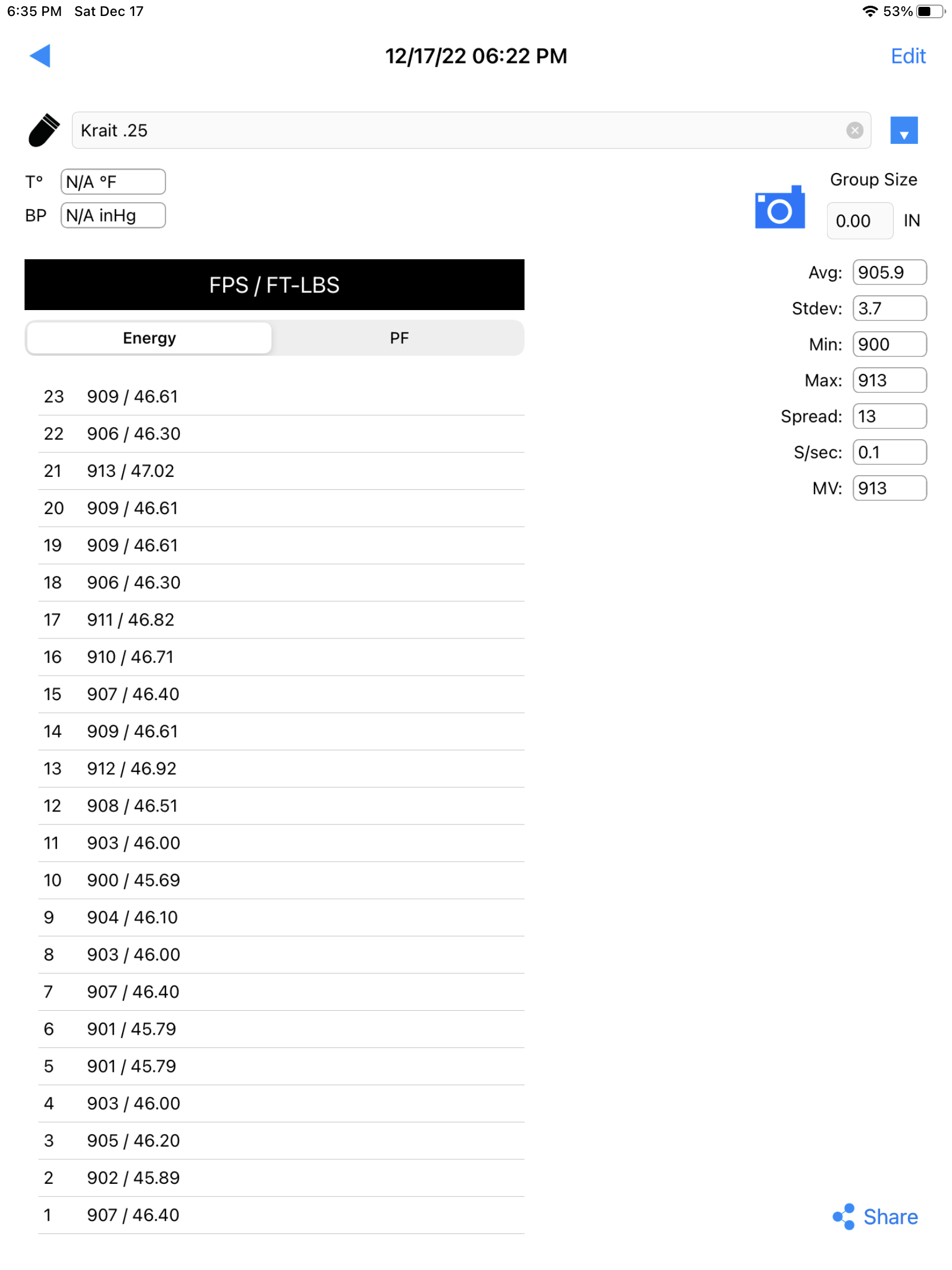

Here is a two mag string from my gun after sitting around 24 hours. I am currently battling my set point changing daily. Last two times I shot I had to adjust the gun down a couple bar when I was done. I knew the second I started shooting that my second reg had changed slightly. My most accurate shooting is at 125b and the gun floats from 895-905fps. For this string the gun was just a little hot and sure enough the reg was a couple bar higher than 125b. I bumped it down to 125b again and will test tomorrow.
Not bad at all. I'd be interested to see what a 300 bar to 150 bar string of 80 shots looks like, though.

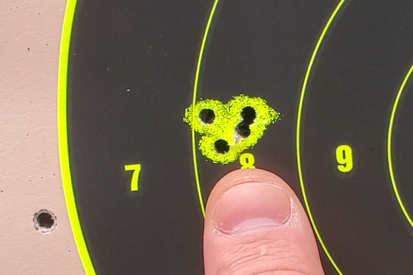

Daniel's gun was shooting pretty decently today. Like night and day difference. Not sure how to explain the way tighter groups. It's obviously the same barrel and about the same velocity (except way more consistent) as before, using the same .217 24.8gr NSA slugs we had previously tried.... 🤔
Here's 5 shots at 28 yards (his near zero). He said they all went wherever his crosshairs were. Not bad. Before there were always oddball fliers. We didn't shoot targets further than that today. It was 23 degrees out. He did manage to hit a 4" steel plate at 75 yards offhand, though.
That’s because you were over driving the valve last time and the extra tension on that valve wasn’t helping. As your single reg followed the bottle pressure, the extra tension on the valve return spring was kicking you in the nuts at some point. If I were to try to shoot slugs I would probably have to go 150b on the reg. But I still wouldn’t go 300b on my fill. If I fill to 265b I get 6 mags. That’s 84 shots. After 84 shots I can certainly take a one minute break and fill the gun back up. If you’re wondering why my 300cc bottled .25 is getting more shots than you guys, maybe you’re still smacking that valve too hard. But you’re moving in the right direction.
