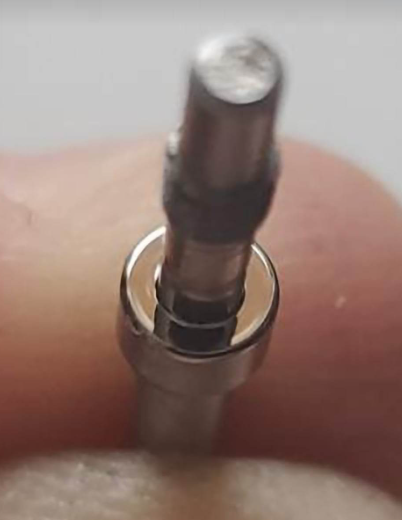

While we wait for the Huma reg, I thought I'd try experimenting with the V2 reg (again, same exact thing as the V3 reg) and here are the before and after photos of the sealing surface on the reg pin. I have not tested this as my cousin has the gun.
BEFORE polishing:
After polishing:
I just chucked it up in a drill and spun it with 1500 grit sand paper + silicone oil, then 2500 grit sandpaper + silicone oil, then 4000 grit polishing cloth then 8000 grit polishing cloth.
I got rid of all those sloppy machining marks for the most part and now it has a mirror finish. Maybe this will help get that reg to stop creeping? One other thing I noticed was that the ID of the housing where the piston o-ring rides is pretty roughly machined, too. Might touch that up eventually. Will be neat to experiment with this V2 reg as a test dummy to see if it can be improved rather than just letting it sit in a drawer.
Maybe this is helpful to someone (will be more helpful if I actually install it and post results)
