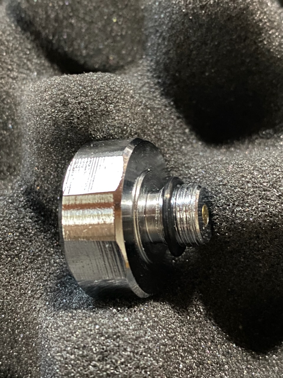

Anyone know the thread size of the krait gauges? Looking at replacing it with a digital version, unless someone knows of a more accurate mechanical gauge with a range between 1k-2k psi?

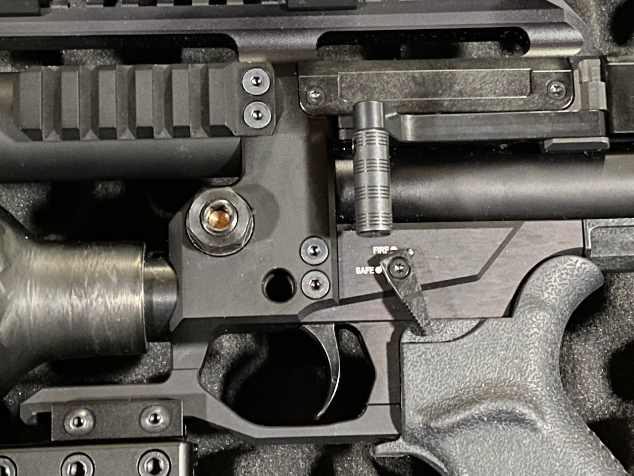

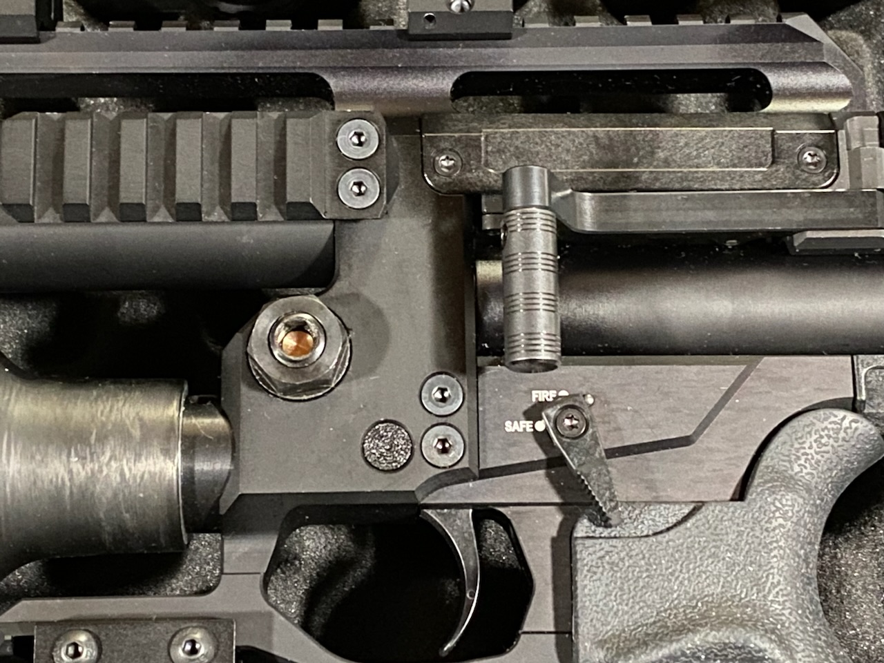

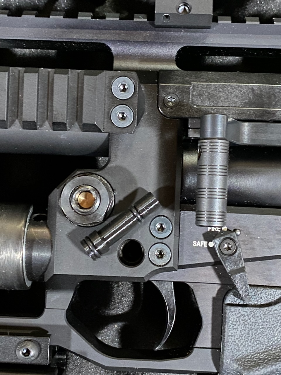

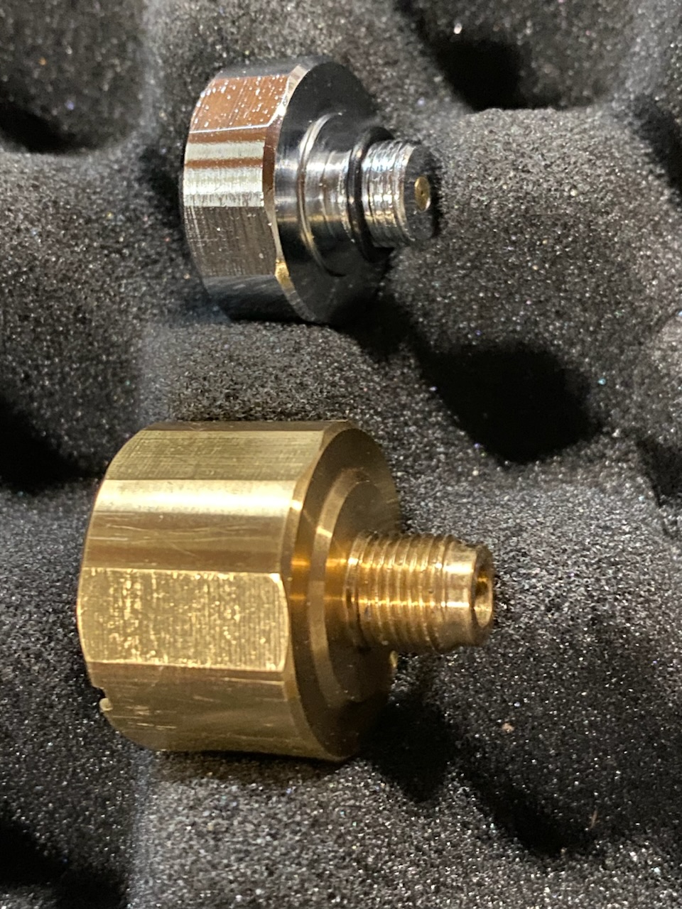

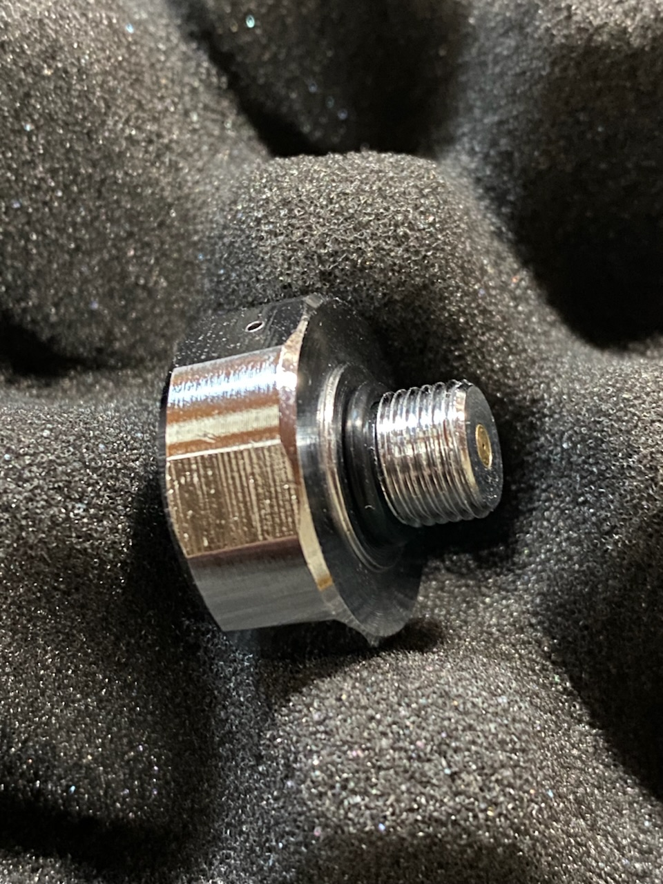

It’s 1/8 BSPP. But not all 1/8 BSPP gauge will work with the Krait as the way the gauge seals is with an o-ring at the thread shoulder with an o-ring groove as shown on the following pictures.

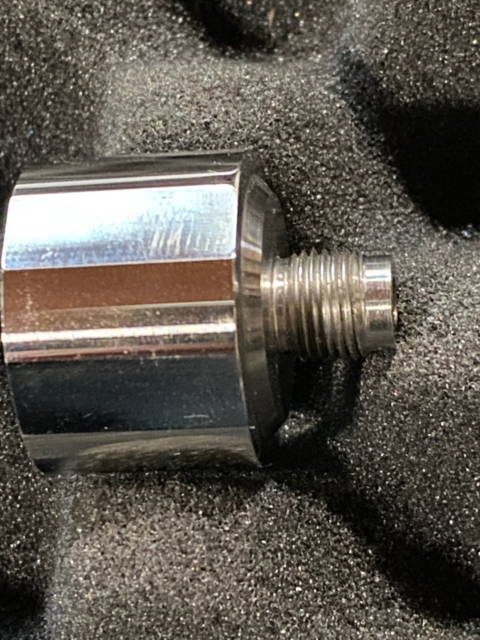

Here is an example of a gauge that won’t work as the thread goes all the way to the back of the gauge without out an o-ring groove and the thread maybe cut by the thread.
I have replaced my Krait with a Sekhmet gauge as it has a groove that the o-ring can safely seal the gauge.

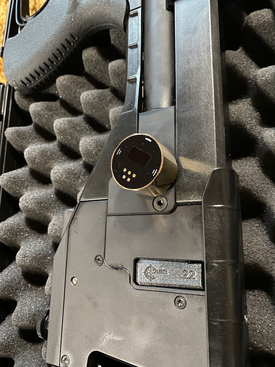

I didn't realise now small ( and neat ) the Gauge was on the Krait, I was looking for an alternative, the Sekhmet looks huge in that photo.
Rethinking, thanks for showing Jack K.
It's pretty far in front of the cheek piece, probably won't be a bother. Also, with some Vibratite 440 you don't need to worry about that oring.

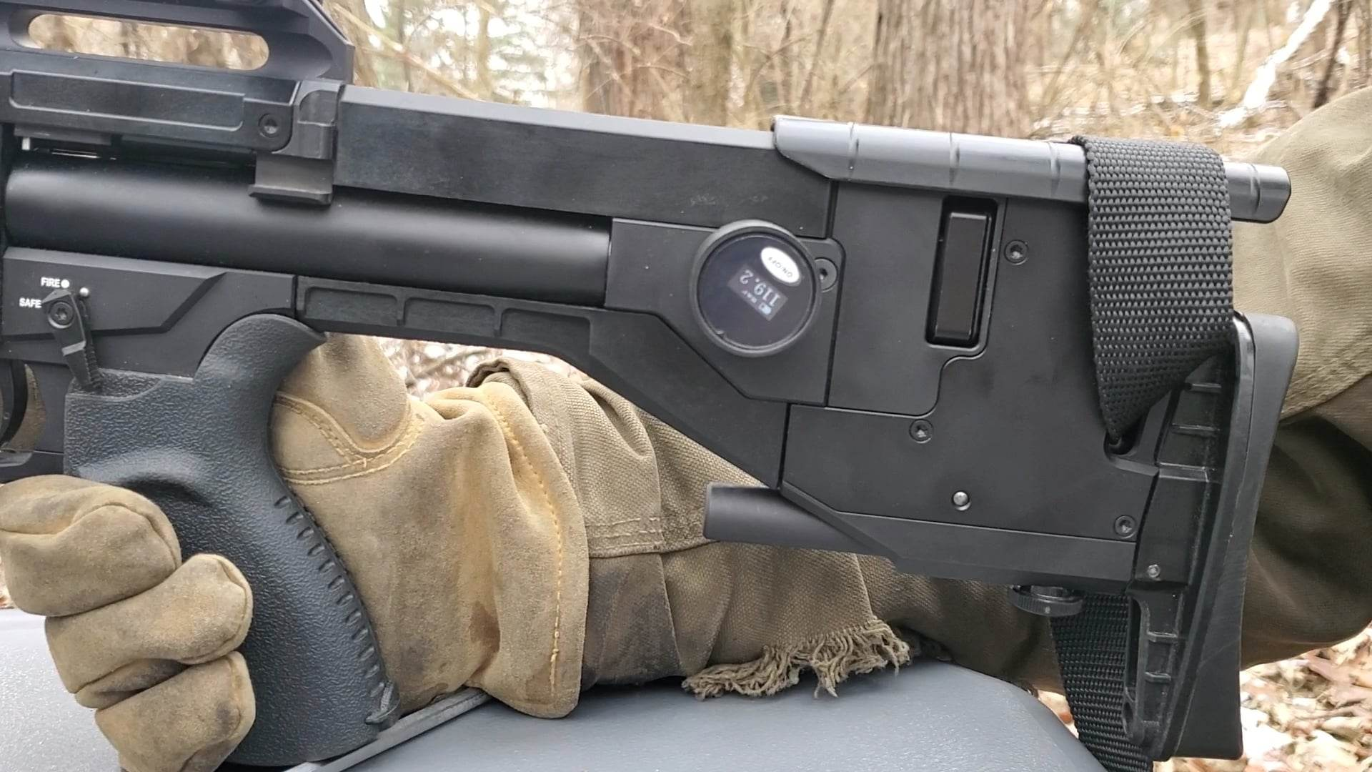

My cousin just ordered one of these digital gauges that we are hoping will work pretty well, looks like a sekmet copy. Only 40 bones so no big loss if it sucks:

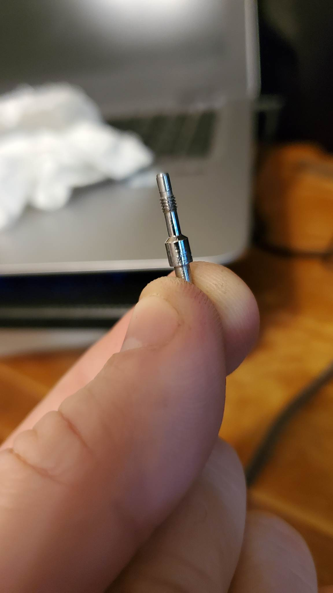

Big news: We think we got this thing to finally stop creeping!

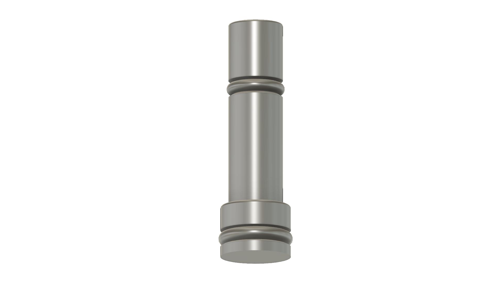

The V3 reg has a tapered collar (sealing surface) and the V2 has a flat collar. The V2 will never work, BUT, with the V3.... It apparently can be made to work.
Once again the V3 reg looked like a child did the machine work. Rough surface on the tapered sealing surface. Also, inside the piston housing where the piston seals/slides, that also looked like a 3rd grader machined it. We polished the inside diameter of the housing with some 1500 grit and silicone lube. Got it nice and smooth. Before you could feel machining ridges if you dragged your fingernail across the surface.... which obviously is gonna have a big effect on the performance since the piston needs to slide smoothly and in a repeatable manner to be consistent.

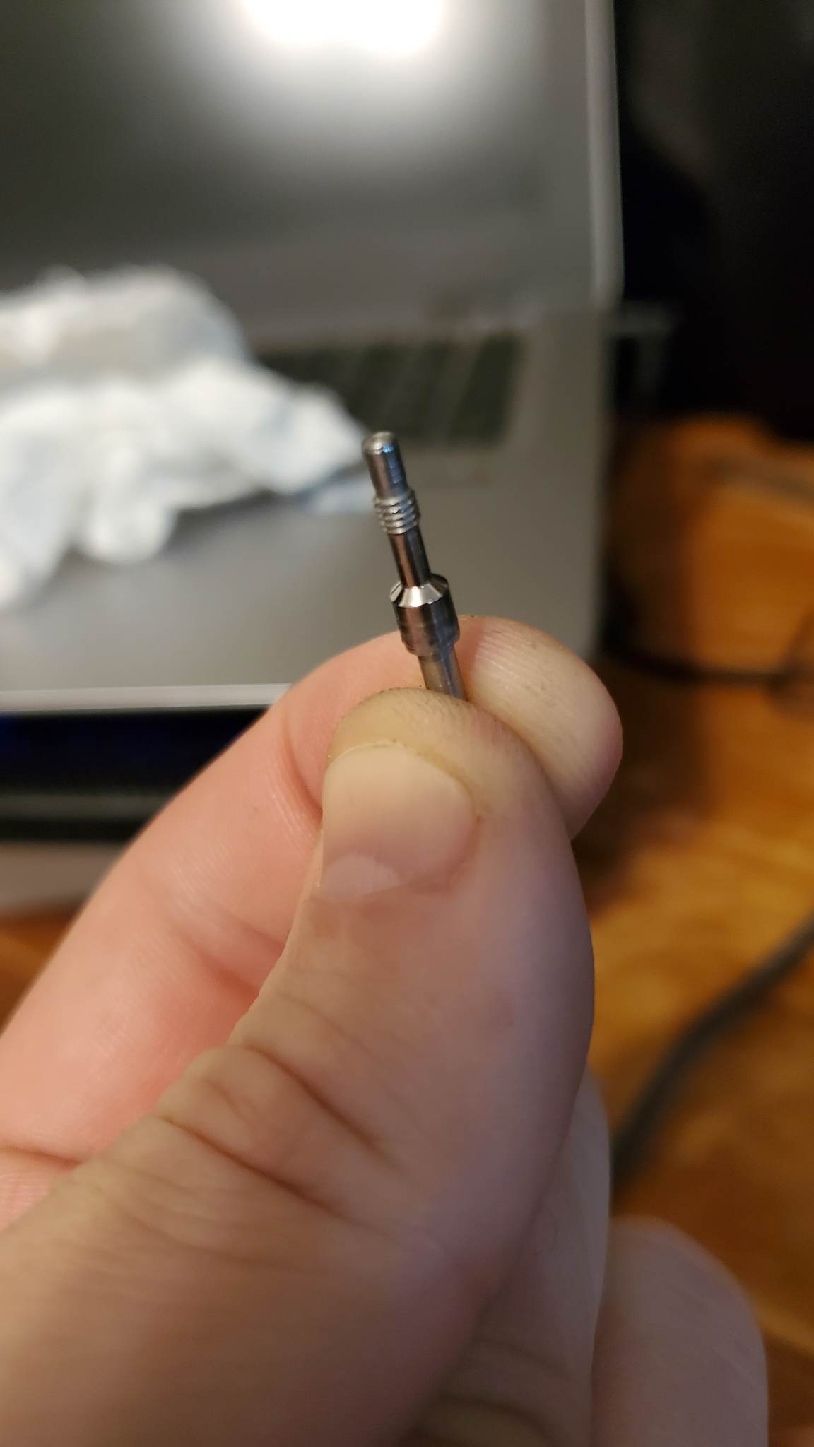

Next, the V3 reg pin collar - started it off with 1500 grit. Just put the pin in a hand drill and polished it by hand with the 1500 grit sandpaper and some silicone oil. Then I went up to 2500 grit sandpaper. After that I broke out the 3M polishing cloth (LINK: https://amzn.to/3ipFVFI) and went from like 3000 in steps all the way up to 8000 grit. Took about a half hour to do all the work to the pin and housing.
Pics of the 8000 grit mirror surface on the pin:

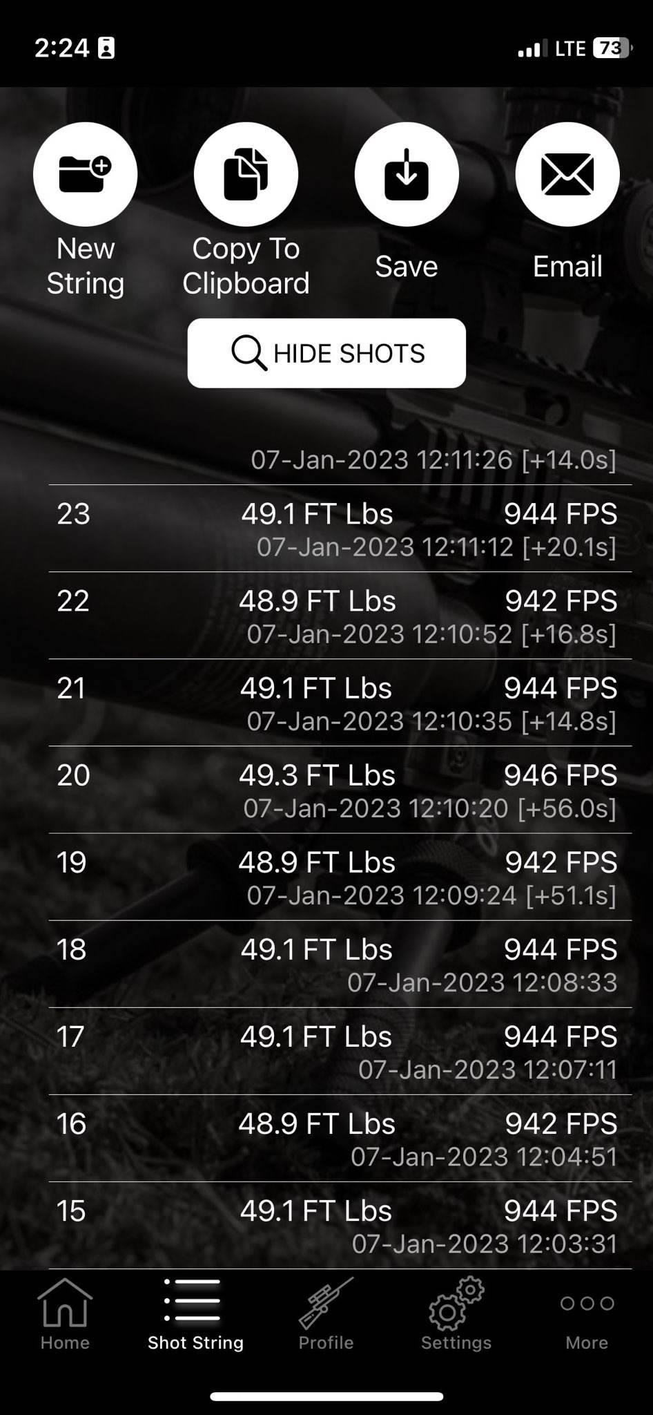

And here are the chrony readings. #15 was the first shot of the day and it was after sitting for like 1 and a half hours. Normally this would have yielded a hot shot due to reg creep:
We added a digi gauge (LINK: https://amzn.to/3IEI23f) which is an amazing tool to monitor the reg's behavior. It has been holding solid at 117.5 bar for 3 days now. The recharge rate on these regs sucks and I think the design still sucks, so until I get my Huma (push design, way better) this is going to do just fine for now! We have a usable gun now!
Hope this helps!
