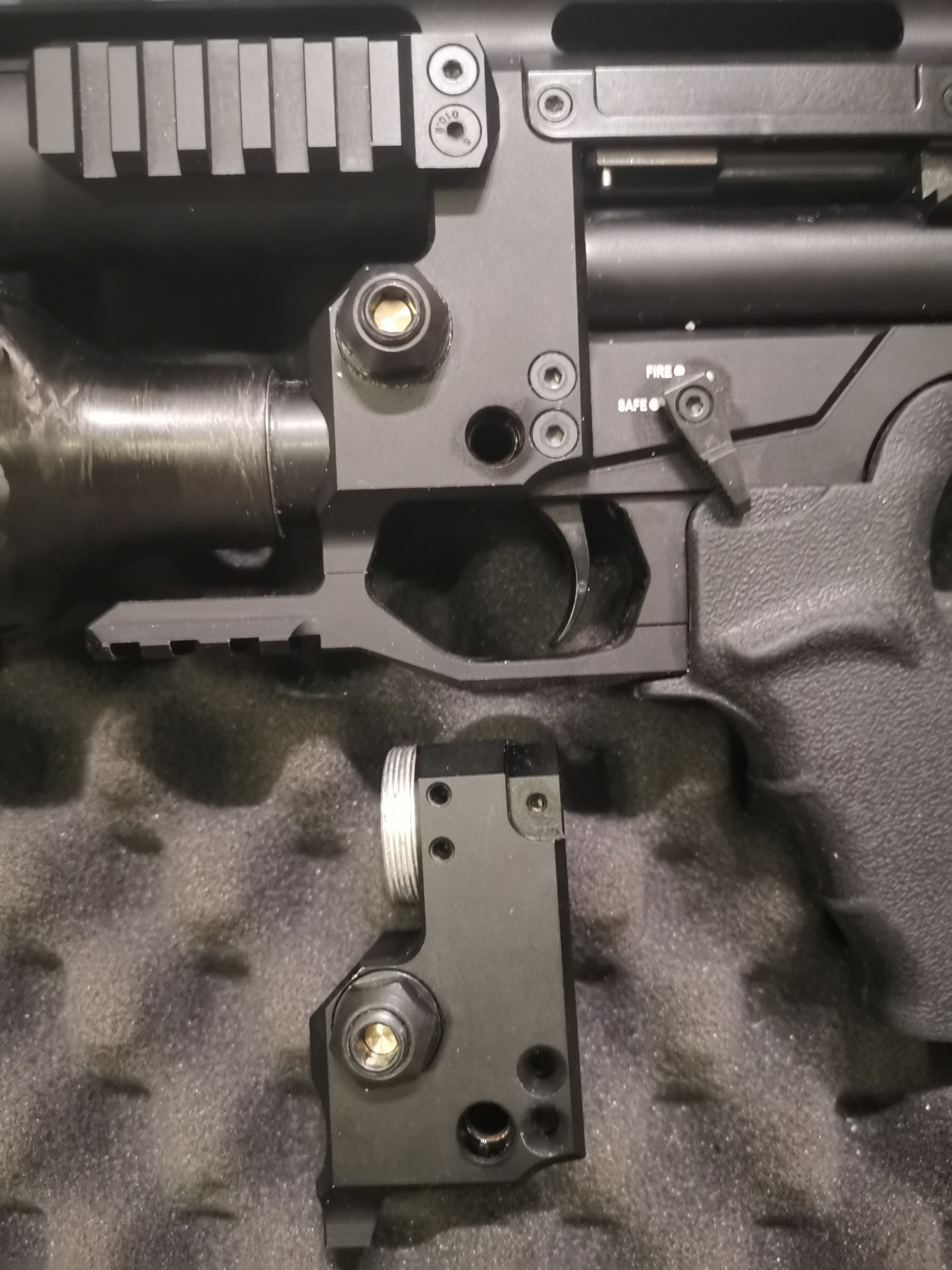

Good evening from Spain, I have a .25 Krait and after changing two regulators they have sent me a monoblok with a regulator included from airmaks and the problems of low speed in the first shot and inconsistency in the shots have been solved, I leave this message for If it helps, regards and good luck.

Hi, harrymorelandia I have installed the monoblok with regulator three days ago, the installation is laborious, since you have to disassemble all the carbine, barrel, holster, plenum, upper rail, lower rail, etc. The assembly took me about an hour and a half, the regulator can be adjusted to the desired pressure, I set it to 105 bar and the pressure did not change at all in two days, I have made about fifty shots and it works correctly, I have not had time to shoot more, I suppose that the new models come out with this problem corrected, since my krait is from September of last year.
So they resigned both the regulator and housing, is this v4 or 5?
