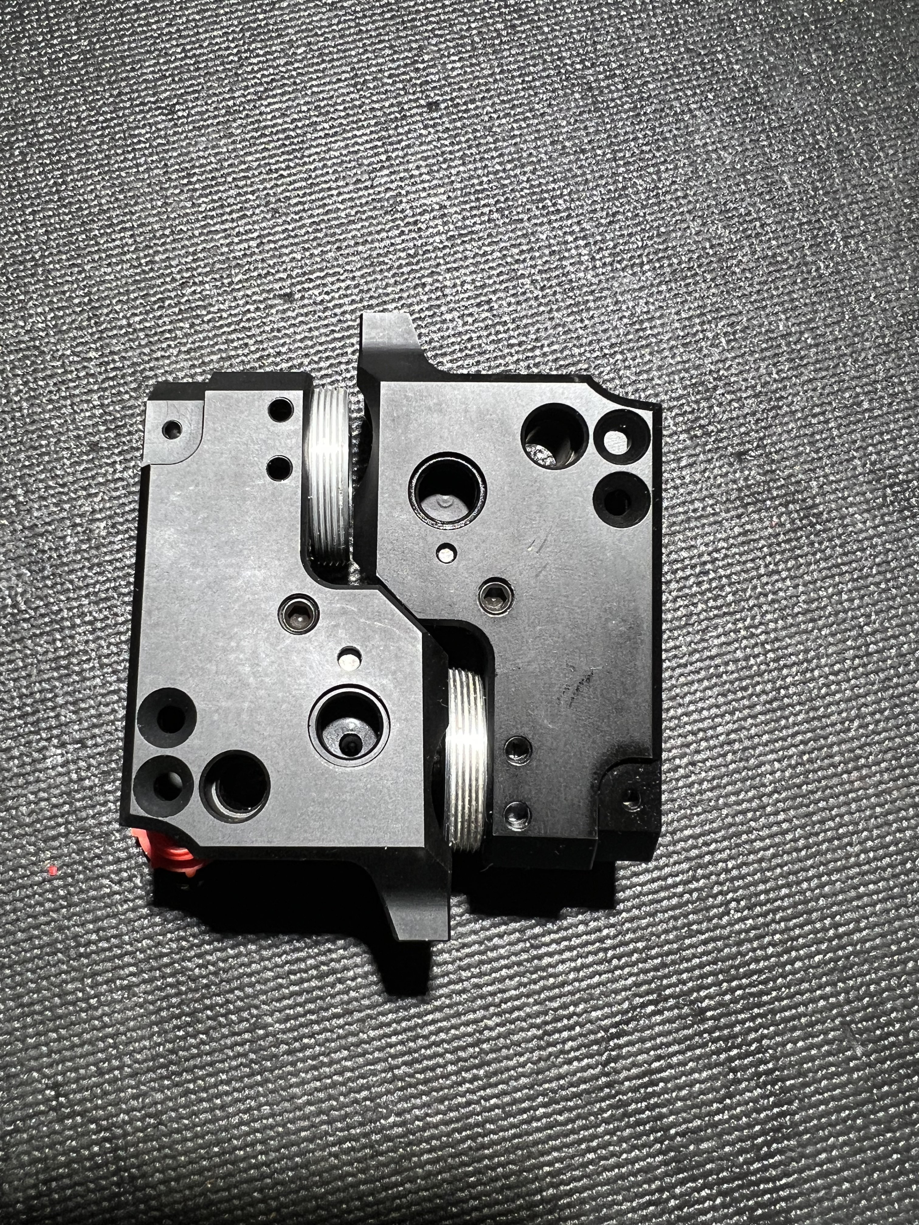

Can we see some pics of the new receiver? What changes did you note? Do you think the Huma reg in my video above would still fit the new style blocks?
The pin on the reg is bigger and the new block accommodates it. I started shaving speed with the valve this morning and the gun seems to be more stable with a 2 bar flux on the reg but I’m bleeding FPS. UA told me where they have been setting the valves. When I tried it, it completely killed my gun. I didn’t test the gun from a full fill to refill with those settings because I think having a .25 set on 145b to shoot a 27 grain pellet 800fps from a 550mm barrel is stupid. Even going back with two regs I still have the Krait reg following my bottle pressure which makes no sense to me. If the Krait reg is seeing a steady 190b from my first reg, why does it still drop as my tank goes from 250b down to 190b. I still believe it’s recovery. It just keeps getting slower and slower. I have another thing to try today. It’s been educational.

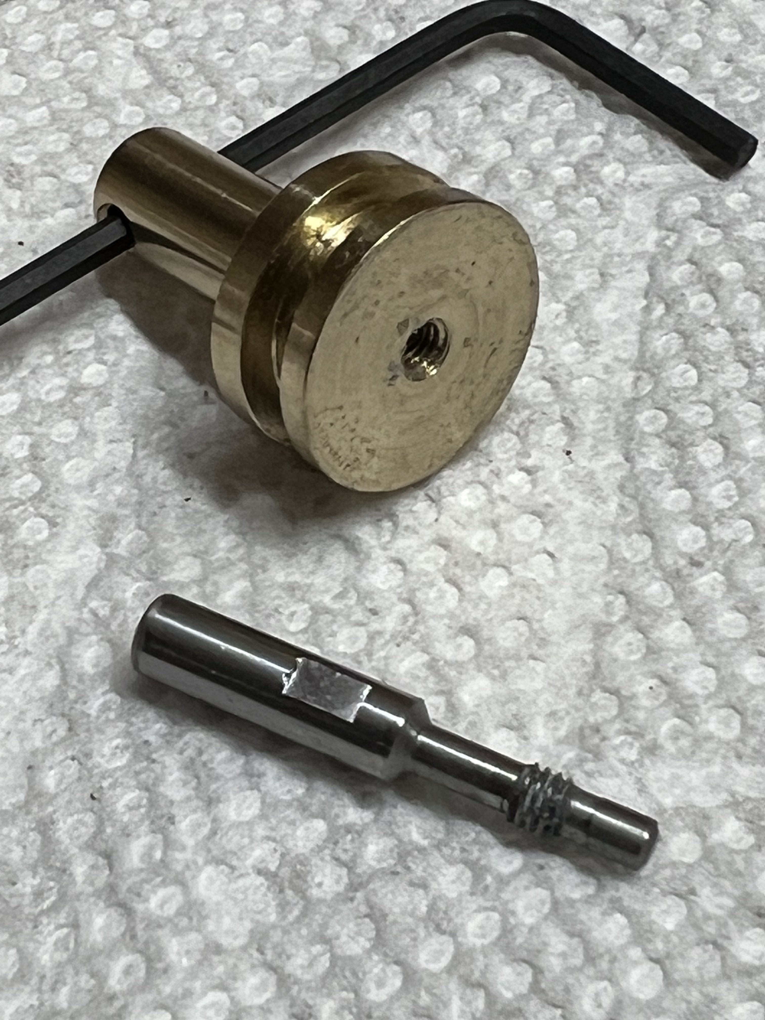

For those that are curious and have seen the pictures of the first couple regs for these guns, here is a picture of the V-what ever reg. Very well done. If this was in the gun out the gate, things would have gone better. The machining on the metal seat is how it’s supposed to be now. There’s a flat on the pin so you don’t distort the seat when a tool grabs it. The gun is still sensitive to tune but that doesn’t make it broken. Talked to Huma. They will be only offering a Gen 1 reg replacement. So if you want to use a Huma down the road, maybe it is a faster responding better reg, save your old monoblock. After cleaning up and lubing my reg, the response time keeps getting better. Shooting probably helps. Hope this satisfies some people’s curiosity and puts other at ease knowing what’s in your gun without having to go exploring.
