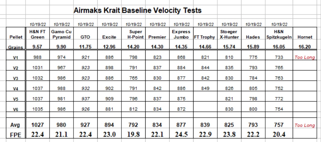

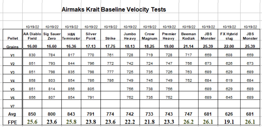

Recently got to check out a new AirMaks Krait from Krale. The reg came set at about 105.
I've attached 2 snapshots of the velocities from 6-shot groups for about 20 kinds of pellets.
No accuracy data was taken. The gun was not cleaned or adjusted in any way before the pellets were shot over a chrony.
Some pellets were shot only few seconds apart, others about 10 seconds apart. No watching for regulator creep just velocities. Just wanted to know how it was set up right out of the box.

Pretty impressive that that little thing can throw down the JSB Monsters at close to 700 fps. Hope you can follow up with an accuracy test.

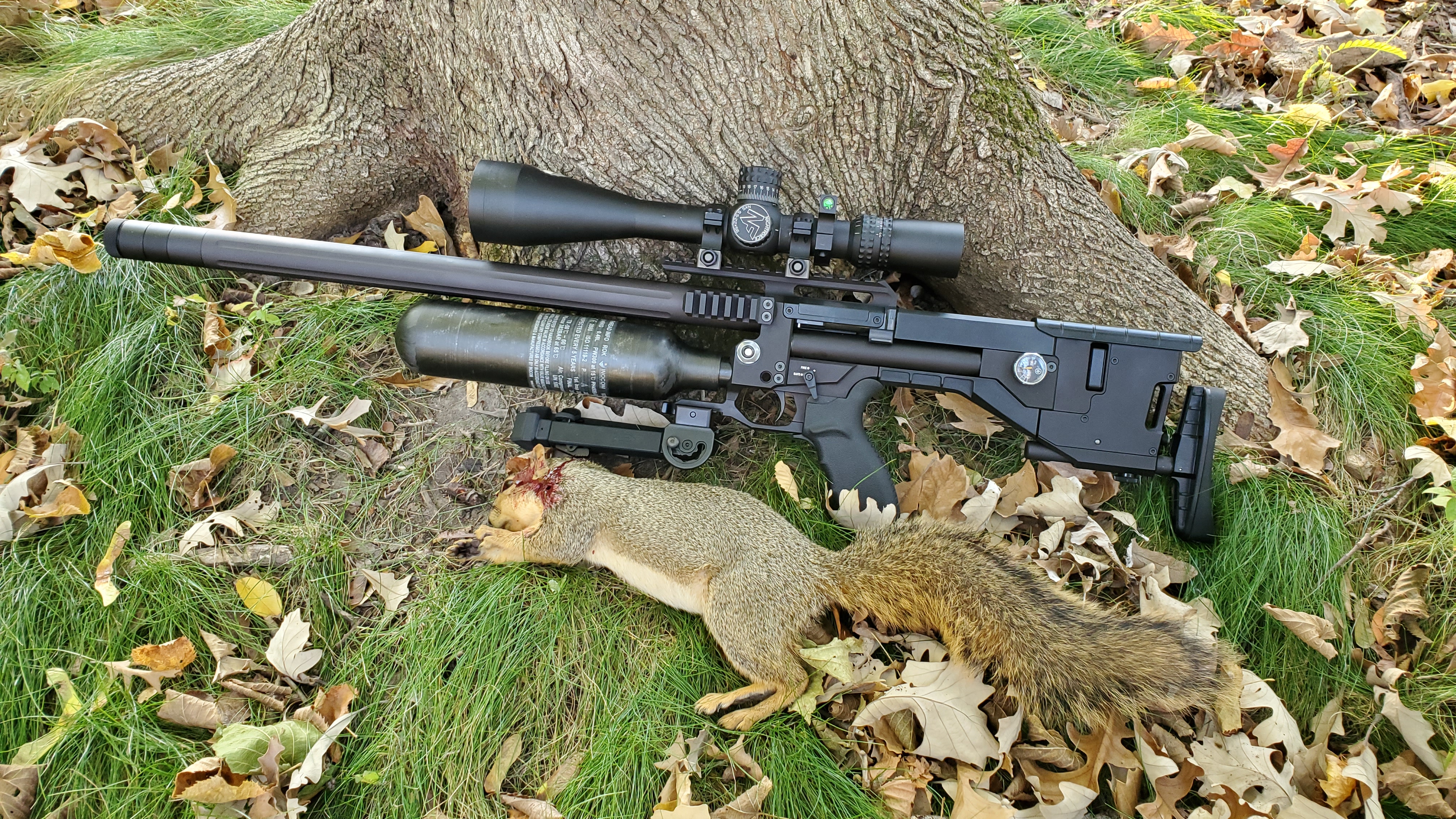

Review is live. I gave it an 8/10. My review is pretty long-winded, I know, but I feel it contains a lot of useful information for anyone thinking about purchasing one. I included a lot of details about the V1 versus the V2 reg and how Airmaks handled the issue. Shooting at 50 and 100 yards.

Well there is probably a snowball fight going on right now in hell because I watched an airgun review. You left a lot on the table to be giving the gun a legit rating but it was nice to hear your thoughts on the out of the box gun. Nice to know it has a degassing screw. I was debating pulling the reg before I even shoot my gun when it gets here to clean it up. Your video confirmed that I will.

That’s a nice foxy. I commend you for giving all of us paid in full guys waiting for their guns a heads up about the crap reg. You saved a lot of temper tantrums from angry customers directed at some poor soul at UA. We have been enlightened. I already informed them to not bother shipping my gun unless it has a silver reg.
