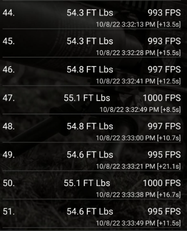

My buddy Ed is saying he is getting these reading with the new reg and JSB Redesigns:
He is saying that he is at 115 bar. Seems crazy low. Way more consistent with pellets than my gun is with slugs. Perhaps I need to go down from ~135ish and try to get a tune starting around 115.
My review was basically out of the box. All I did was bump the reg from the stock setting of 125 up to 135ish and I turned in my hammer screw slightly (1/8 turn). The reason I did that was because when I was fooling around with the previous "V1" reg, I was able to achieve this string (.217 24.8gr NSA slugs) with those settings (while bottle was at like 220 bar only). Despite this fantastic SD, the groups were the same as in my video with the V2 reg.
I would love to see some tuning info once others get their guns. I feel like I should have gotten way better groups than I did in my review with that CZ barrel. Also hoping to figure out how to get the consistency back and not have random 30+ fps swings.

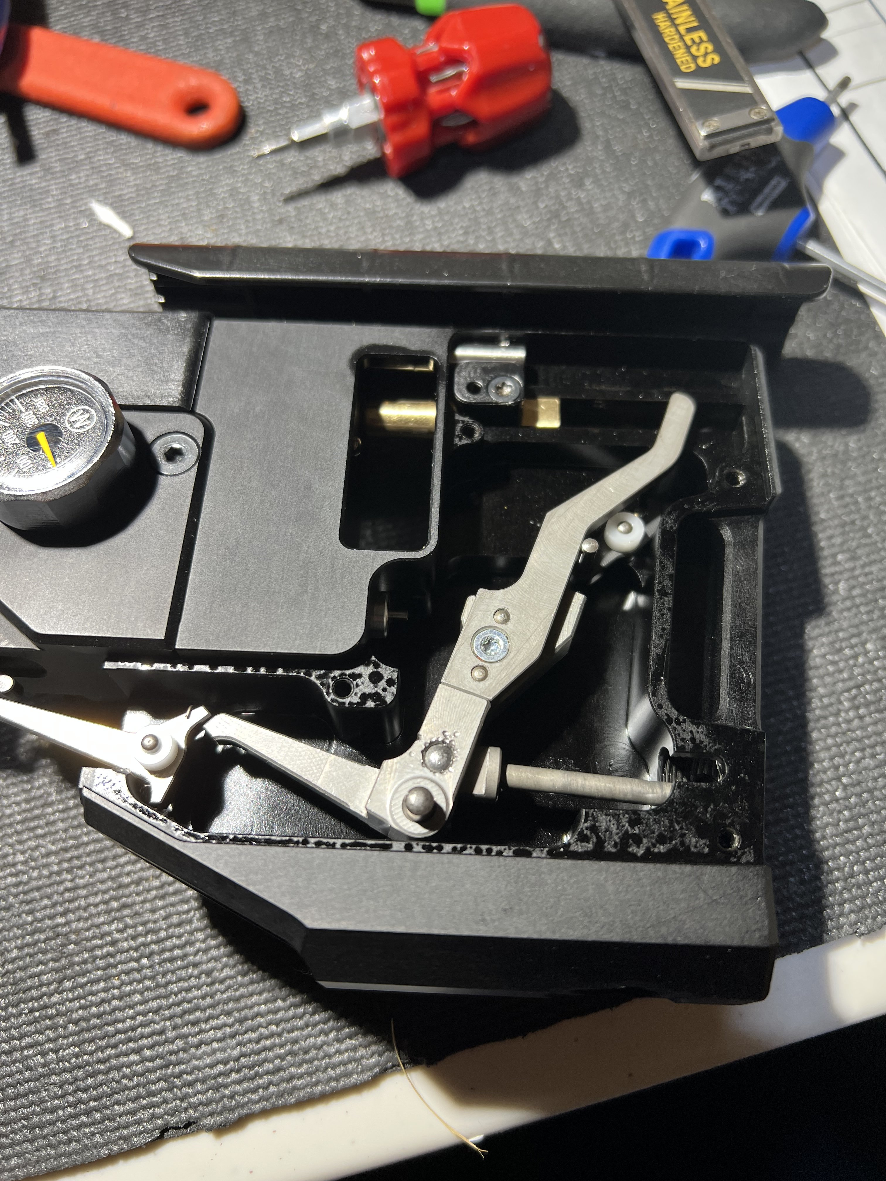

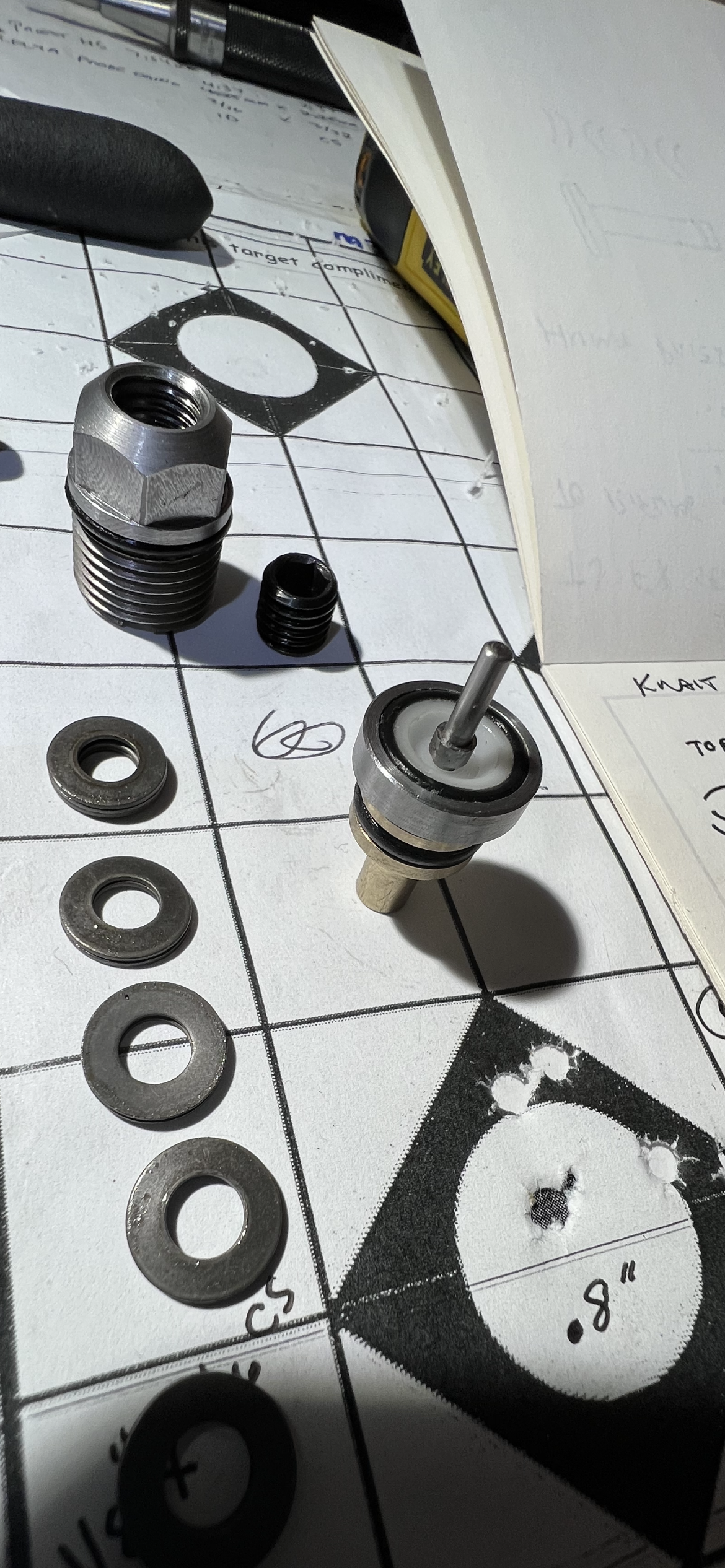

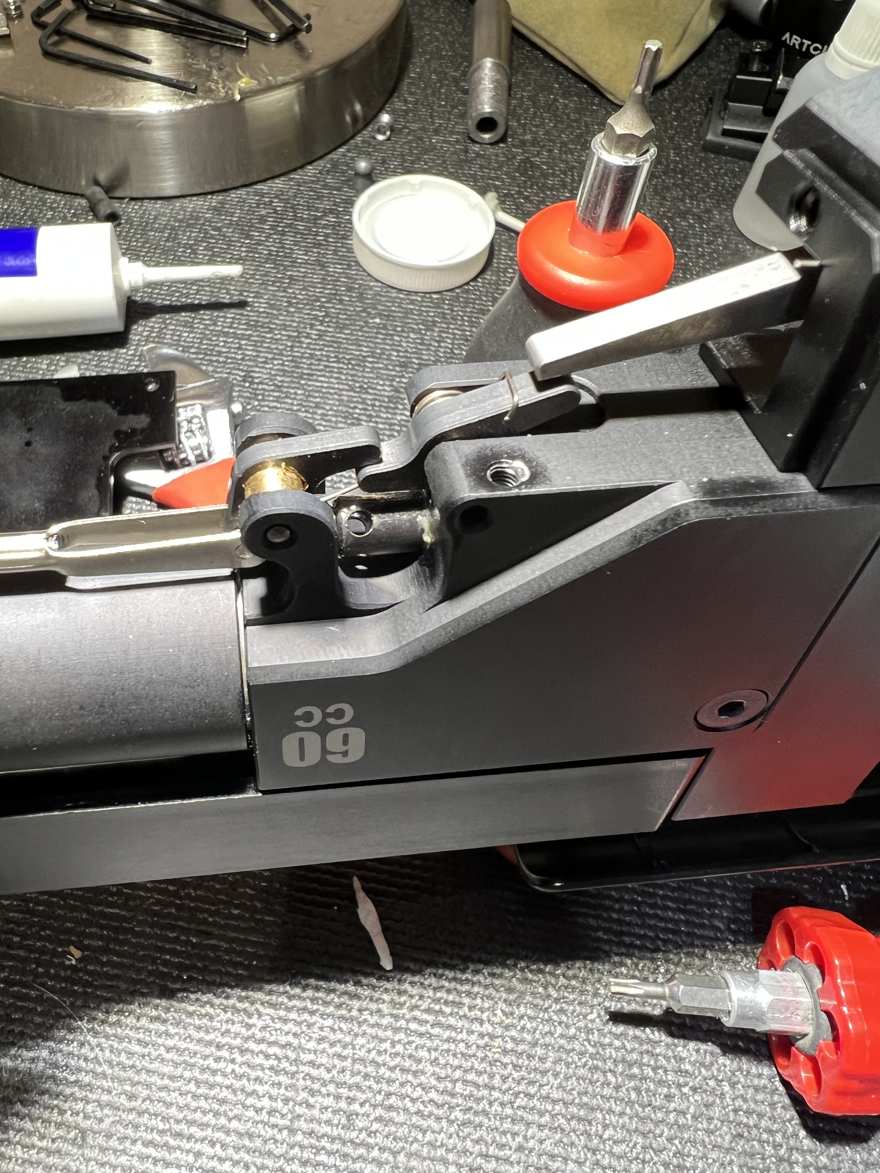

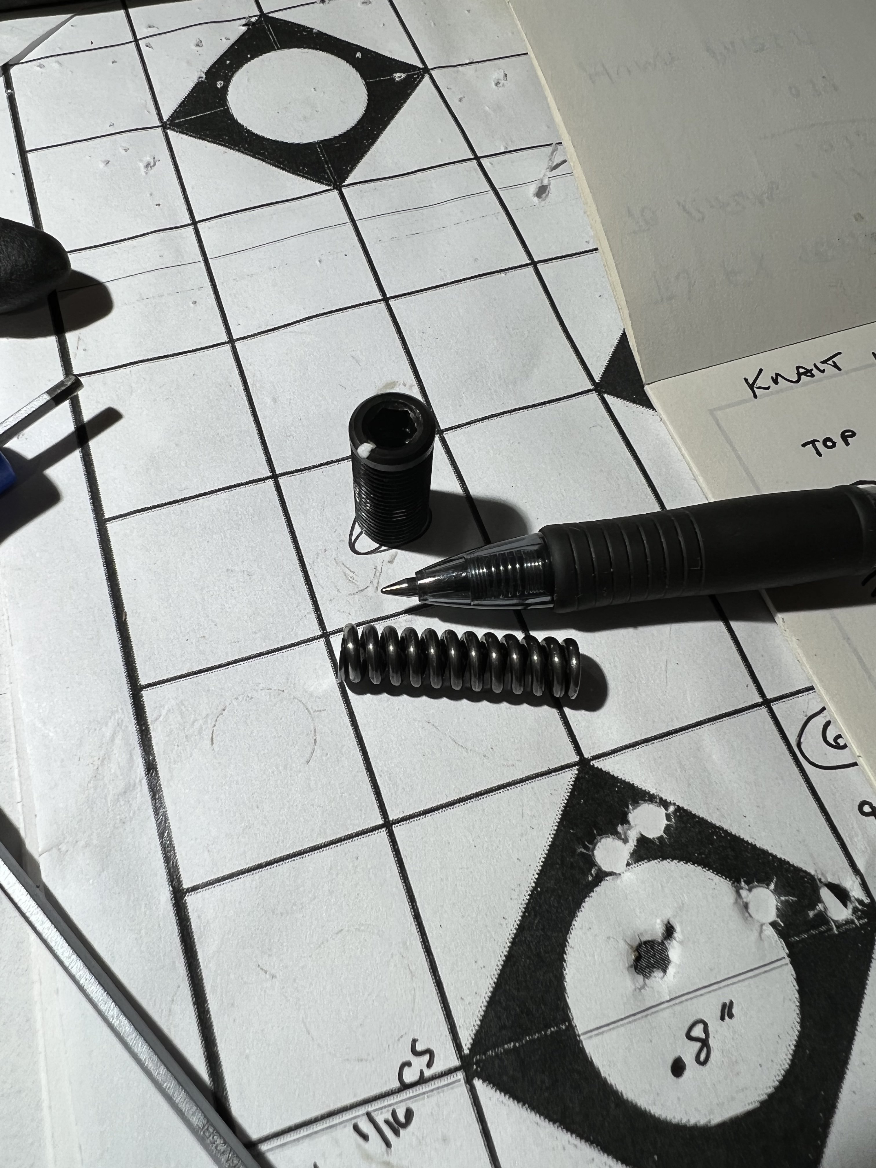

Warren, I experienced some things somewhat similar to what you were experiencing. Once I got everything apart I was able to understand their adjustable up and down under pressure reg. Its smart but I’m surprised they get it to hold as good as it does. Pretty cool concept though. I think the only approach we all have is time. Just keep shooting the gun and if the set point wanders, adjust it. Hopefully it will eventually seat and be stable. At least in my case with my creeper. Just a shame you have to burn so much lead. That’s why I took it apart to see if I could just do my own peek seat, get it to seat and be done with it. Not happening with this thing. Breaking things in is so 20th century. I can’t stand it. But I do understand mass production. Here are some pics and the last one could be something important.
And this could be the kicker and the cure. This could be, and if I have enough gas left in my tank, I’ll find out tonight, the valve adjuster. If it is, then just like any other gun that has this feature, if you mess with your reg pressure you have to mess with the valve because you changed your hammer strike. If it’s not, then I don’t know what the hell it is.
Reactions: qball
AirMaks is sorta known for its outta the box thinking on its trigger mechanisms . And the machining of the parts pictured below looks good, smooth, the mill cutters all going in the direction of travel during the trigger pull actuation...all good...
BUT - In this photo, the "lock" peening of the pin in the lower part of the picture is high school quality !? Someone needs to have the back of their hand punched with an automatic center punch !

Here is where I’m at right now and it’s not good. That thing with the holes in it has to be a valve adjuster. I can hear the spring behind it as I turn it in. It did nothing. Here is my guns problem. No matter where I tune it or at any usable reg pressure, the guns velocities follow the tank pressure. At 130, 140 and 150b, when the tank pressure gets to around 210b, the gun becomes a hot rod. I never filled the gun above 260b. I thought ok, I just set the gun on the plateau and see just how bad my descending shot string is. Not happening. My plateau speed with my hammer spring is 870fps with 260b in the tank. My plateau speed becomes 940fps if I set it with 200b in the tank. So basically this gun is shooting under partial valve lock until I get to 210b in the tank. Unless there is some Airmaks way to tune these guns, mine is going back. I’m actually sitting here in disbelief that something that’s $1,700 has these old school regulated pcp symptoms. Hoping I just inhaled too many fumes of some sort today and I’m missing something.
I would like to add that there is no way Utah could have been aware of this. They filled the gun to maybe 180-200b, set the reg and HS for 880fps, shot their little group at 10 yards and called it good. They would have had to fill the gun and do a 50 pellet shot string to see how whacked the gun is.
