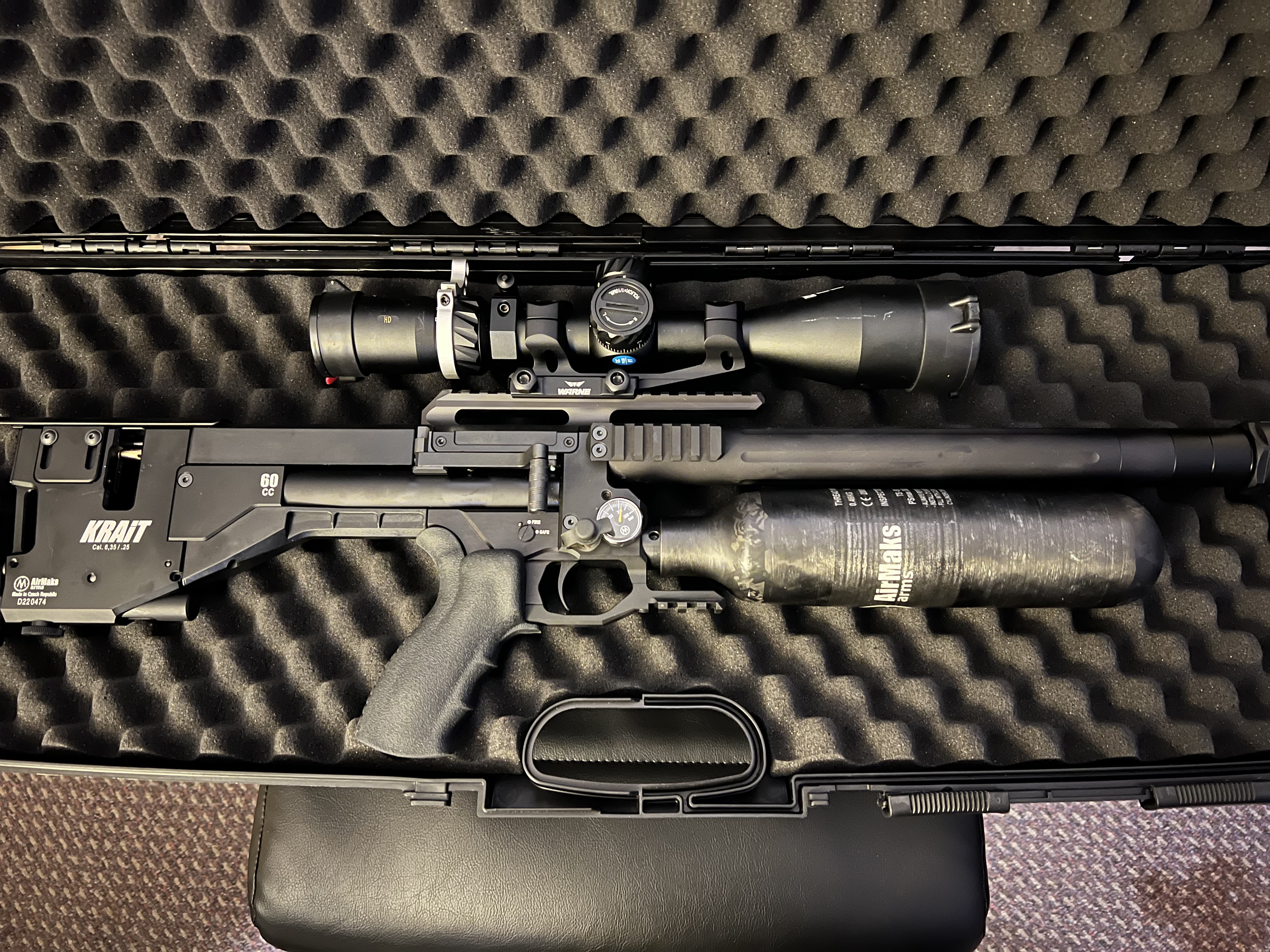

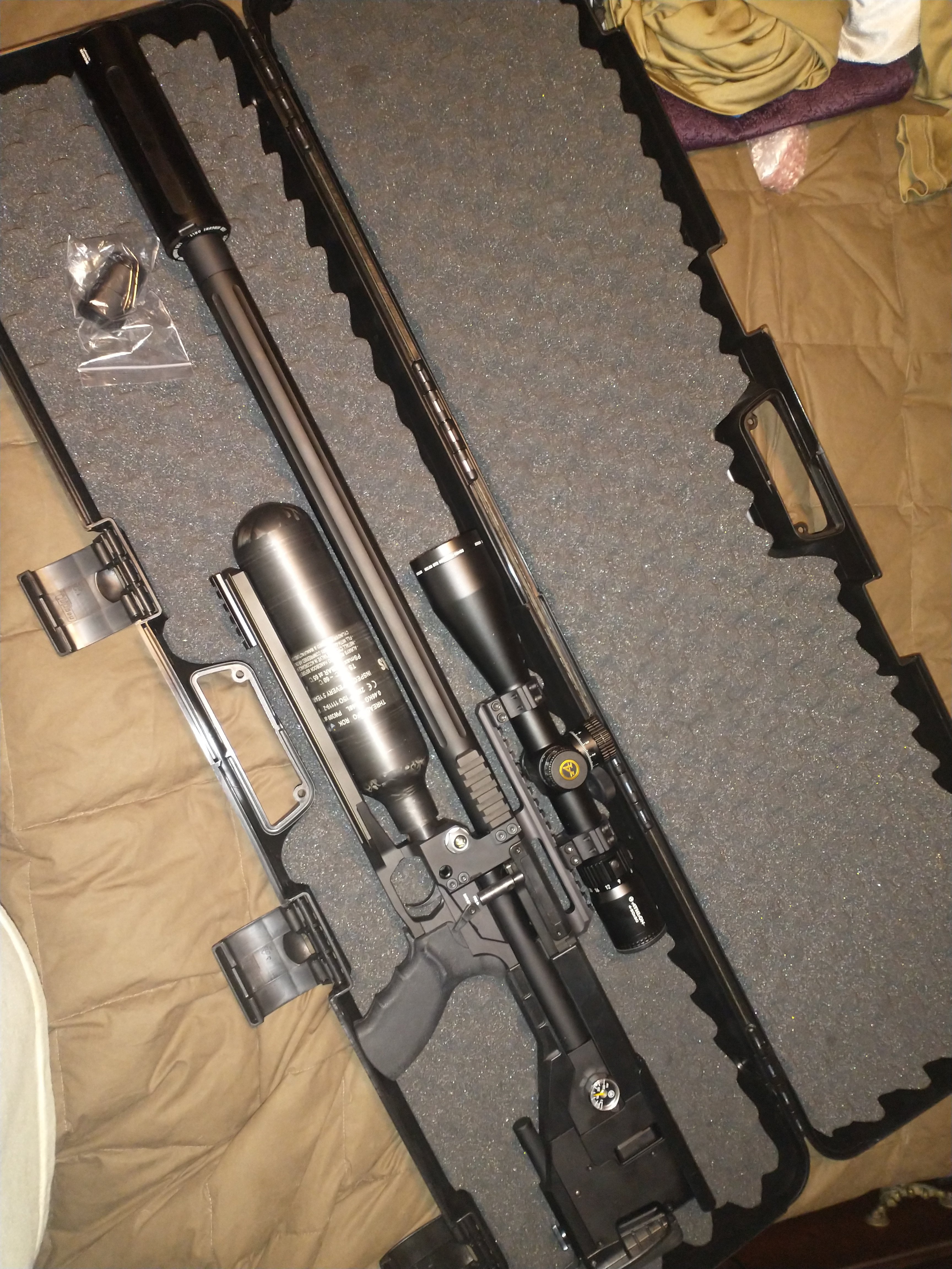

My other gripe, with scope it doesn't fit in the case that it came with, unlike the Krait and KraitL...
Nah, just aired it up, charged my bottles, pulled a few spacers of the end of the barrel to shorten the assembly with the moderator, and mounted the scope. Still need to remove the anti double feed mechanism... Verified with AirMaks that it has the V2 regulator, hoping to get a few shot strings in this week with a Magnetospeed.
