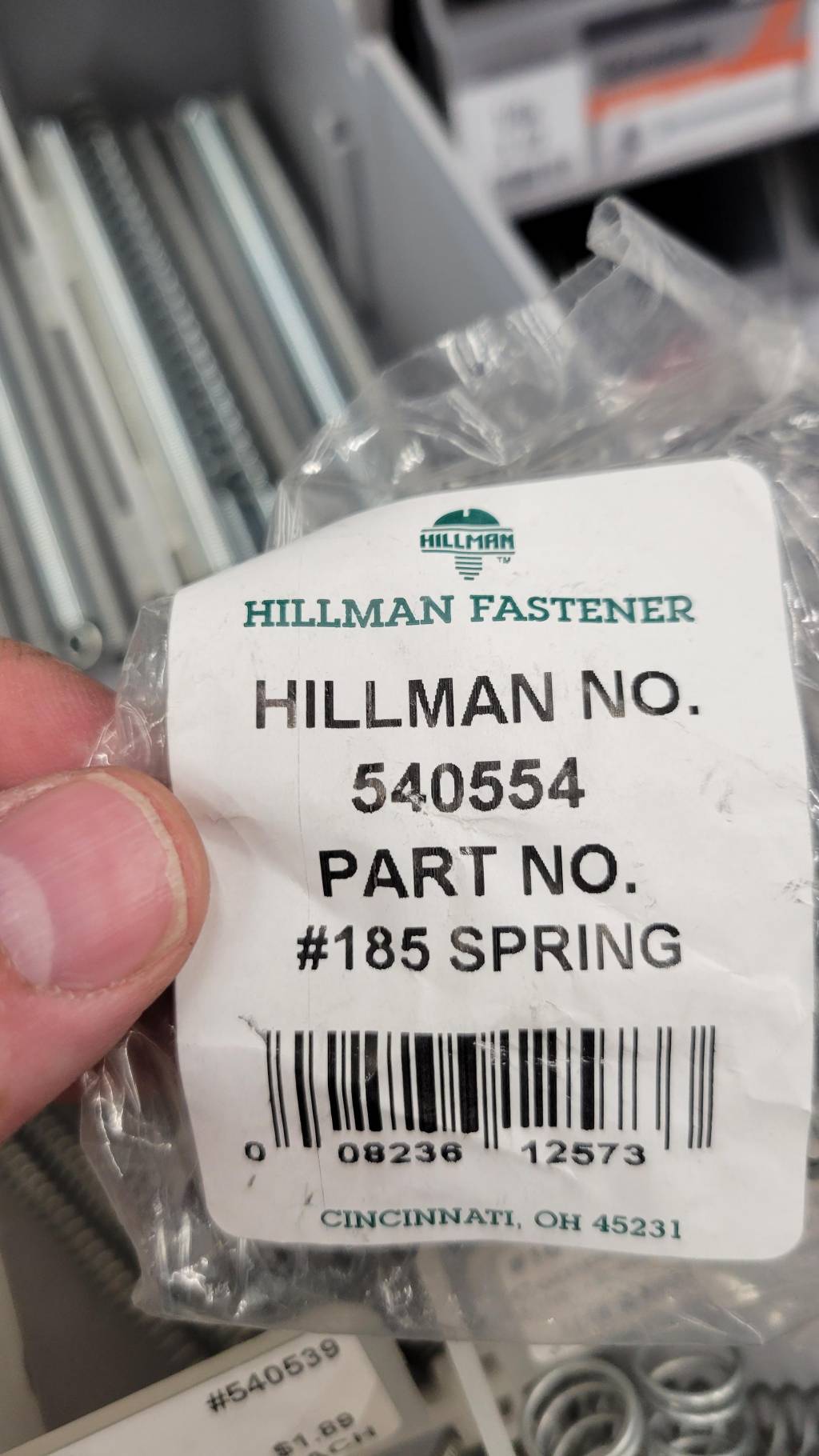

I am in the process of de-tuning my .177 DAR Gen 2.
So far I have replaced the hammer spring with a lighter one that I got from my local hardware store, that I had to trim down.
I really didn't want to crack into the air tube and void my warranty, but to get the best performance it will need to be done, because the reg is set way too high.
Mine falls off the reg at around 2000psi (14mpa).
With the lighter and shorter spring I was able to get the power down to the 14.5-15 ftlbs with 8.5 and 10.5gr pellets. And get around 70 shots on the reg before velocity starts climbing and then drops again. Hence the too high reg pressure.
Once I get the reg set to where I want it, thus gun should get around 150 shots per fill on the reg.
I will continue to update as I go.
Hope this helps.
This is the new hammer spring that I installed.
I cut it to 1.5"

Thanks for the information! I still haven't voided my warranty by adjusting the reg, but as you noted, it is a necessity. I am not going to replace the hammer spring until after I adjust the reg.
