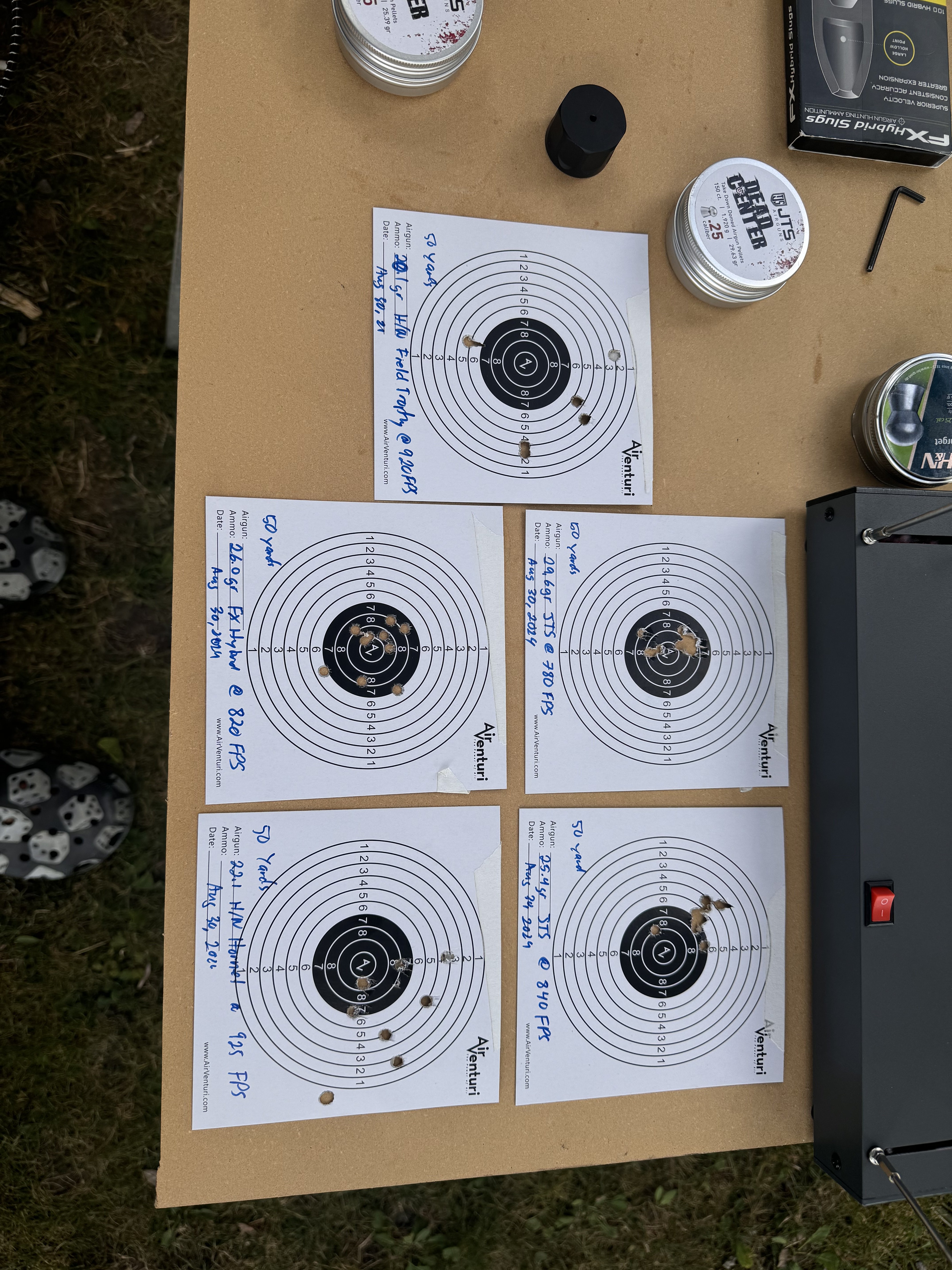

These are mine at 50 yards. 25 cal though.
Horrible.
