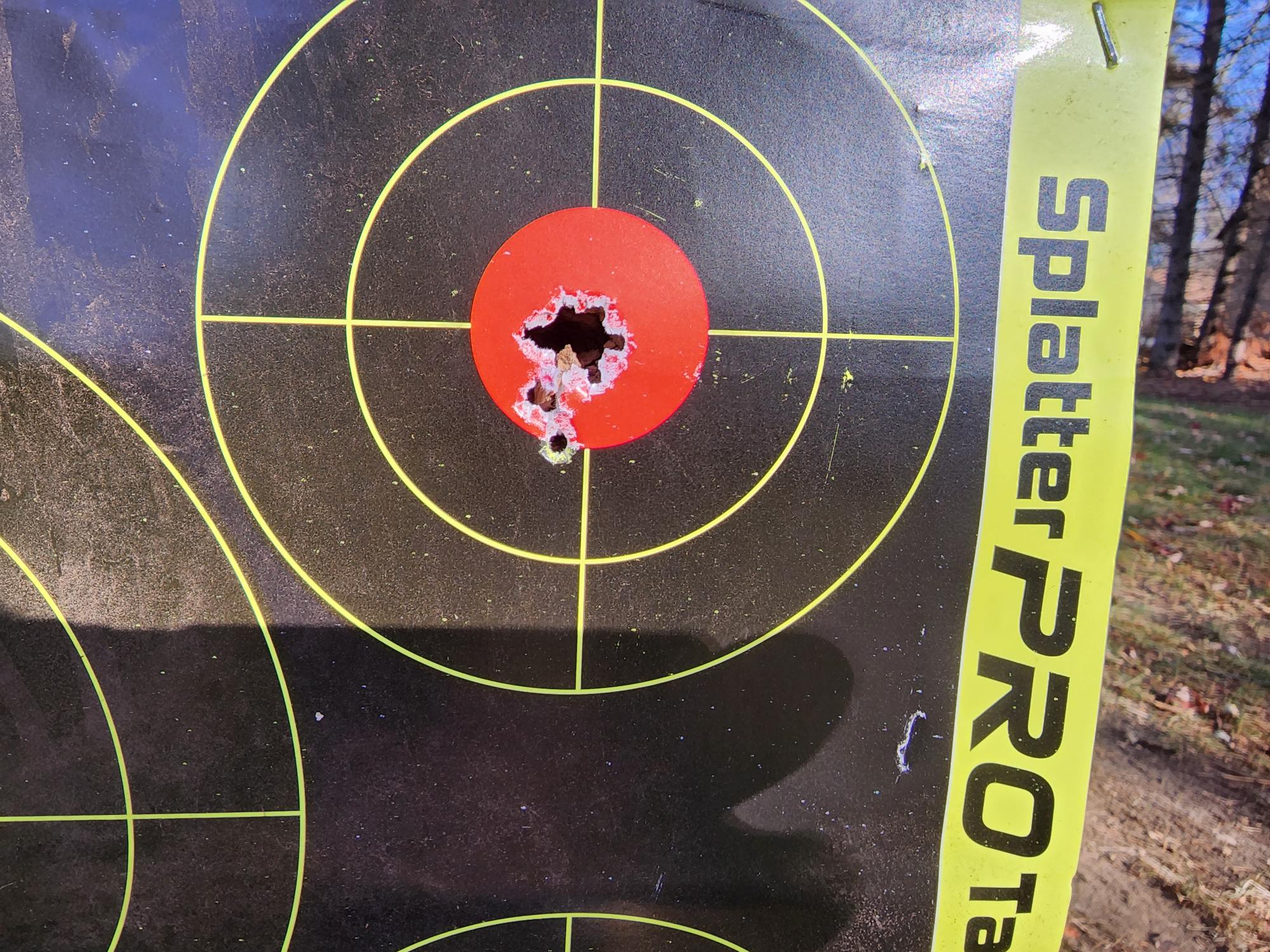

I have polygonal barrels on both my Taipans - .22 compact and .25 standard. Both are tack drivers. pic is 20 shots at 75yrds with my .25. 50gr AVS HP/BTs @ 930fps - 96fpe. fell off my reg. there at the end of that string.
