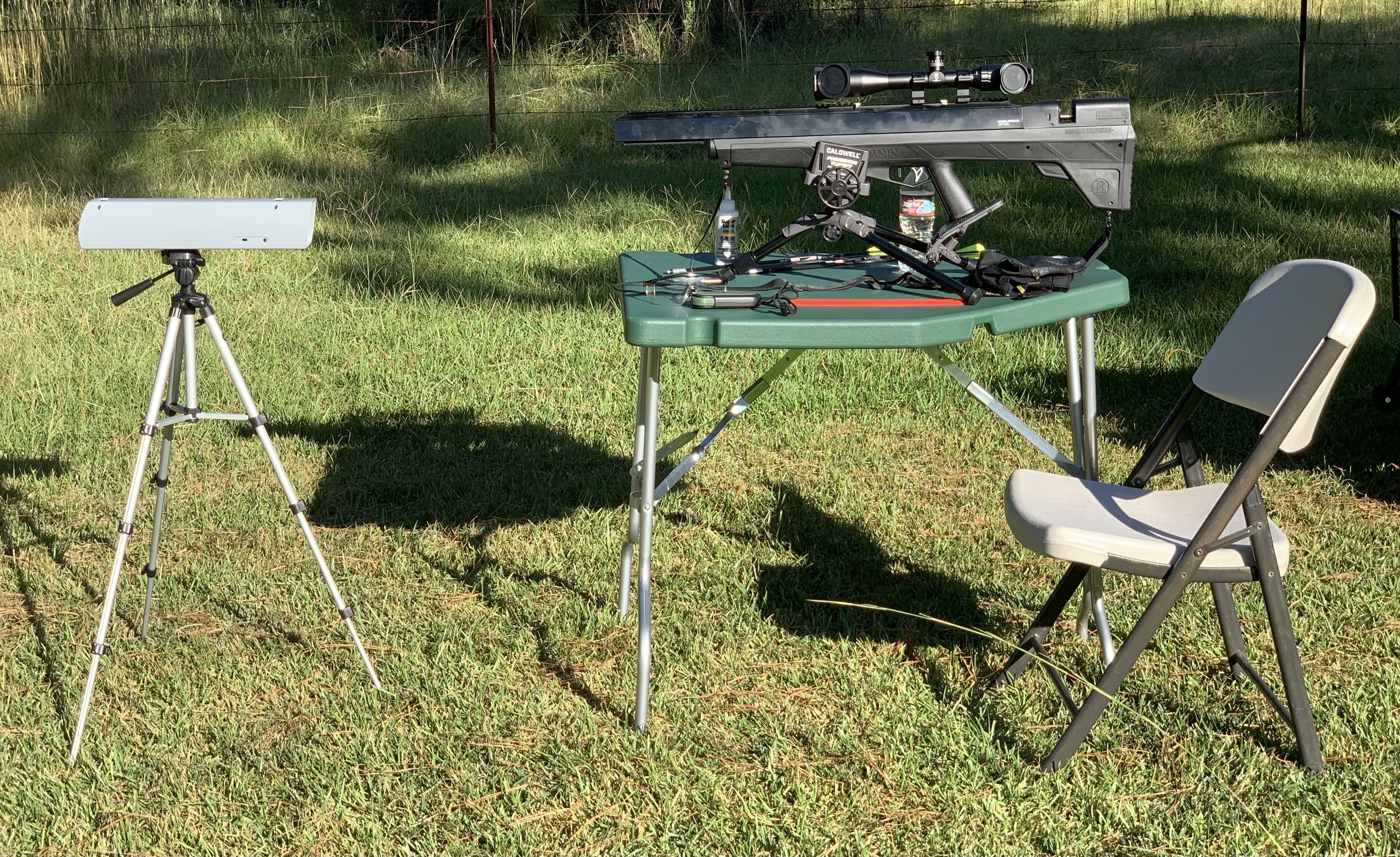

I have the ProChrono, the FX pocket, and the cheap Chinese one. To me, the FX is easiest/quickest to use. I wouldn't rule it out because you shoot a springer. You can use it with a small tripod. The Pro Chrono DLX is nice, but more setup is required. I have the optional light kit and it works very well on overcast days, BUT I shoot from a covered deck and have nearby access to electricity to power the light kit. The Chinese one is cheap and accurate, but attachment/setup will require some pre-planning and possibly some crude fabrication to shoot through it.
the fx chrono has been conpletely reliable for me.
ive had alot of chronos,
ALL were a pain to setup and use.
then i got the fx,
and find myself enjoying running shot strings, because i can plink in any direction i wish while doing so
(i mount it to a side picatinny mount,never the barrels)
instead of being a slave to keeping all my shots directly over the sensors of a regular chrono.
and if a gun doesnt have any free picatinny space,
i can just set it on whatever table/bench/pile of lemurs i am shooting from and it works.

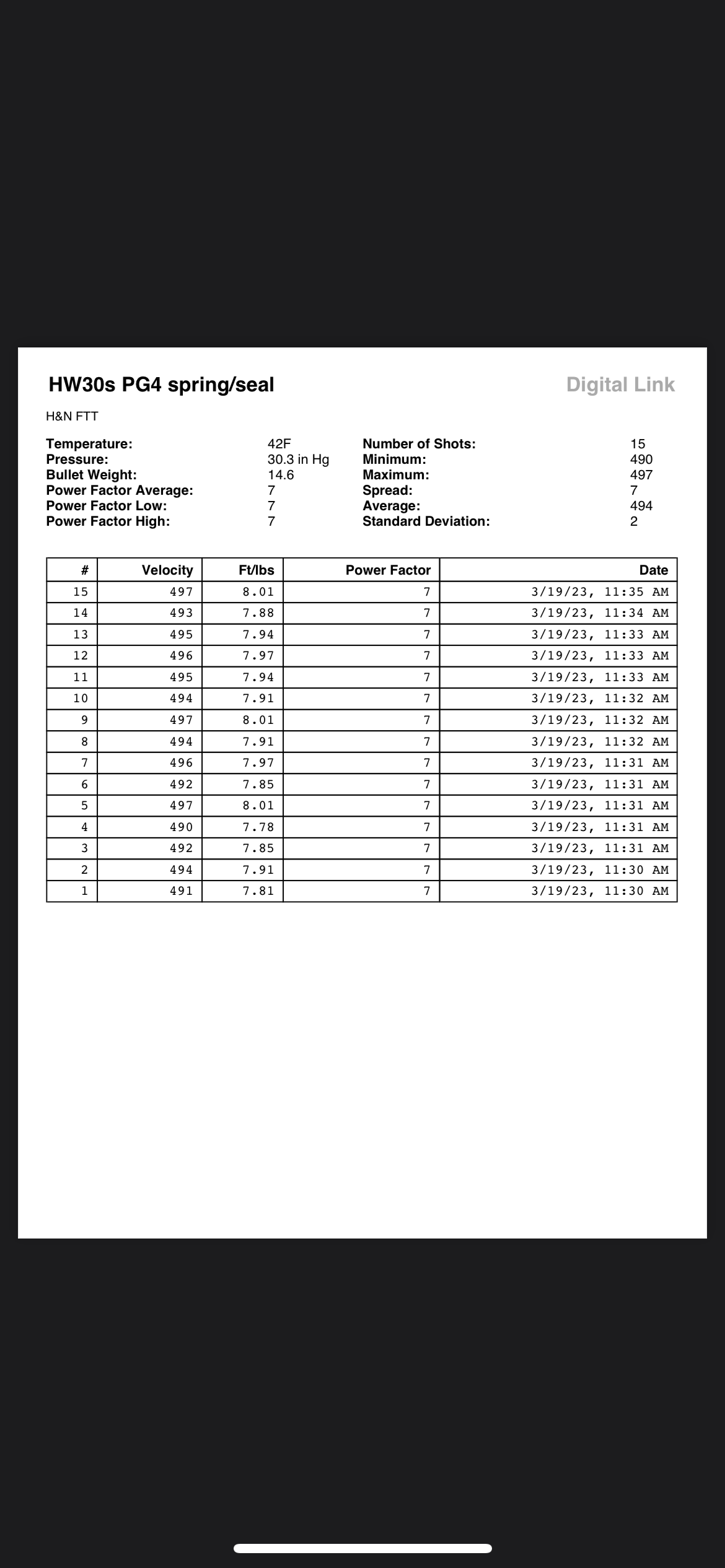

I use the shot chart to see my average fps, and look for that in the string to determine my average fpe. They should give you the average up top with the other figures.
Reactions: Mycapt65
The fpe is displayed for each shot in the shot string. It’s also displayed in its own column on the summary next to the velocity column. An average fpe reading would be nice though. To figure my average fpe for a string is look at the average velocity and find a matching figure within the shot string. That is an easy method of figuring the average fpe.
