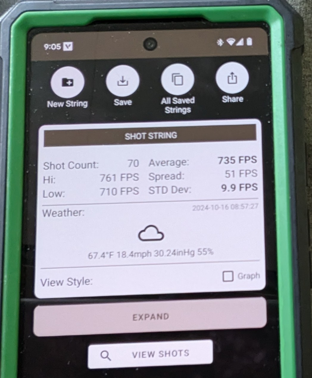

I can get 34 shots at 700fps using 25.4 grain pellets with a spread of 16fps…..why would you want a regulator?
That’s two full mags on one fill.

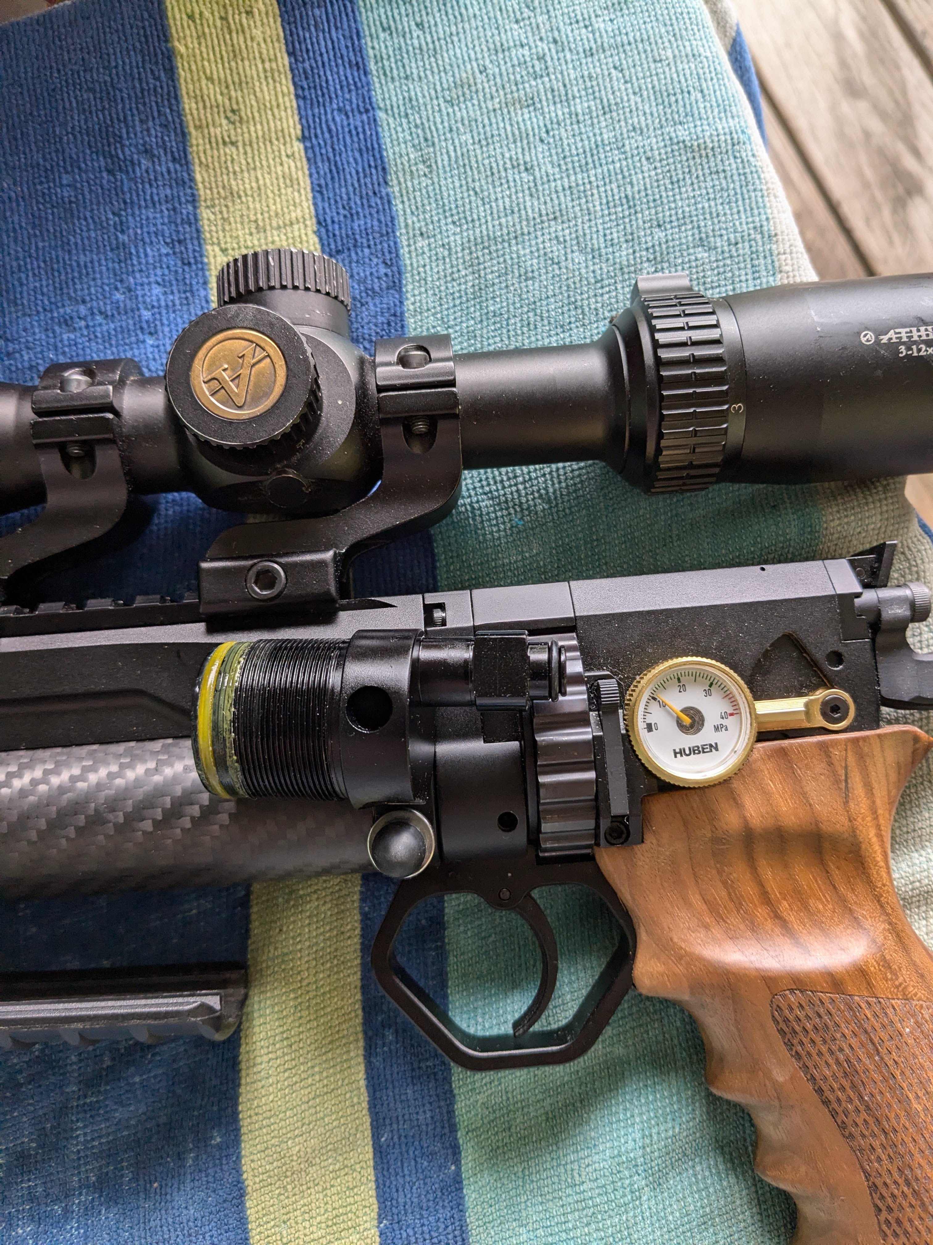

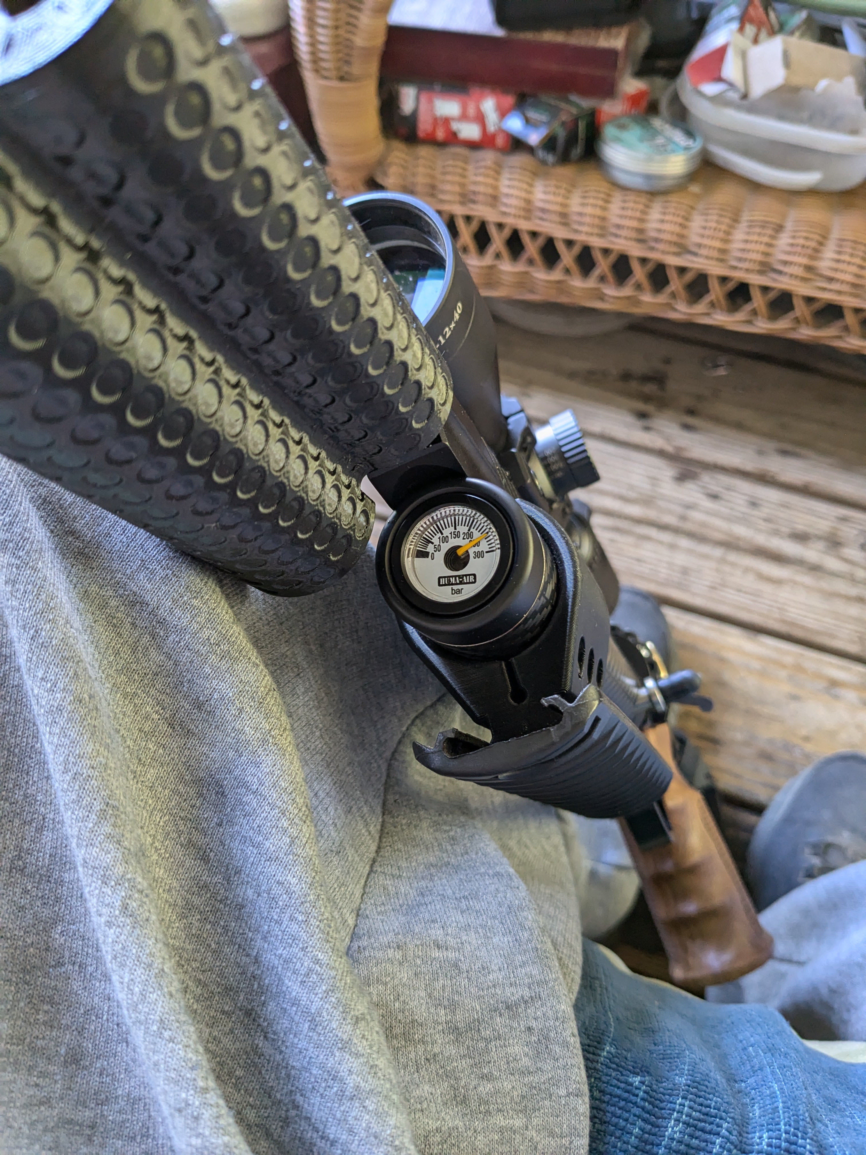

Have one in my gk1 .177 shooting rws 9.3 supermag 640 or there about. Still work in progress.
I was having trouble with cycling when I first installed it. Started the reg set at 100 b it would cycle the striker would stick and it would just drain out lol.
So I run into a video by a guy in UK he managed to get his cycling real good at 125b set point on the reg. That's worked great with mine also. Dropped mine back down to 640fps all I need for the back yard.
